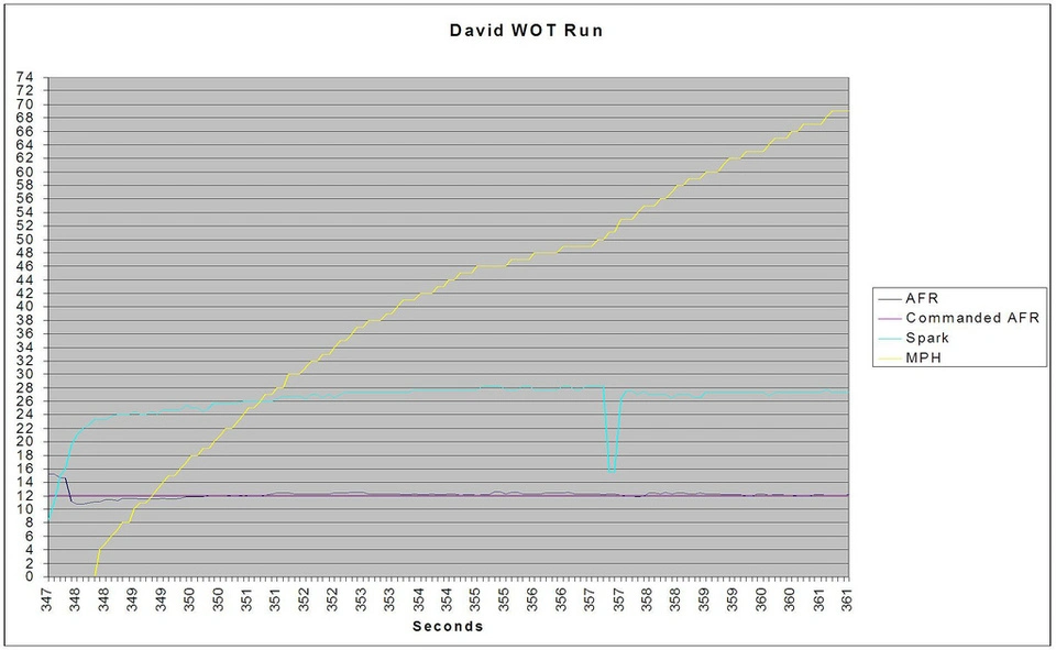

A picture is worth a thousand words, here is one of his WOT runs from the logs he included in the first post.
Wes
