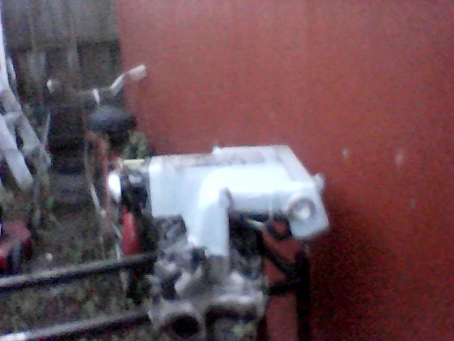

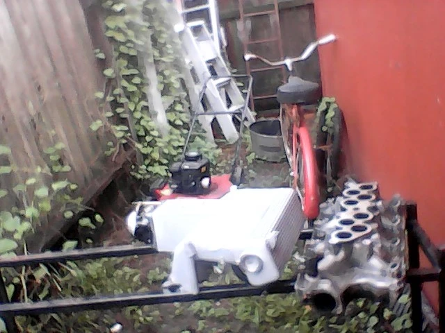

allright went to pick and pay this morning, and got this exployer upper and lower and the 65mm tb of a 96 exployer for $70, goin back tomarro to get the heads, they r true gt40's, not p's ,getting them both for $70 bucks also, not bad for heads and intake for $140, this is how intake came now, im gona clean them up,maybe paint, not gona put everything till I find out everything I need to do, also do I need to put my egr spacer on, and when I,m gona go ahead and put a cam in, don't what kind yet, any suggestion on a good cam that would go good with set up is appreciated,thanks guys for all yalls help,any body in Houston, there is still 3 complete gt40 exployers in the yard, heads and intake,

You will have to use your EGR spacer.
Do you plan on upgrading your valve springs? If not I would use the stock cam with 1.7RRs or a Steeda #18 as it only has .480 lift with 1.6RRs.
If do upgrade the valve springs you can go with something more aggressive.
yes for sure I already found that out, probably get some comp springs,i wana go with a cam other than a alfabet 303
