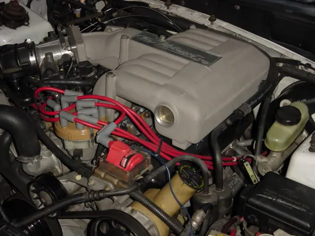

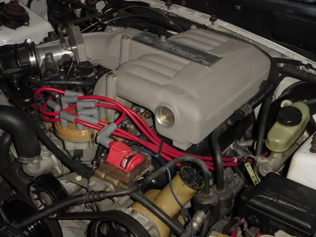

So yesterday I put plugs, wires, cap and rotor on. I bought some ford racing wires(red) for the stang. However there is one left and I cannot figure out where it goes. Any ideas? It is about 9-10inches long and one end has a bigger copper center in it. The stang is running fine, but I can't figure what it goes to.:bang:

It's the coil wire for older 302s with the coil bolted on the intake manifold, on the passanger side. You don't use it in an EFI Mustang.
Wrong (kinda) the shorter coil wire is for the 94/95 coil which sits right above the power steering pump. Foxes coil is near the drive strut tower...
