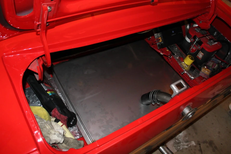

Here are some pictures of what I have done so far:

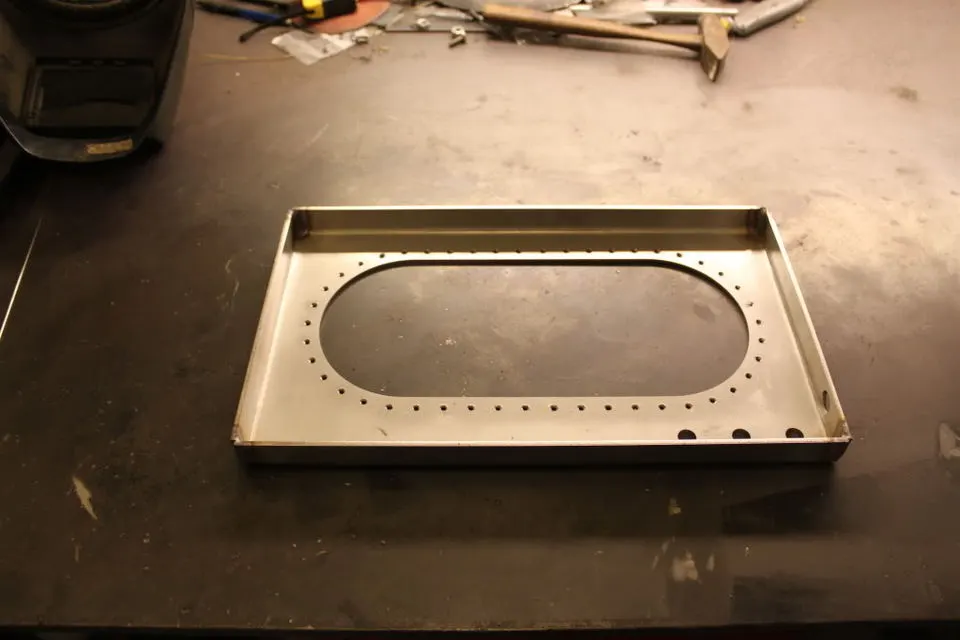

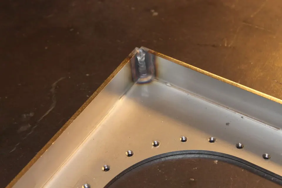

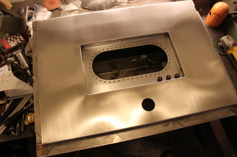

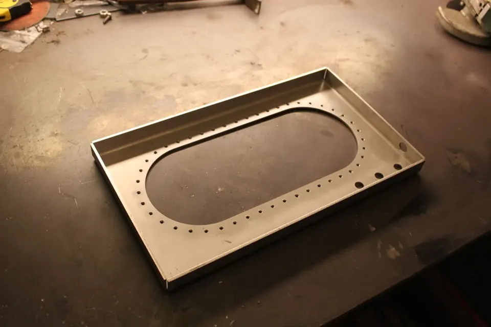

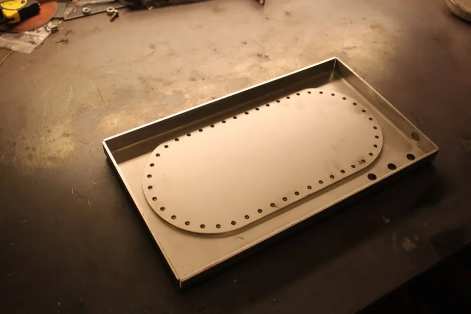

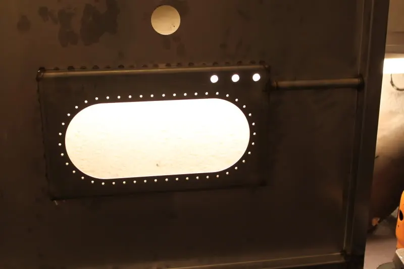

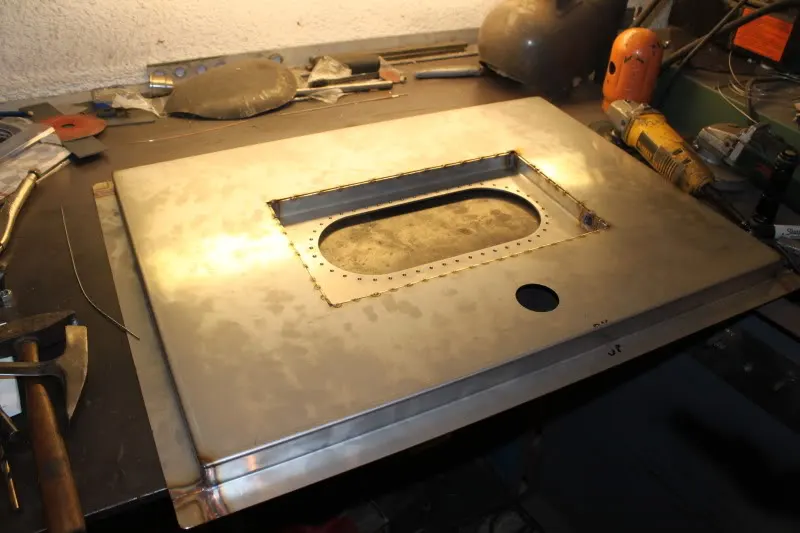

This piece will be a recess welded into the top of the tank for access to everything inside and the wiring will bulk head through here also. The reason for the recess is on the old mustangs the top of the tank is also part of the trunk floor. There will eventually be a cover over this so it is all hidden and protected.

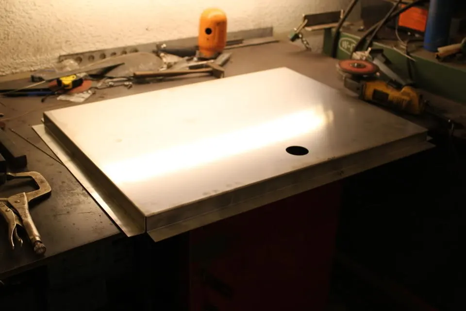

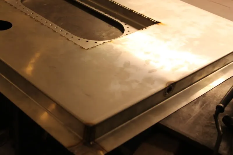

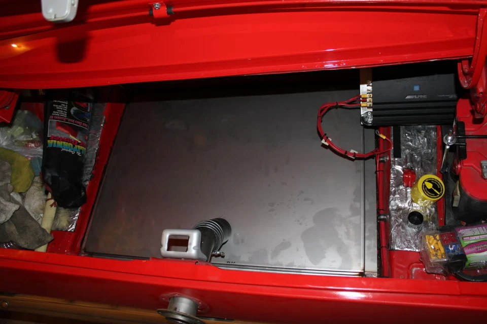

This will be the top of the tank and the trunk floor. It is raised 1 1/2" from stock to increase fuel capacity.

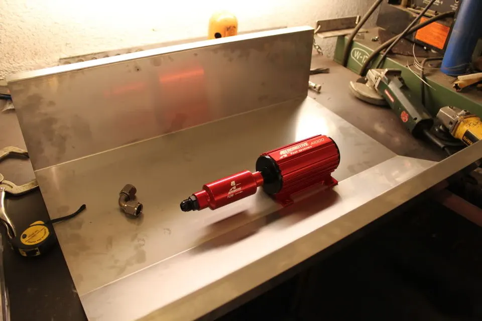

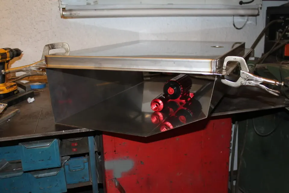

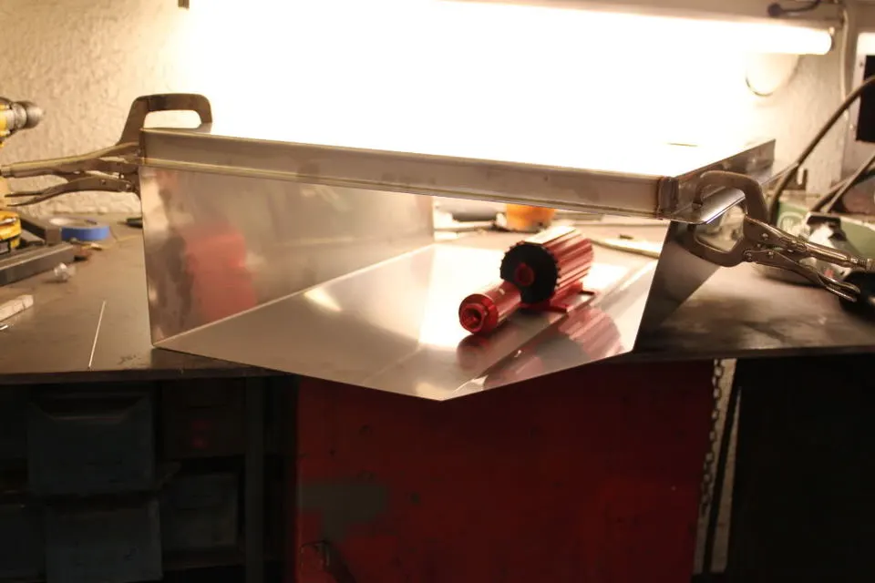

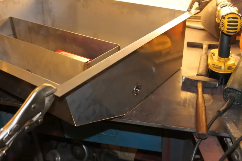

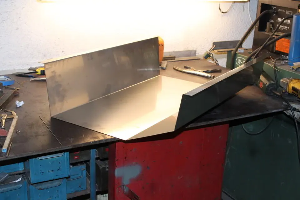

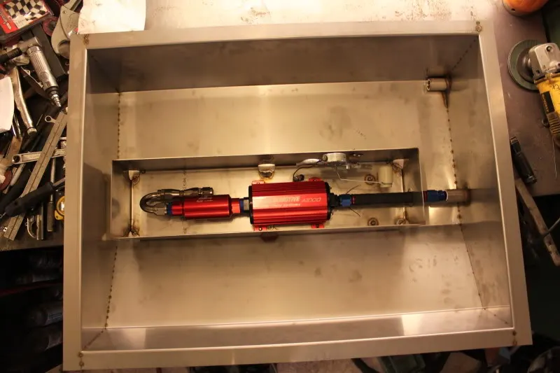

This is the main body of the tank. It is 1 1/2" deeper than stock to add capacity.

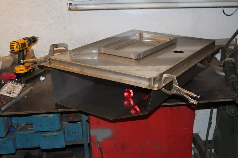

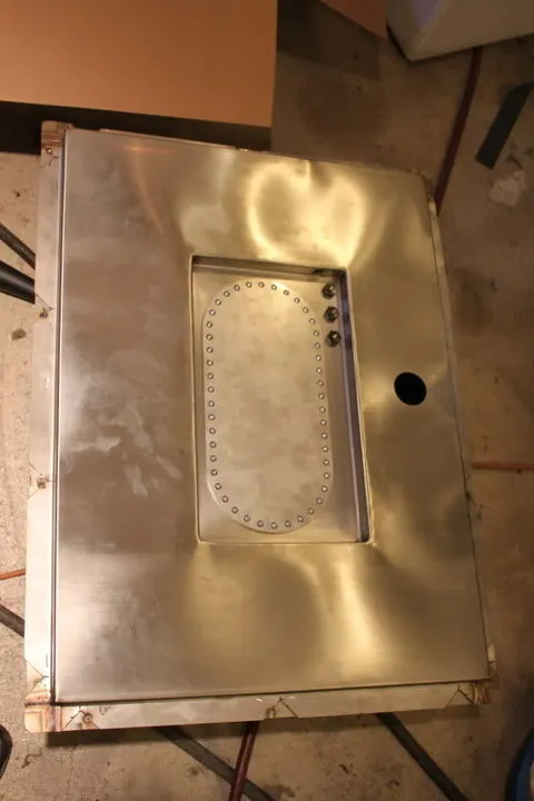

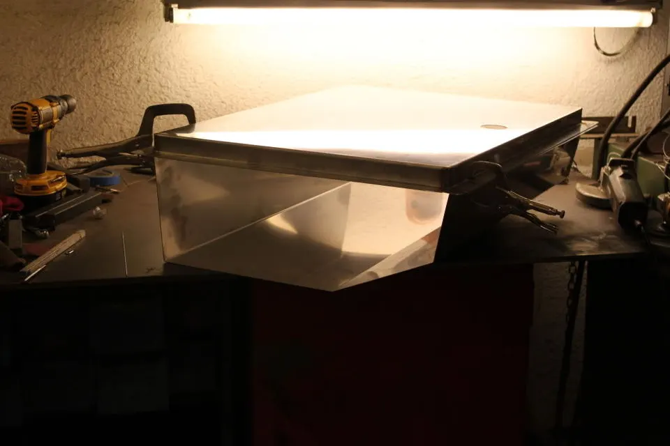

Here is basically what it will look like once assembled. Like I mentioned the piece sitting on top will be cut in and recessed down.

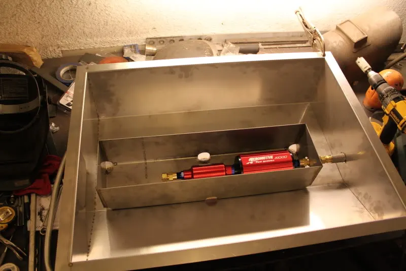

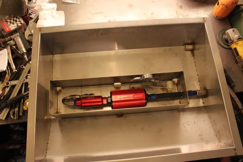

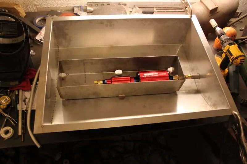

The pump will mount inside of a "baffle pan" I am going to build this week. There will be quite a bit of internal baffling to keep the sloshing to a minimum.
The supply and return lines will be internally plumbed to ports that will exit on the passenger side of the tank. With the top being in the trunk I did not want the connections coming out of the top.

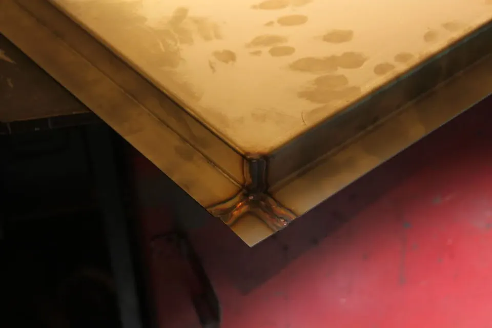

When all of the welding is done it will get either a brushed finish or painted, not sure on that yet..
co6b5ra,

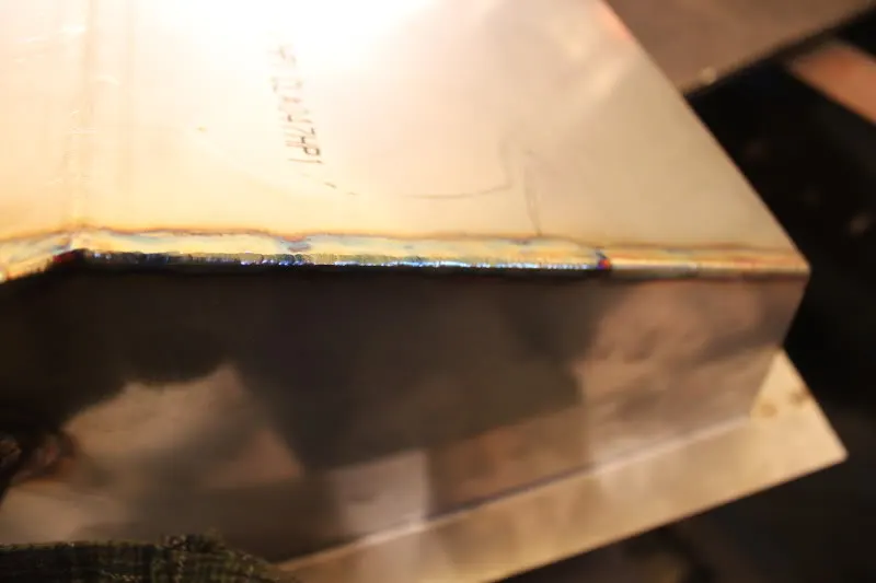

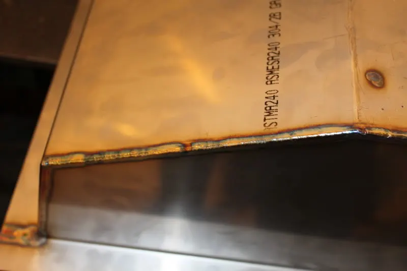

You said: "The whole thing is stainless steel so it will nver rust." Be careful to not be fooled by it being "stainless steel", it may not "rust" per-se, but it will corrode, especially at/near the welds where the metallurgy of the stainless has been compromised by the heat of the welding. What is the material of the welding wire/rod you are using? A proper inner coating over a properly prepared surface wouldn't hurt. With all that said, you will likely not see any problem as soon as you would with a standard steel tank. By the way, nice work and planning.:nice:
My $.02,
Gene
co6b5ra,
My $.02,
Gene
I have been building stainless steel tanks and equipment for many industries including many chemical palnts and food applications for 15 years. I am well aware of the possibility of carbonizing. Typically this issue come up more ofter whem the metal is welded to hot, however it can arise from other circumstances. I am TIG welding this entire tank with 308L filler rod and the tank itself is 304L. After the tank is welded I am having it passivated which will remove any cabonizing caused by the welding heat. I have done many tanks without passavating (most food applications are not passivated, just polished to remove surface contamination)and never had a problem, however in some chemical applications I have had mild "corrosion" issues come up hence why I am going to go ahead and passivate this tank. :flag:

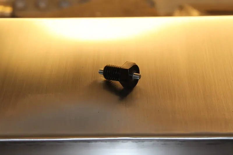

I could not find an electrical bulkhead I liked so I decided to make my own. Just took some 1/2" plastic bolts, drilled and tapped them to 10-32, and inserted a 10-32 stud.
Finished up the inside of the tank. Added the return port and got the sending unit mounted.
Welded up most of the outside seams.
Got the top all tacked on and ran out of argon for the welder so here is how she sits untill Monday when I can get some more argon.
