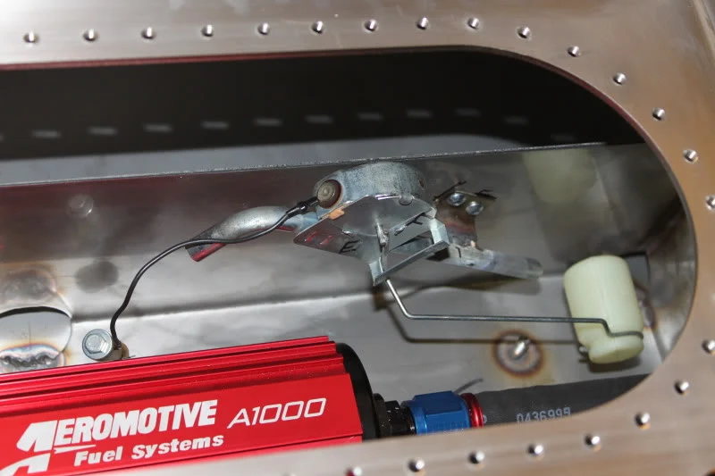

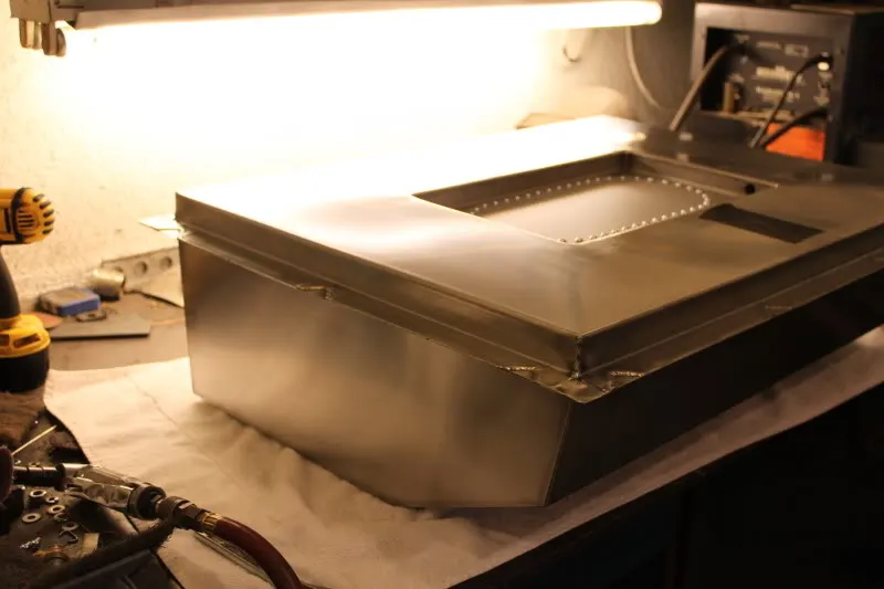

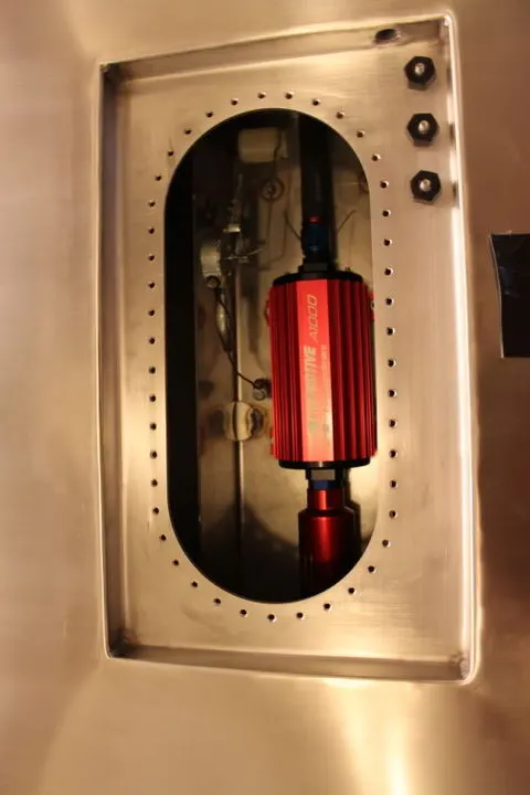

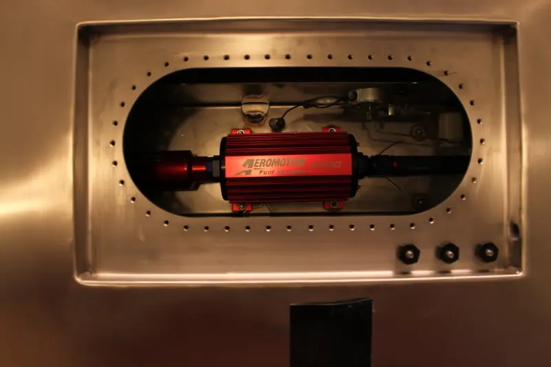

Have not put any pics up lately so here we go:

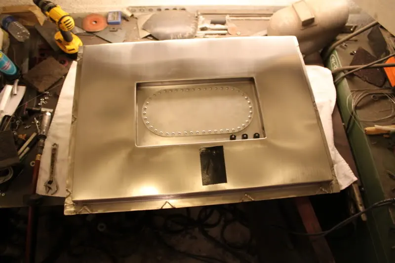

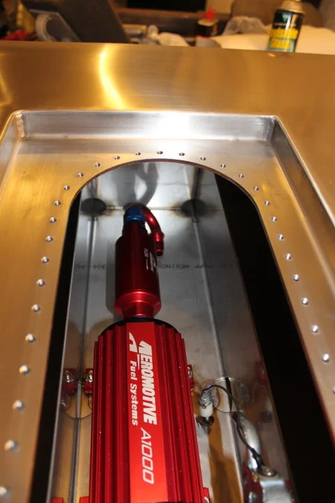

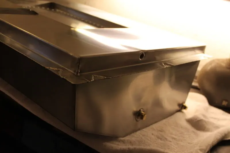

Got it pretty much finished up just gotta do the filler neck, gasket for the top, and wire it up. Anyways here it is welded and pretty much cleaned up.

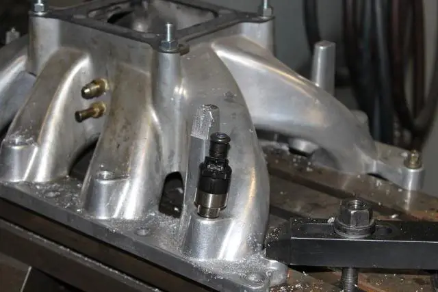

Made some good progress today. Started working on the manifold and got it about 95% converted to efi.

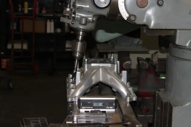

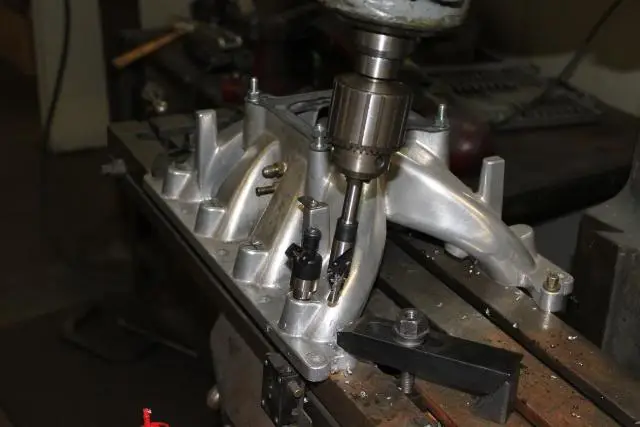

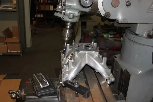

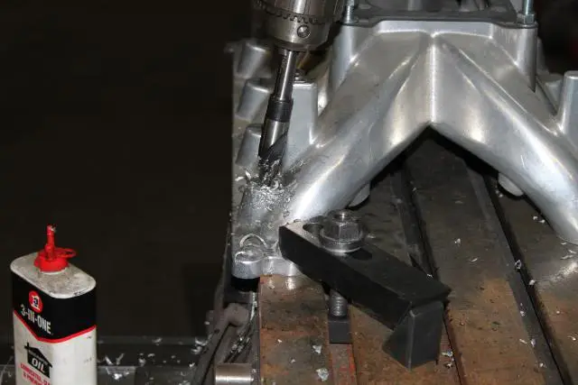

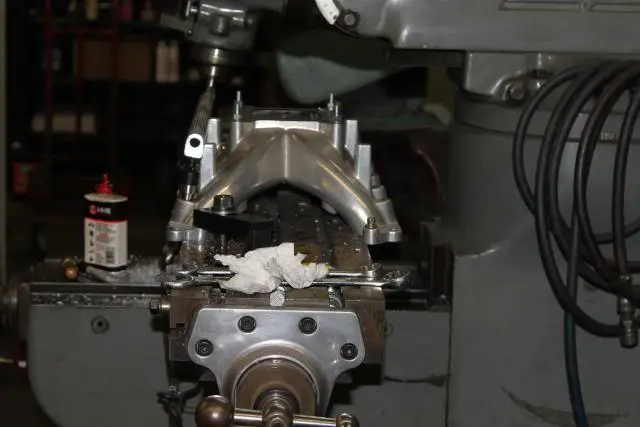

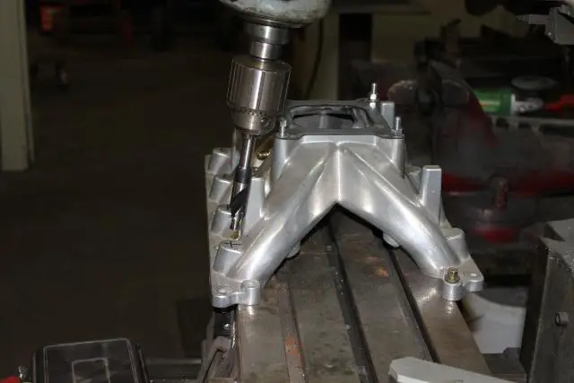

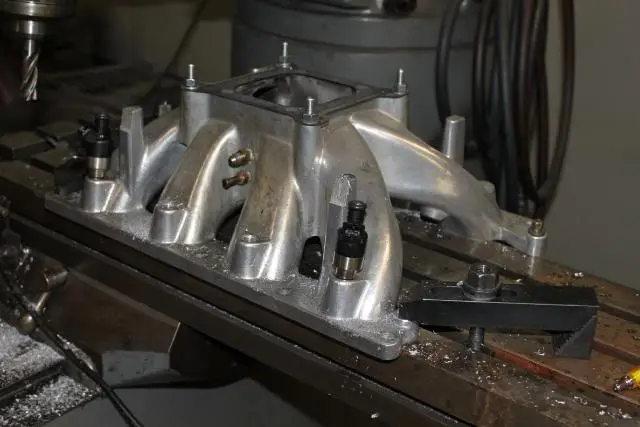

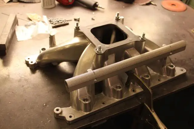

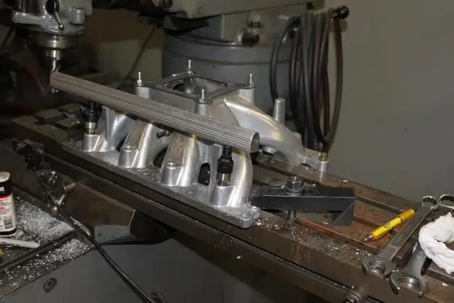

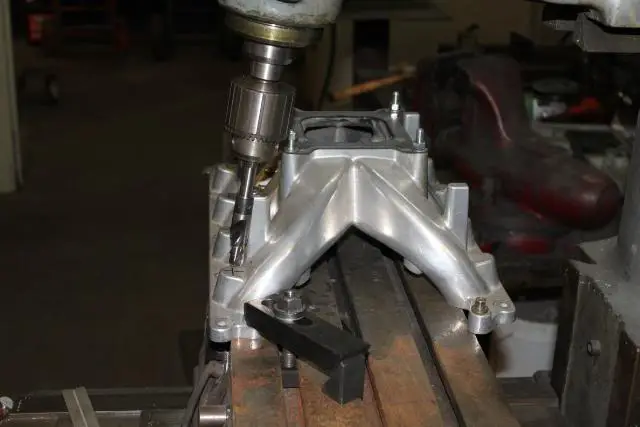

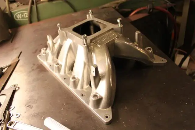

Started out by machining the injector bungs in. The Sullivan intake already had bosses cast in so I did not have to do weld in bungs, just machine what was there. This was my first time doing this so it took some time, but it was not that bad and it came out nice.

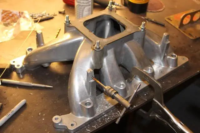

The hold downs for the rails were also cast in but needed some machining also, this was done at the same time.

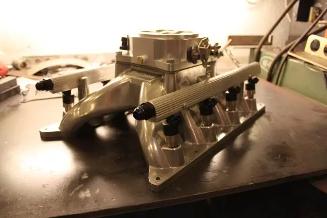

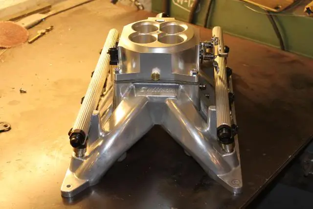

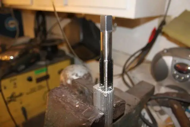

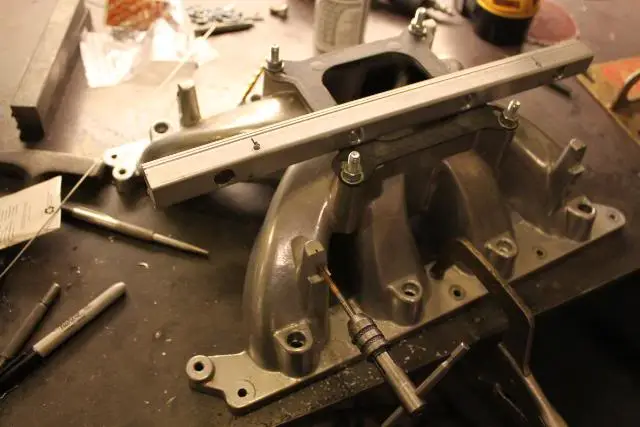

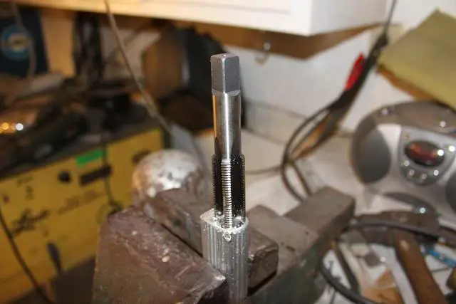

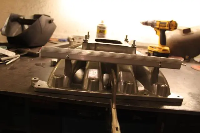

After finishing the manifold holes I shortend and machined the rails to accept the injectors. Also tapped the ends to accept a -8 fitting, drilled the holes to mount them to the manifold, and tapped the manifold for the bolts.

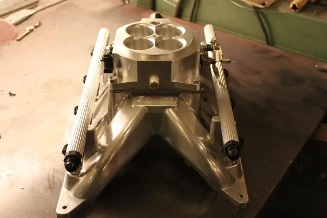

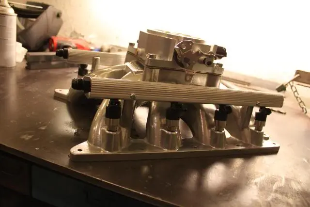

Here are a few pics of the manifold all cleaned up and going through final assembly.

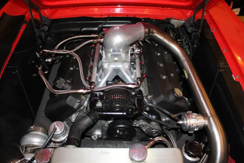

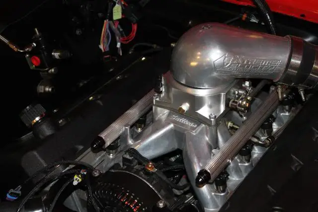

And here is a shot of it sitting loose on the car. I still have quite a bit to do before mounting it for good, but it looks like all the old piping will still work.

As far as the equipment goes, I work for a fabrication shop. I started there when I was 18 (I am now 30) and went though an apprenticship. I now manage our laser and forming departments. So I can use that stuff after hours.
The pictures of the mill are at my local speed shop where I buy all my parts. They got out of doing machine work several years ago and sold most everything off. Now they just focus on selling parts. They kept their bridgeport along witha a few other items, and they let me use the stuff when I need to.
