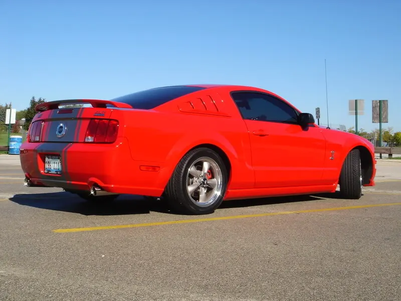

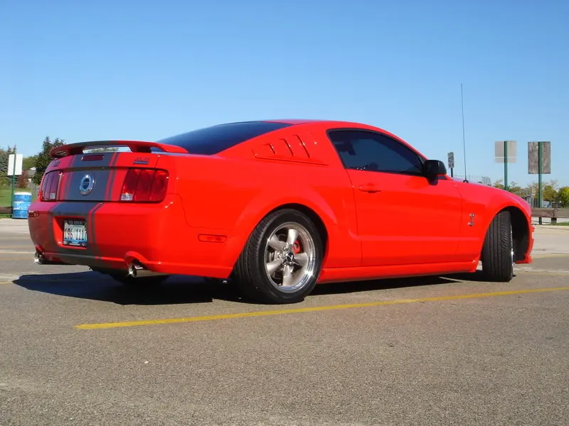

Stock wheels are 17 X 8 and won't accommodate the tire sizes you seek. I am running 245's up front and 275's in the rear but my rims are 17 X 9. Also there are very few tire choices for the size you seek. The only tire I've found in those sizes would be the Nitto 450's and those tires are snow/mud tires and don't work very well on this car!
