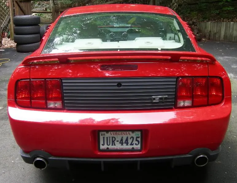

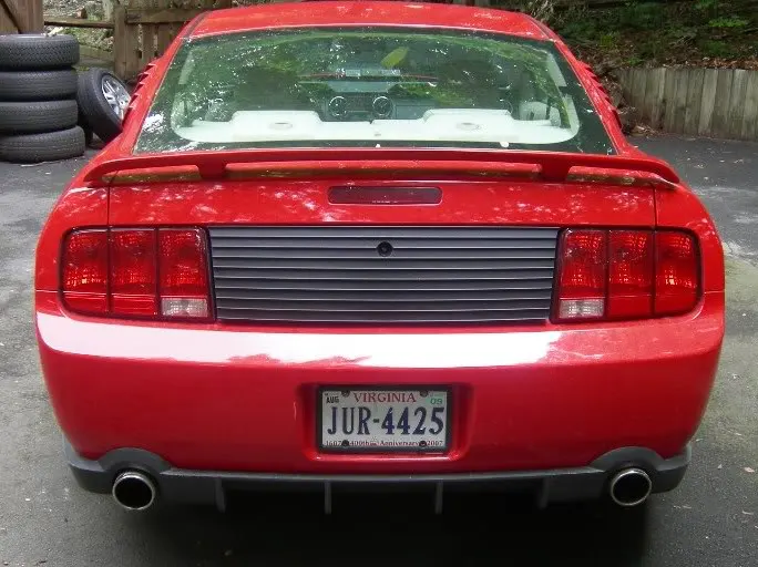

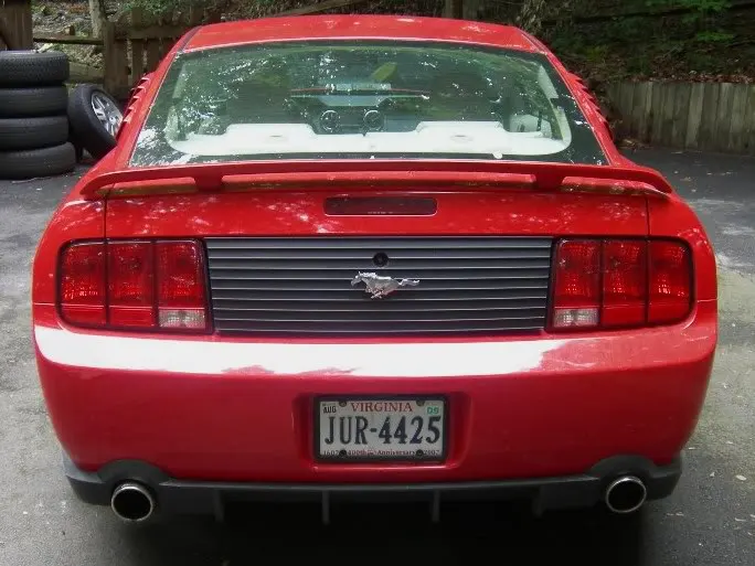

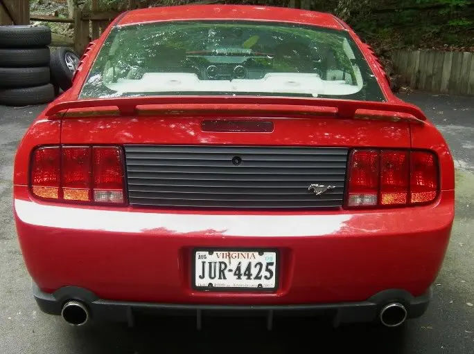

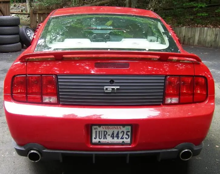

bryce93lx said:
OK, here's some pics of the completed install.
What custom look does everyone here like best of the 5 photos below?
Plain...
With GT emblem center
GT Emblem, lower right
Big running pony center
Small running pony lower right.

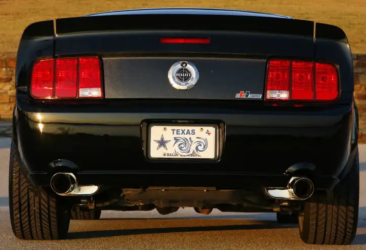

GT emblem lower right corner.
I went with the carbon fiber panel.
I like it a lot.

Like this but with your GT emblem where my Hurst emblem is at.
