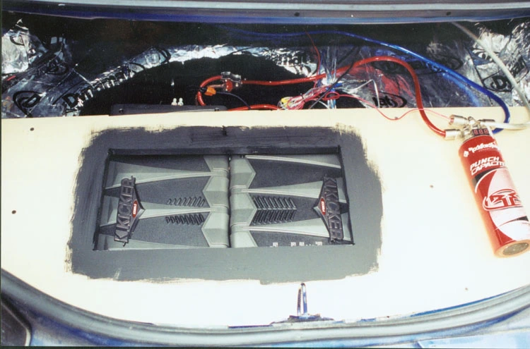

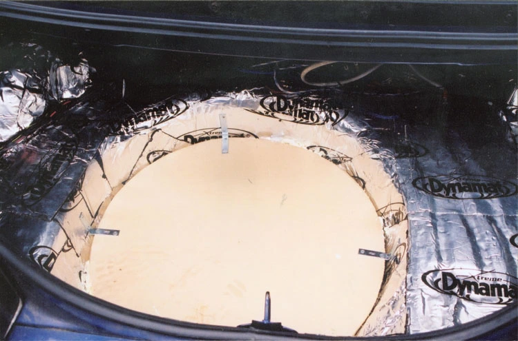

not sure what year your car is...but here are some pics from mine:
