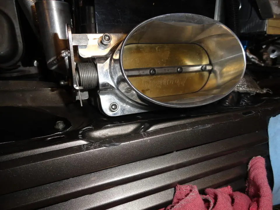

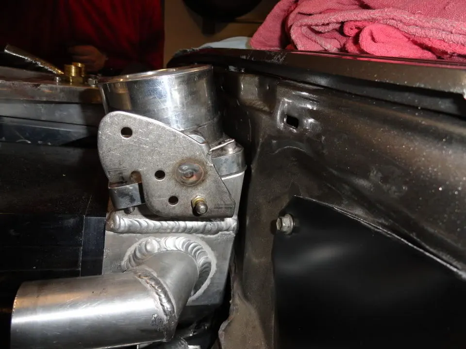

Another shot of how tight the T-body is to the firewall

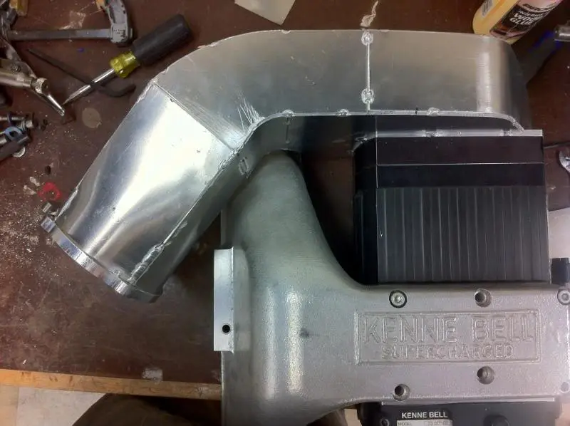

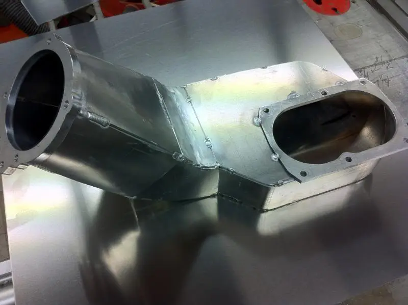

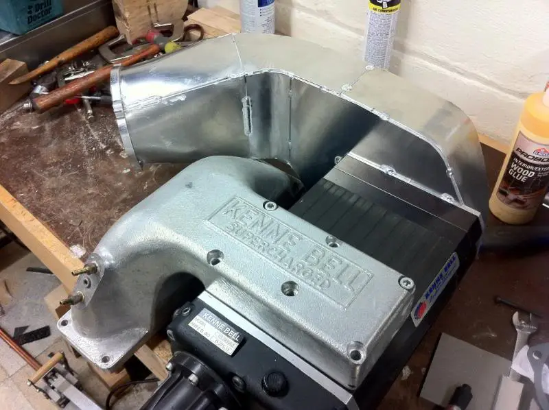

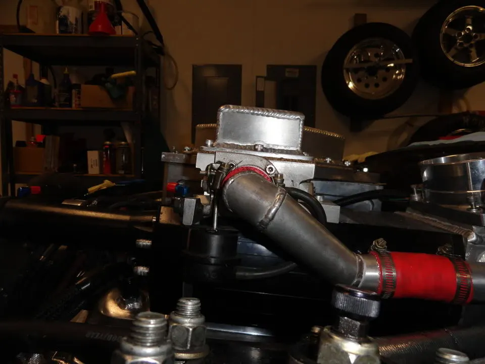

Sneak peak of the massive setup going on my 2.8L, Trick Flow R lower and the split and rewelded KB with 4" pipe. New huge rear inlet 3x8" back box to 5" with 105mm T'B going on.

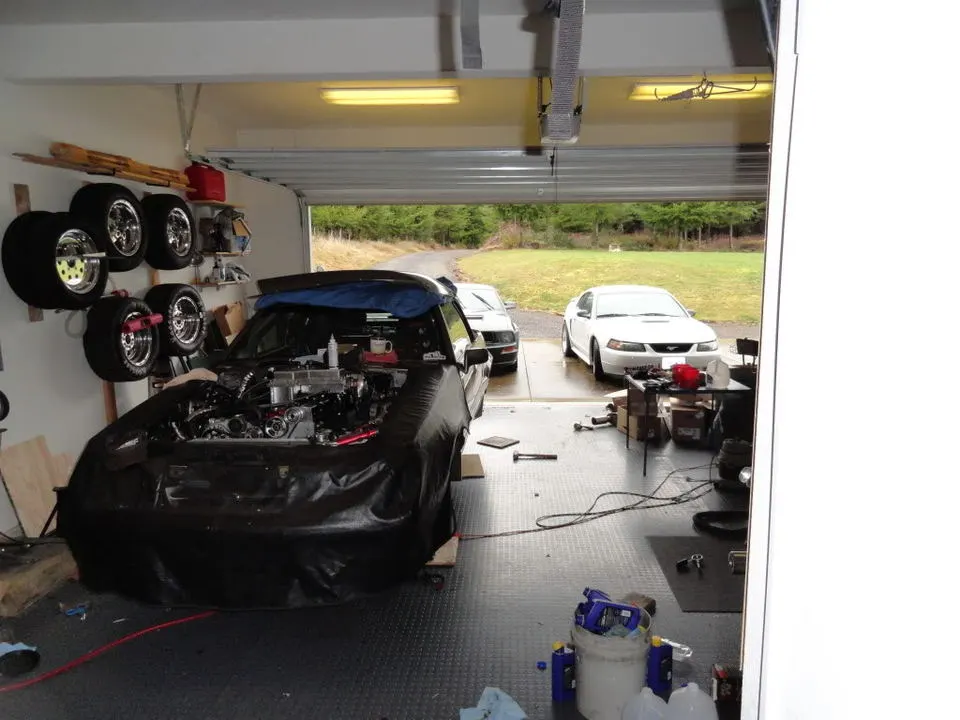

Walter and I just got back from some test and tune runs in Woodburn Or. today and made some progress with the tune of the car. Our best of the day was a 9.500 @ 144.97 mph with a soft 1.485 60 foot. The data log showed that we were still way to rich with the leanest part of the map being 10.4:1 A/F. This is after pulling out about 30% fuel across the entire map as a result of the previous 3 runs data logs. The new fuel system is feeding so much more fuel to the injectors, that the previous fuel map was dog rich. Even now most of the fuel map is in the 9.4 to 9.8:1 range. Plus we played with the ignition timing to try to get the car to leave clean. Started out with only 15* timing for the first 5,000 rpm and ended up with 19* for the first 5,000 rpm and then jumping to 24* after 6K. The engine responded very well and we now we are headed in the right direction. We also found that the 3.25:1 gear is to tall as we are crossing the stripe at only 6,700 rpm. The new solid roller cam is pulling hard to 7K plus, so tomorrow we are going to swap in some 3.50:1 gear and then head out in another week or so for some more tuning. If everything goes as we hope it will, we should end up with a 9.2 or so at about 148 mph...............we shall see. Maybe now, just maybe, this is the fastest and quickest Kenne Bell powered pushrod 5.0 based car, and all of this on a 26X8.5 Hoosier with stock rear suspension.
