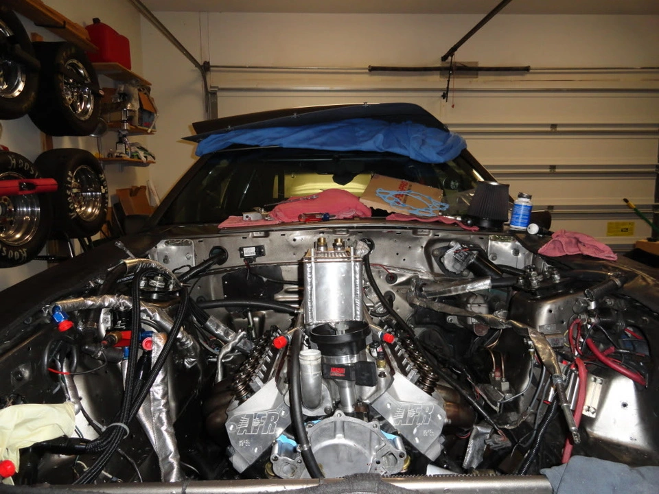

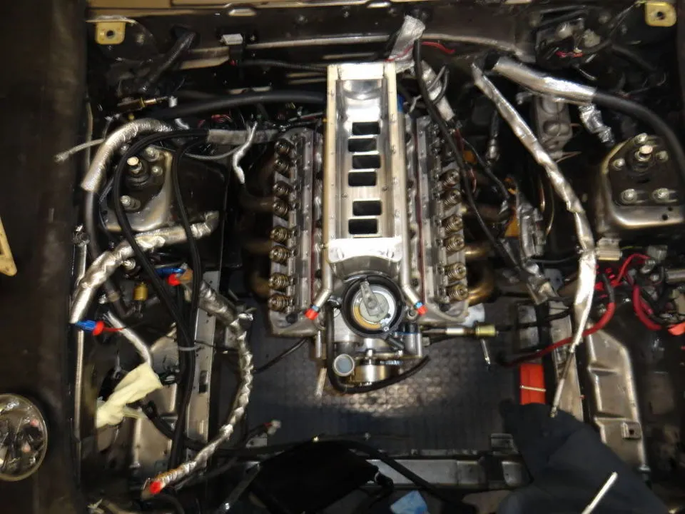

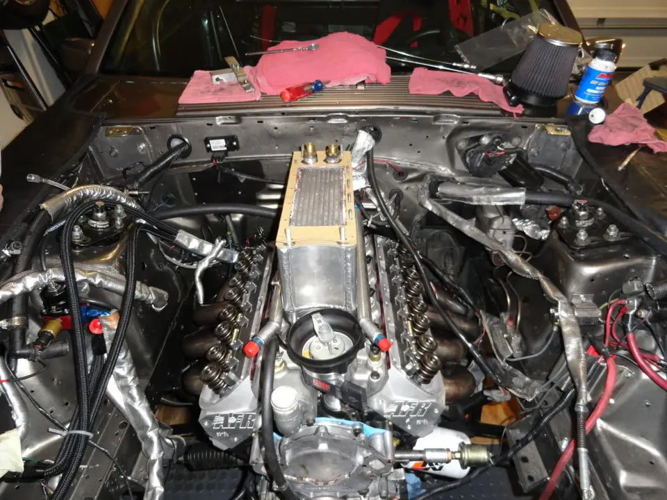

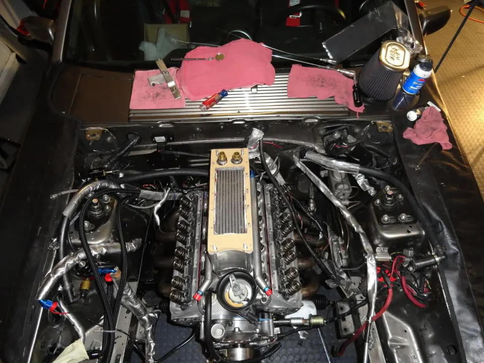

So at this point we are on hold as the pushrods we used before are to short. The Jessel set up is going to require a pushrod .250 longer. And since we could go no further on the engine, we took apart the rear suspension to check out the condition of the heim joints/spherical rod ends, and yes they are shot. So new pushrods are on order as well as the new heim joints ect. With Walters work schedule factored in, it will be the weekend of March 17/18 before the engine is up and running and we get the car on the dyno to adjust the "tune" for the new combination. I will have more pictures and possible video clip of the engine running at that time. stay tuned!
