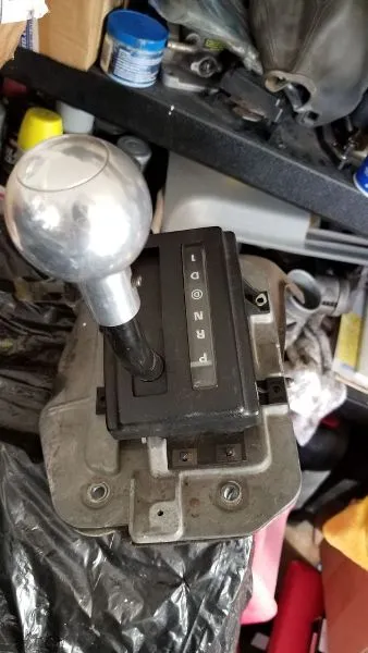

I have this AOD shifter, it has an aftermarket handle but it works perfect. I will give it to you if you want it. Just cover shipping. Let me know.
Chris
I think the nss is on the trans, but some years have the cable lock that goes from the shifter to the ignition switch which makes it so you can't take out the key unless it's in park. This particular shifter does not have the cable lock on it. I think it is out of a 1990.
I have a stock AOD shifter on the car already. I need to look at everything close to see exactly what may be missing or not wired up properly. If Ragged GT needs that shifter, pass it on since I already the stock one.
