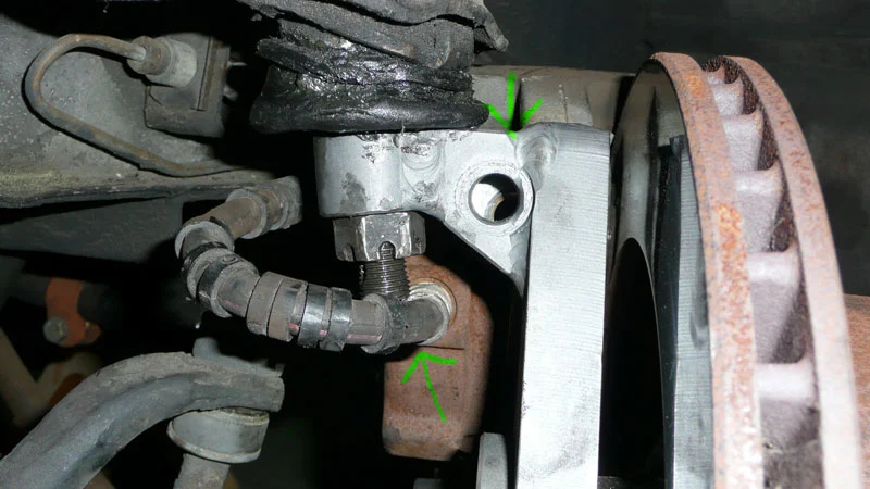

The spindles are indeed fabricated. 1/2 inch plate with a steel pin pressed into it.
I have attached a picture that shows part of the spindle construction as well as one of the problems. The welding is good, construction is solid. I can't answer the question about the spindle pin itself fitting any other kits. I was changing from a stock Maverick disc spindle to these so have no easy access to another setup at this time.

I just got a call back from Mike at Fatman. It turns out that I didn't check the box well enough. They had included a small plastic bag with banjo bolts and a brass fitting in it and on the very bottom of the box was a set of instructions with my receipt.
To address the problems I had, there are several steps required.
Caliper to control arm. Grind off the top part of the caliper bracket until it doesn't contact anymore.
Lower control arms may interfere with the rotor. Modify the outer end of the control arms with a hammer or grinder to give yourself approximately 1/8" or more of clearance.
Brake hoses. Use hoses from an '85 Buick Riviera (NAPA #36959) drill out the brass block of these hoses to 7/16" and use brass washers and a banjo bolt to attach to the caliper.
They confirmed that there had been a jig issue that caused one of the spindle to caliper bolts to be misaligned. Now fixed.
I will post pictures of the completed installation later tonight with better pictures of the spindle.

Thats what I thought, but from the looks of the pic you posted, it lloks like the upper ball joint is in a bind...unless there is no weigh on the vehicle when that pic was taken, and as I go back and look at it now it seems as though there isnt...
