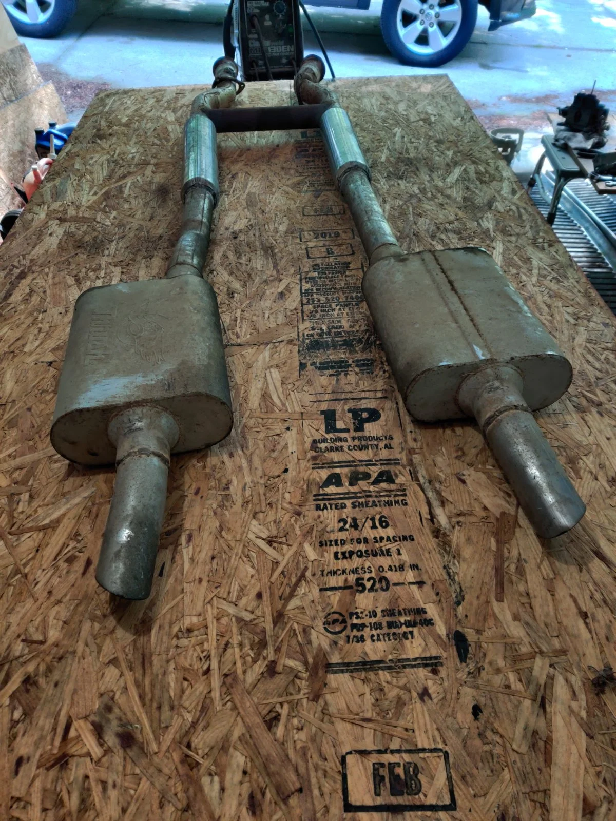

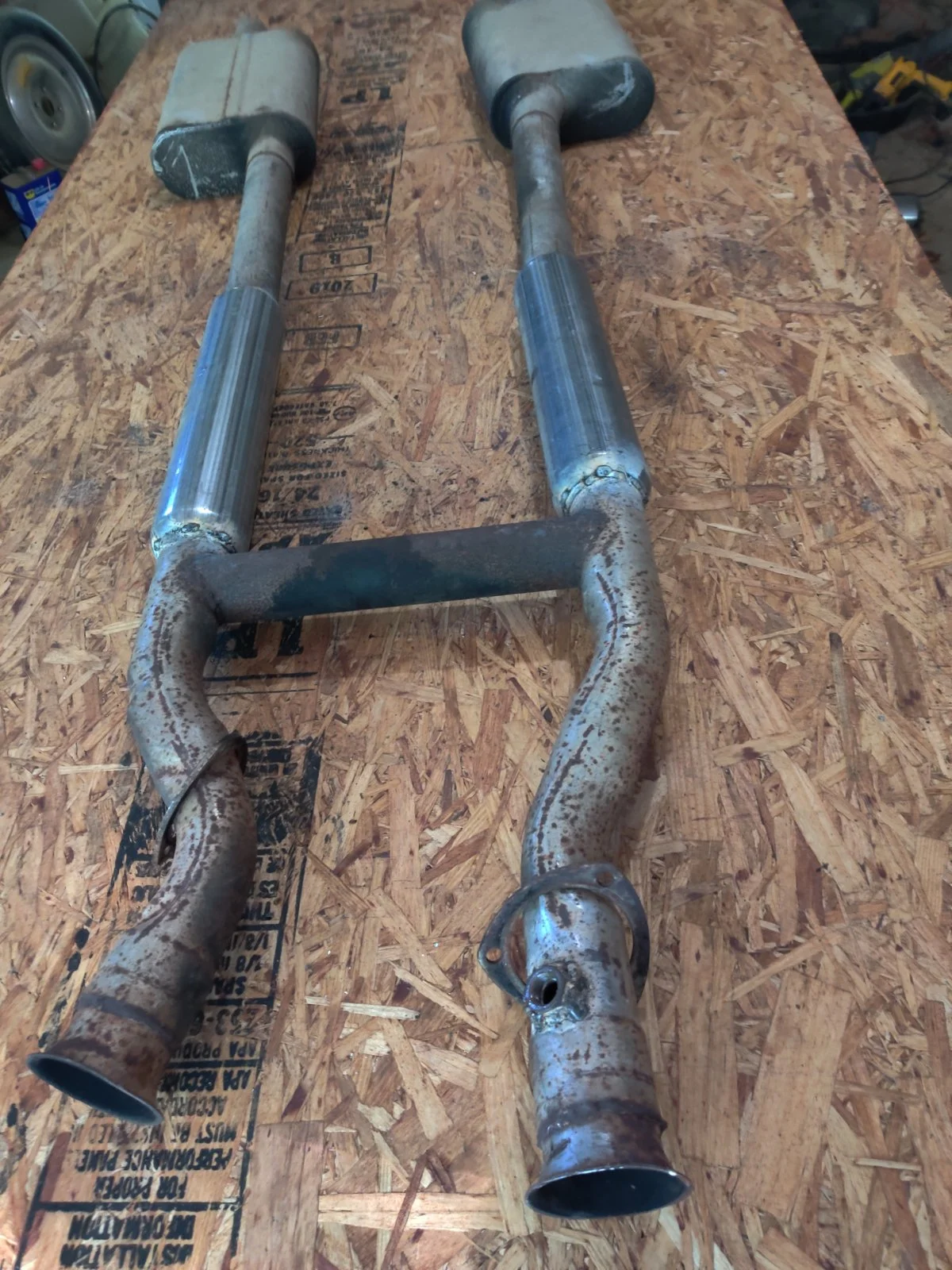

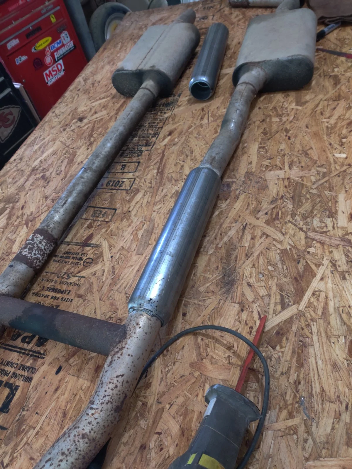

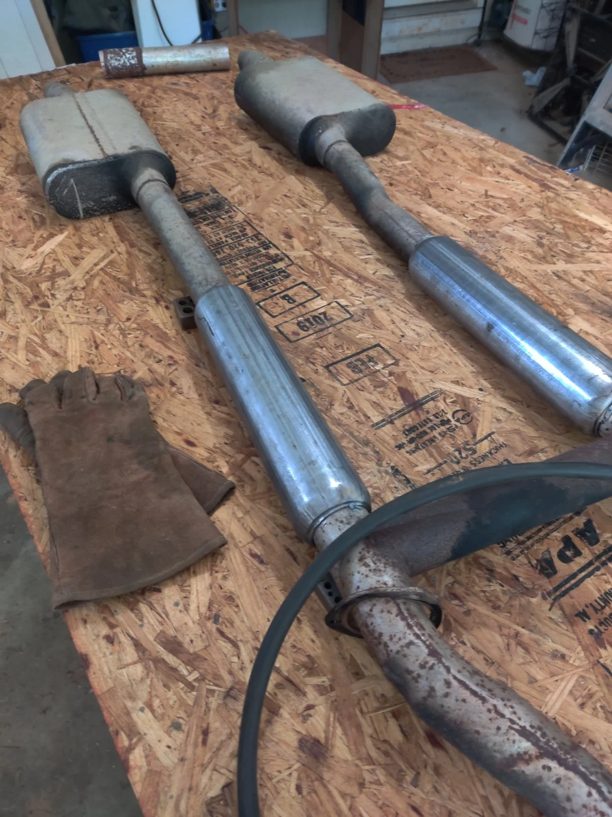

When compared to open headers, it is. Even compared to what it was before I added a pair of glasspacks upstream of the 2 chamber Thrush mufflers. But it's still a bit too loud in the car, so I'm thinking I'm going to try one of 2 different things depending on what I can get done. I'm looking to either run tail pipes under the rear of the quarter panels like a Fox LX or 85-85 GT, or I'm thinking of swapping the Thrush mufflers for a pair of Flowmaster 50 series Delta Flows. Even then I may consider the tail pipe idea. I like the way it sounds while outside of the car but I'm deaf enough, I don't need the help inside the car.
Here's my exhaust setup right now.
So these are louvered glass packs, I ended up installing them with the open side facing the headers since that offers the most noise cancelling. I really hope I like how it sounds when it's all said and done, but I have no doubt it'll be quieter.
