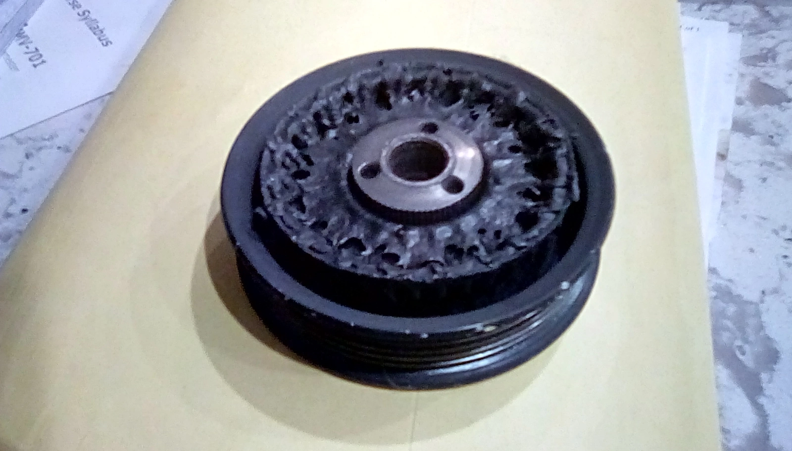

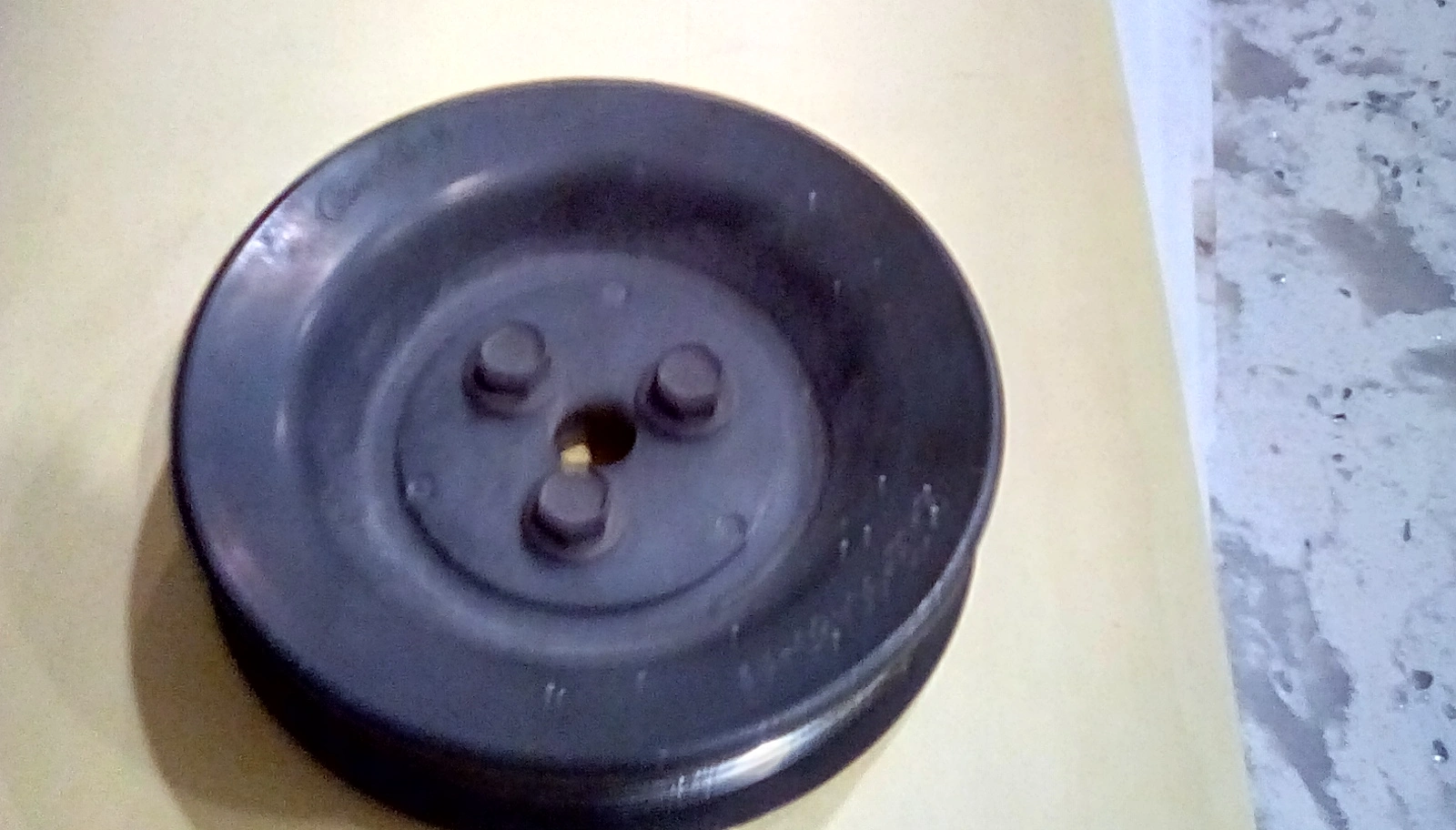

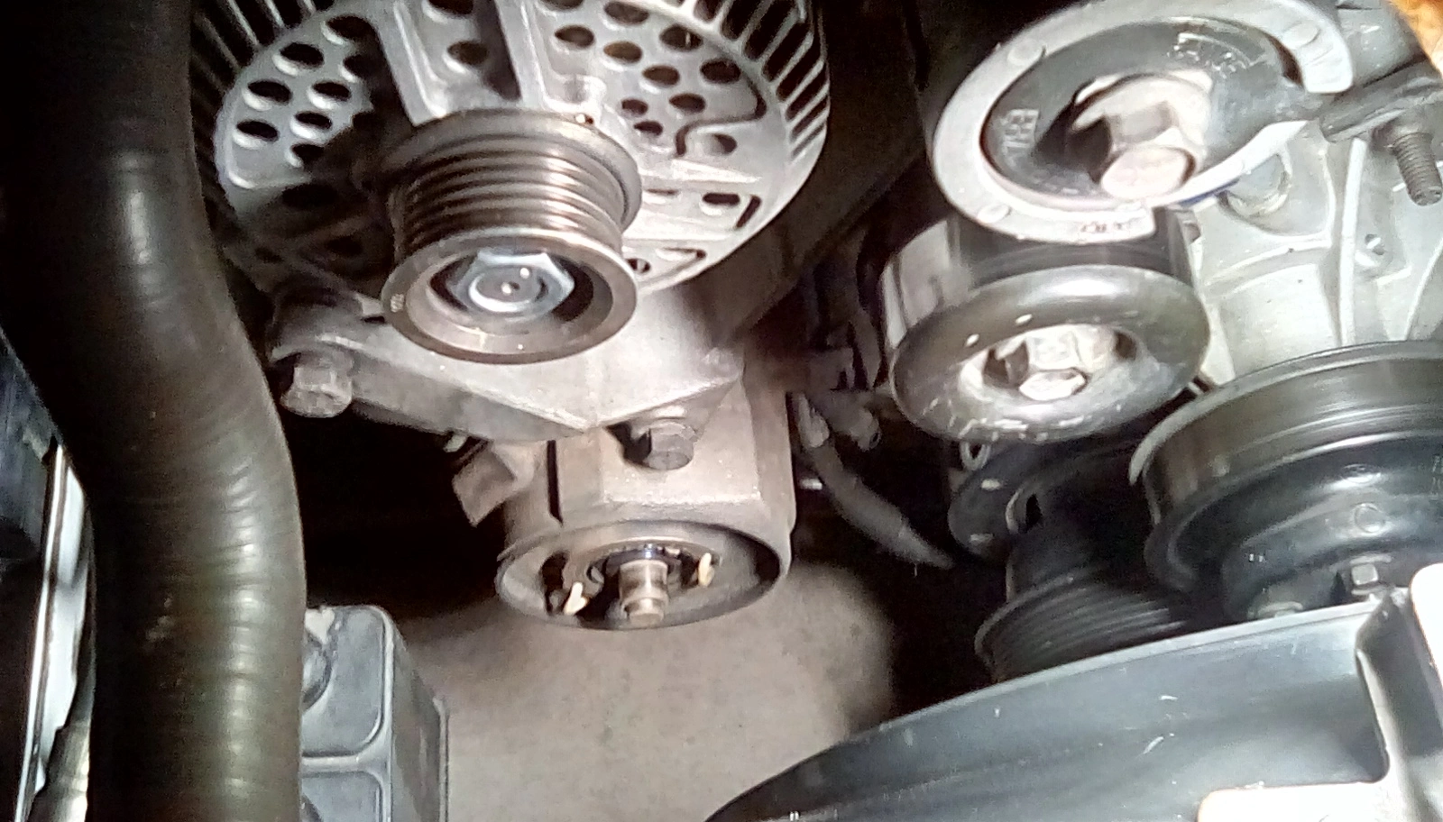

One f,ing thing after another.Took the wife out for a ride , just crusing,shifting,down shifting,she says it feels smooth and I say it's a little louder then before.She seems to think it's the same.after about a 45 min drive we head home.three blocks from home,at a traffic light,I hear a ting,I said something fell off the car,she said it sounded like a coke bottle hitting the floor.the battery light comes on and I shut the lights and hall as home,blowing the one traffic light in my way.it pukes coolant,open the hood and the smog pump pulley is gone baby gone.we jump in her tourass and head back to the scene.She finds the pulley,it shredded off from the plastic vanes .I remember replacing it back some twelve years ago,when Oreilleys was checkers . They can have one tommarow.$237 WTF.for a reman.I give him my phone # and he can't find warrantee. Lucky me I still got the receipt, I paid $49.99 on 3/17/08.Can you believe it quadrupled in price.oh I need a belt too.

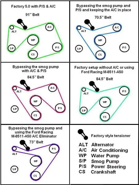

I bypassed it with a different belt. If you have air I think I can give you the number. I had a very hard time with the string method at the time.
yeah Pete I got factory ac. I'd like to get a shorter belt just in case. I did get a free replacement from oh oh oreilleys.And I found my old belt two blocks from my house,and Auto get in the zone warranteed the five mounts old continental belt, so no cost repair.
Just remove the smog pump and go with a shorter belt. 84.5" I think. Here's a reference:
