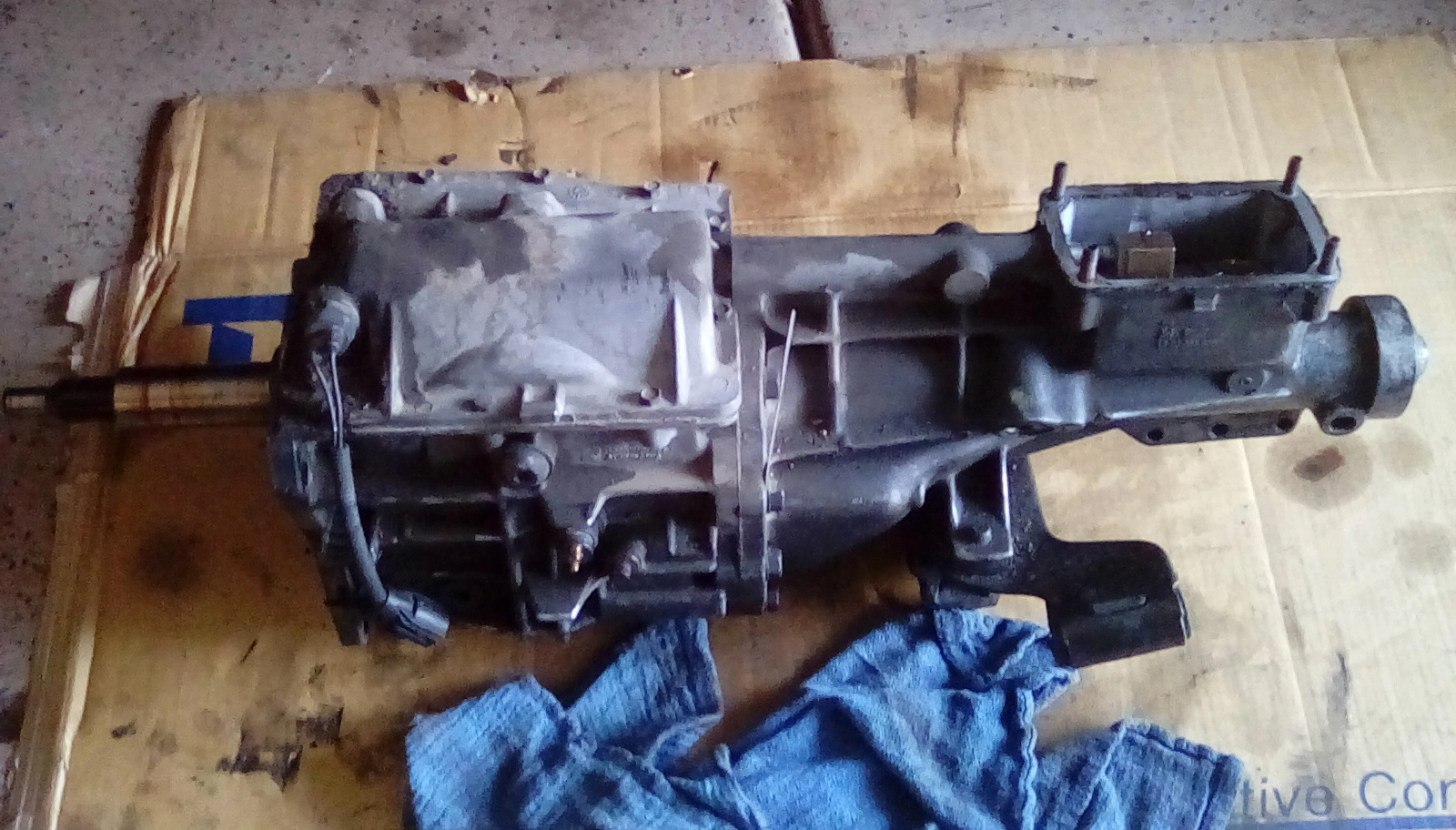

I'm off work this week so I figured I'll drop the t5 ,do the clutch p/plate flywheel and rear main seal. It's been about twelve years and 110,000 miles since I did this, and of course it was my first Windsor so I didn't put any thread sealer on The new flywheel bolts.it has leaked about a quart every 4-5 thousand miles( oil change time) so I left it alone.Now this time I'm thinking of not only using thread sealer on those bolts but also installing the felpro micro sleeve as a pre caution. I ordered the sleeve and install tool and would like to know if any of you all had used one? How did it go?do any of you have plans this week that include coming to Vegas to help? I think this is the most I ever typed at one time,maybe I'm just procastinating????

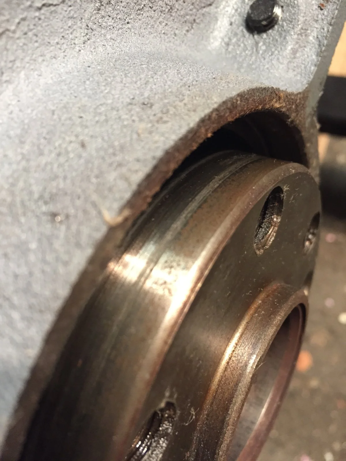

I replaced the rear main at 99k miles and it leaked. When I had the motor out I noticed the groove in certain light. I might have a pic
sleeve install was easy. Line up, tap in place with tool, then install the rear main seal.
edit: pic attached. I could not feel it with finger; but in this pic it’s obvious. In fact the pic makes it look huge here. Like I said, you couldn’t feel it.

thank for the pic.yeah I think it'll be worth it.

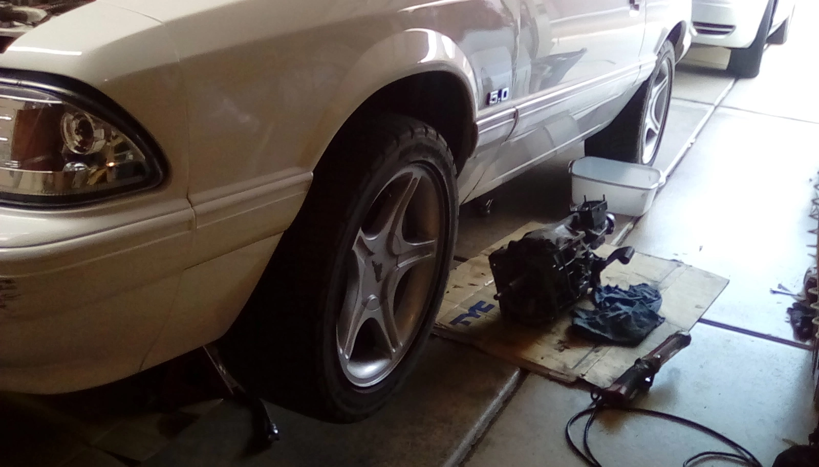

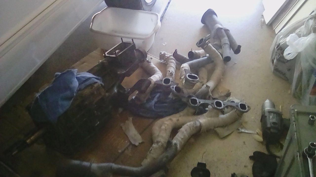

Cheap slip fit longtubes,over a decade old,leaked almost immediately,welded.Now to remove to get to bellhousing,sawzall .Cut out and ready for trash tomorrow.good news got sleve and tool delived today.

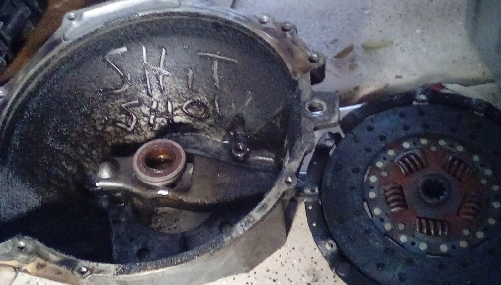

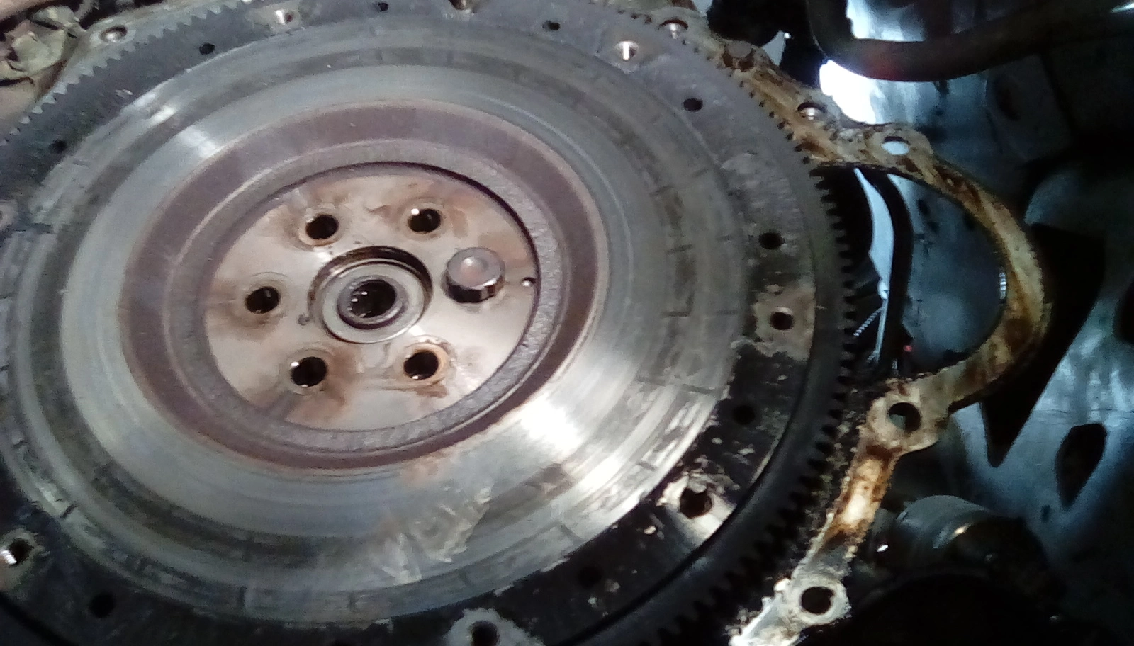

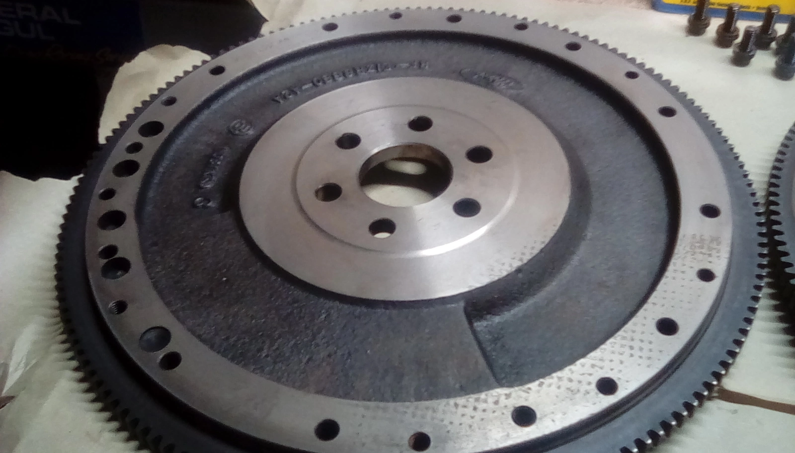

Closer look at disc and one rivet started to get cut, I didn't put thread sealer on flywheel bolts when I did this last time( in my defense I never did a Windsor flywheel before and didn't know) so I have a new flywheel,clutch,pplate,New arp bolts, rear seal and sleeve.Also gonna put t5 that I rebuilt in, since I trashed the long tubes I'll use the bbk shorties I've had laying around and the mid pipe(that has gutted cats,I have we ones to be welded in).

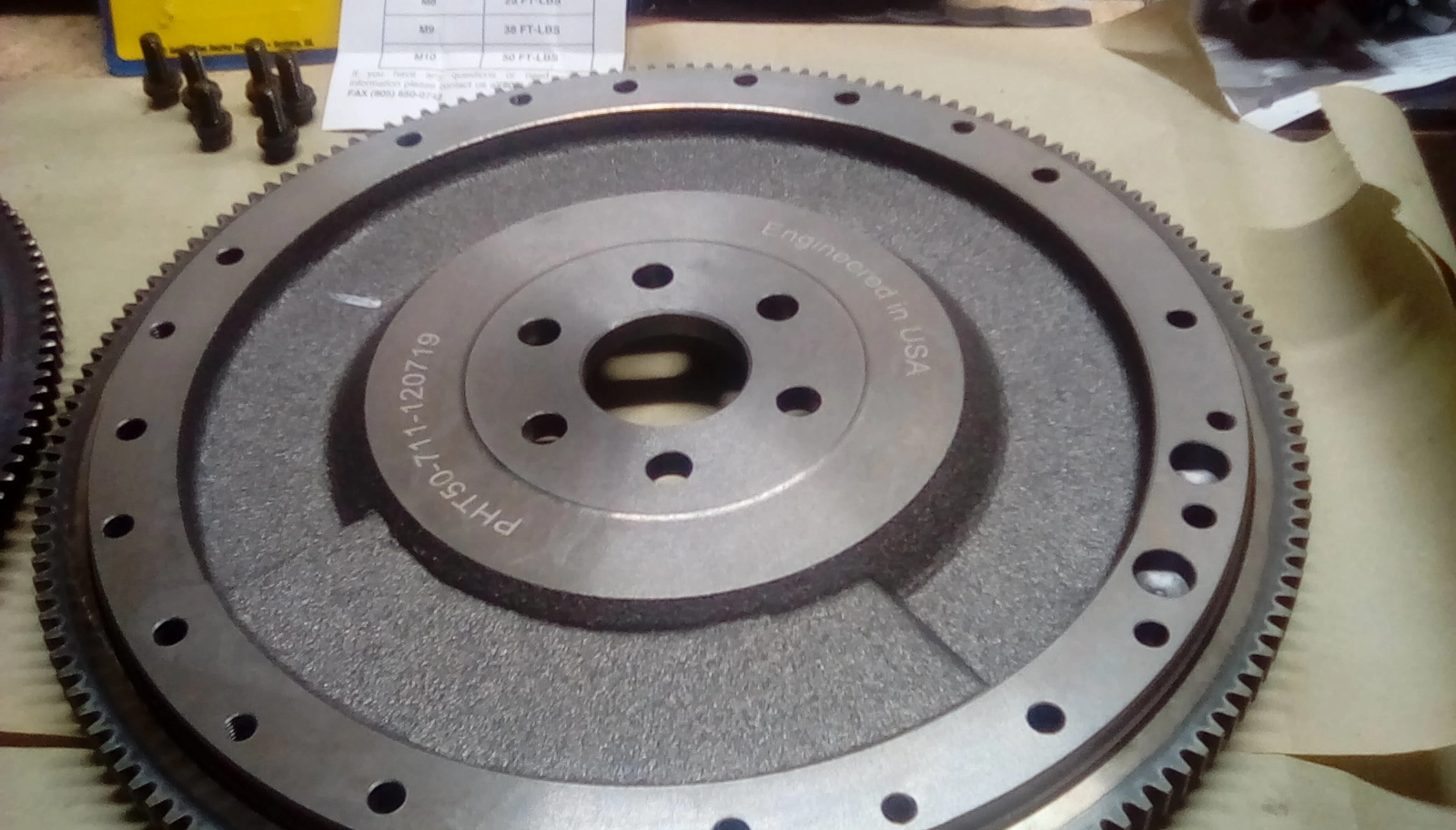

Getting those headers out Sucked big time! Cleaned up today,compared old Ford vs and new perfection f/w, gotta call ARP for toque on new p.o. Bolts.

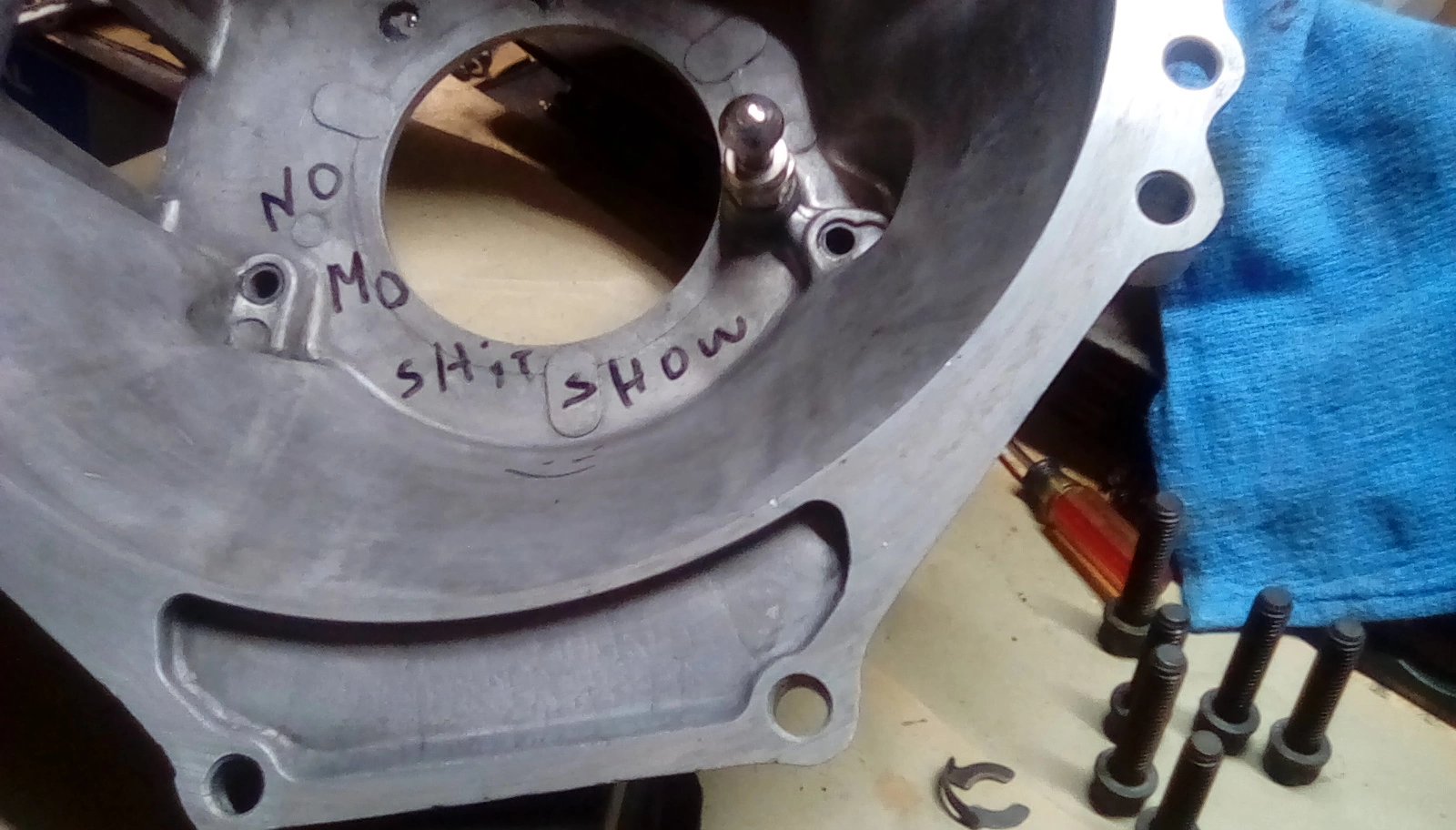

Yeah, I just installed it and a new seal.Now to put everything back together, I'm waiting to hear about what amount to torque the new fw and pp arp bolts to.you have any idea?
The :poo:show
continues.it's a wonder the clutch lasted 12 years and 110,000 miles with the oil leak as much as car theifs Exxon v.
The after pictures look good, but did you realize you removed the automatic rust prevention feature? There are oil spray on set ups being sold to winterize the underside of cars. Yours was self oiling,, no sprayer tank or a lift needed.
