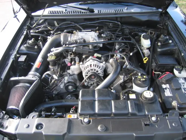

Sounds like the K&N FIPK fits what you want. I have the kit and absolutely love it.
Low-restriction tubing
composite plastic (no heat absorbtion)
heat shield
huge filter
Whatever kit you get, stay away from those made of metal. I made the mistake of purchasing an MAC CAI (made of chrome) the first time around and I swear that I would have suffered 3rd degree burns if I had touched the thing.
