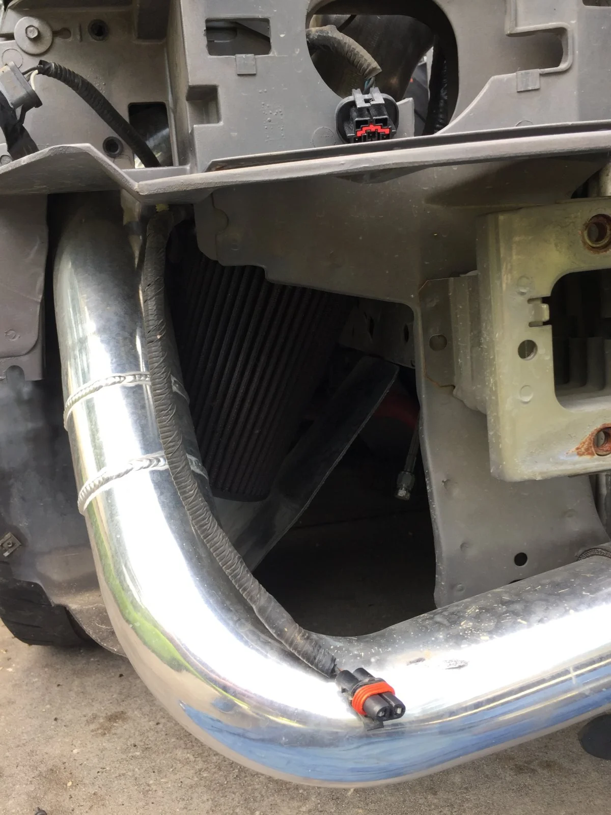

So I am here again with a question. My SN95 GT has a cold air intake system that runs out into the front right fender well. Question 1: how do you inspect the filter and change if need be?
Question 2: am I at risk of sucking in moisture or water and hydro locking my motor? I'm assuming it has to be relatively safe, otherwise, it wouldn't be on the market. Any tips, input, suggestions, or personal experiences would be greatly appreciated. Maybe I should just put a new CAI on where the filter is in the engine bay and not under the fender well.

Ease of Access to the filter depends on the year of your GT, CAI type..(?) The filter’s clamped onto the 90 Deg.Tube entering the fender, bolted or clamped to your MAF.
With some CAI’ types, you can easily access the filter from up top, others you may need fight with a tad, (partially dropping the fender skirt helps) & working from bottom up to loosen the clamp & pull the filter down through the working space between the lower front fender & the skirt.
Most CAI filters, I.e. K&N, BBK, SVE, etc. -are reusable. Remove, wash, dry & re-oil, reinstall. (I just replace them)..Both filter design & the proper application of the Mfg’s filter Oil on its surfaces both play a role in repelling the small amounts of external moisture it’s exposed to from entering the Intake, per your concern.
Is your engine running erratically in the rain, or is this more access to filter convenience?
Note that some CAI’s May require a Tune to run correctly, or prevent a CEL. If you modify the car with with another Intake, you’ll potentially be looking at a Tune specific for the new unit you do install.
Is the Car stock, otherwise, or are you running an aftermarket Tune?

Car runs great and without issue. I just started thinking about how rain water sprays from the tires and then thought "well hell..... is my breather going to be sucking in all of that spray / road wash?? I had a Mach 1 in Highschool with the Shaker Hood and never had any issues so, I figured that the fender mounted set up was at least as safe as the shaker, if not more so.
Hi, - Mach 1 with a Shaker- sweet ride! Yeah, all the Shakers, Ram Air, Air grabbers from the Classic’s & though it seemed it would, none flooded out. But once you saw it, up close & personal, then it made more sense

Around 1x a year, you should pull the Filter & get your MFG’s specific rec’s & Oil for cleaning & reoiling.. If you need to go from underneath to get it, it’s 20-30 minutes (+/-) your first shot, half that the 2nd time.
With most fenderwell intake systems, you install/remove the filter from the bottom. it’s piping all done from up top. Ironically, the stock Filterbox pulled it’s air from the same area, and flowed well- OE piping is restrictive.
On that note I’d attached a link showing one going in for some insight. If you have questions about details, feel free to ask. Good luck!!

I’ve always put my filter in the fender. Putting the filter in the engine compartment will always warm up the air to some extent. Anything that gets you the coldest air possible is always to your advantage - that’s why I bought a huge three row intercooler, it’s why people use meth, and it’s why nearly every OEM performance car has design features to draw external air rather than under hood air. The difference is small but I’ve never had that “heat soak” feeling - it is more obvious at bigger power levels: http://kennebell.net/about/the-kenne-bell-30-50hp-advantage/
