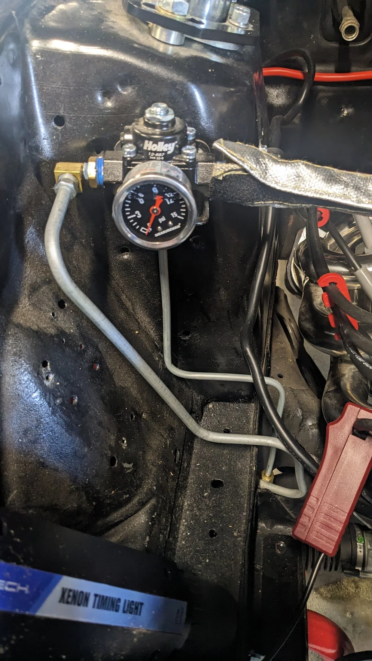

For those of you who have replaced your intake manifold with a four barrel carbureted model what did you do with the return line on the fuel injected gas line? I know I can just regulate the pressure down on the input line. Can I just plug the return line?

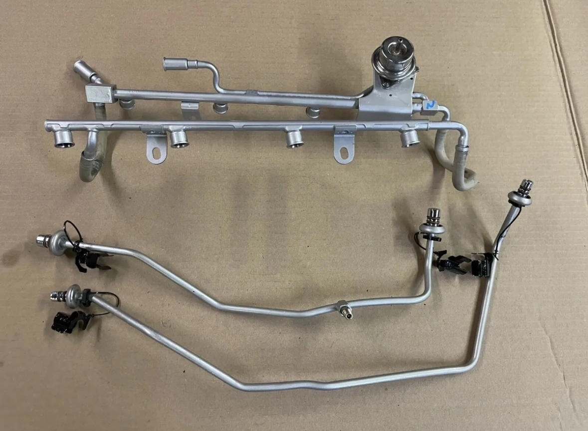

Follow the hard lines that connect to the injector rail down to the sway bar. The ones in the bottom of this picture:
Disconnect them from the body lines and then use these to get 6AN connections so you can then build braided lines to the regulator.
Inlet side P/N - 640900
Return side P/N - 640870
Reactions: Noobz347 and JD1964
Thank you all for the good advice about the fuel regulator and associated fuel lines. I ordered a regulator online with a return and it came with stainless steel braided hose and AN fittings so I should be good to go, again thank you so much. You guys are great. Rob.
