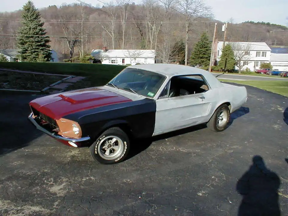

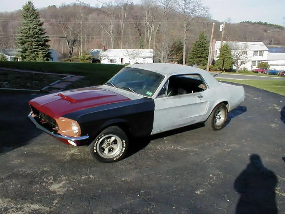

Here is photo of mine before finishing. Man, why can't the fabrictors make all new parts the same color?:D
The bend in the 67 hood is greater then the bend at the top of teh fenders. IN short, the hood sits higher in the middle at the sides. I don't know how to fix this though. You can't see it too good in the picture.

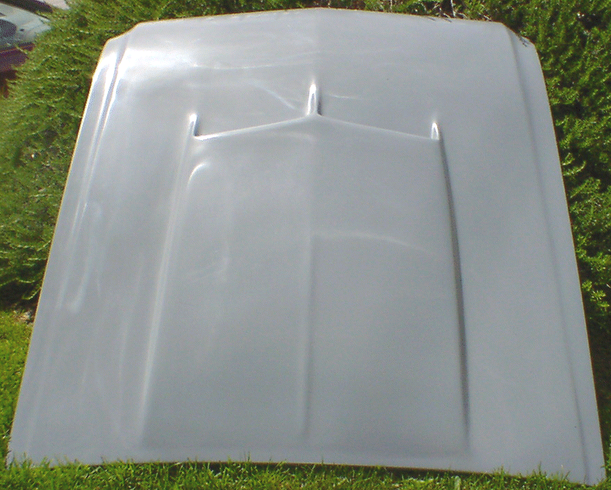

I bought the E2 hood for my 65 fastback. I wanted something different and needed room for the Webers. While I wouldn't call the E2 hood my favorite it's not as bad as the Elenor hood for 67. I have also learned the hard way that an open hood is not worth the limited benefit. The fit and finish was the best I have worked with although not nearly as good as steel. I don't know if they make the hood with a steel fram but call Jay at MD as he works closely with the manufacturer. There are a few pictures on Mustang Depot's OK Corral section.
http://www.mustangdepot.com/Media/e2gallery.htm

...The bend in the 67 hood is greater then the bend at the top of teh fenders. IN short, the hood sits higher in the middle at the sides. I don't know how to fix this though. You can't see it too good in the picture.
I agree as I have the same issue... not too bad though (probably a good 1/8 to almost a 1/4 of an inch rise in the center as it is related to the fenders).
That looks like you left the springs on your hinges!
Also, where did you get it?
Put a soft towel on the hood and some weight and it will slowly conform to the desired height. Once there, take some foam weatherstrip and put it on the bottom of the hood, 1/2"x1/2" will work. Then get some woven fiberglass cloth is strips about 3"-4" wide and glass over the weatherstrip. Don't press down or try to saturate the weatherstrip, it's just a light weight form for the fiberglass. Once cured, it should hold it's shape.
