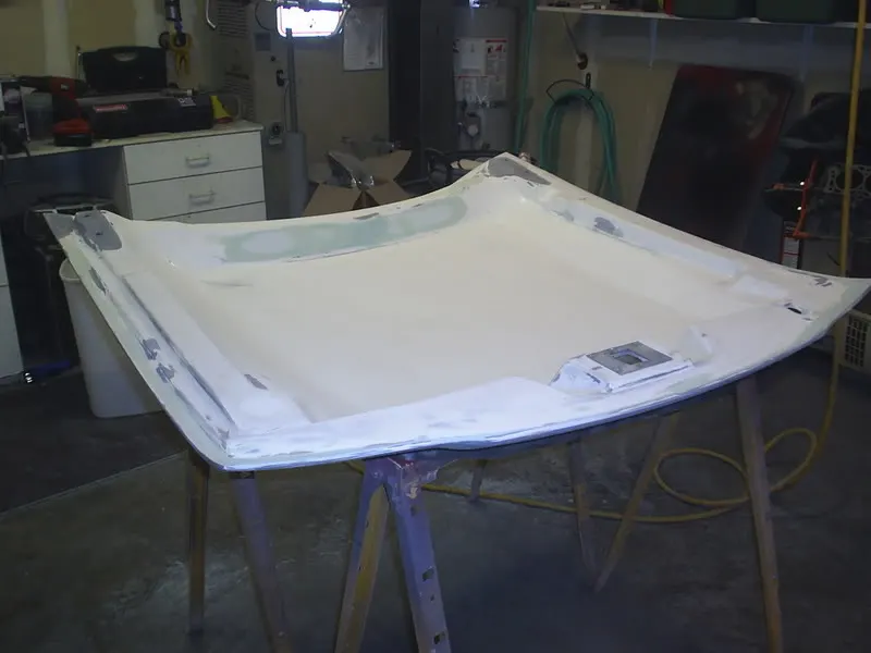

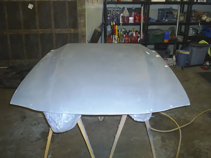

Heres the underside of my ebay fiberglass hood. Its a single cowl and will hopefully be finished here in the next couple weeks. I skim coated the entire topside with glaze and blocked it using my longboard with 80 grit. Then applied more glaze and blocked that finishing with 150. Then primed that. Blocked the primer after guidecoating with 180 and reprimed the bad spots. Gonna block it again and then primer it again and wetsand it with 400 grit and hopefully just paint right overtop of that. But if not I'll seal it and then paint it.
The underside I filled in these stupid "slits" they put in the hood to make it look functional or something? And had to build up the front of it because of how poorly it was made.

Thanks dude. I'll flip the hood over and get some pics of it as it is today. I'm gonna start blockin the primer with 320. I'm gonna check it over for pin holes and fill those in and atleast reprime today. Depending on how fast the primer dries I just might wet sand and paint it today.
