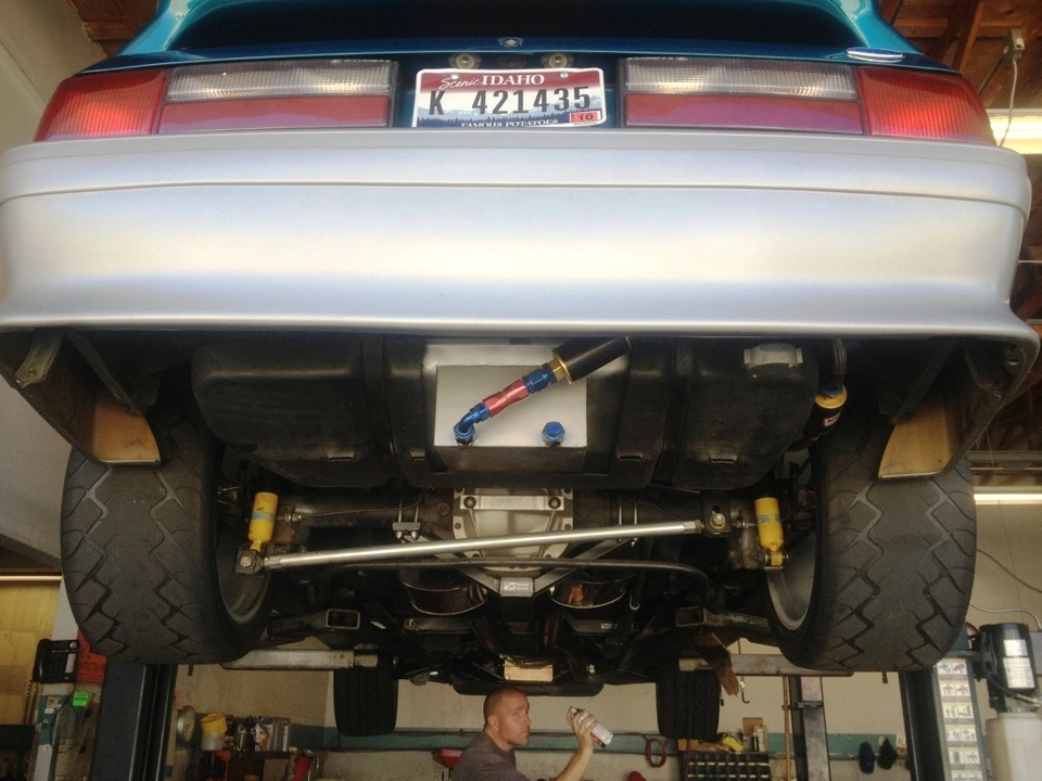

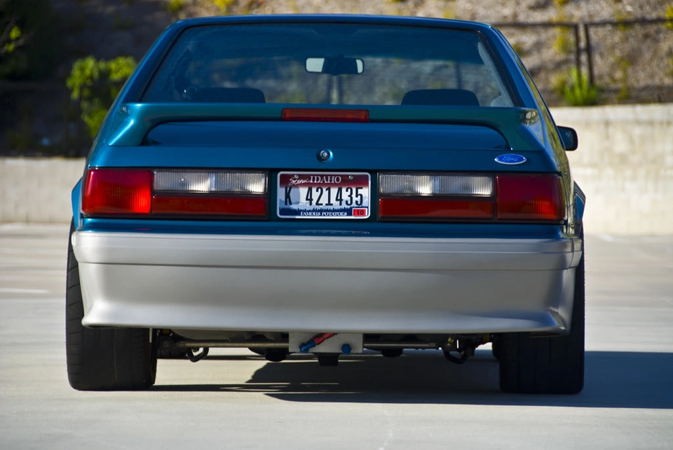

Plain and I doubt anyone would notice they weren't there
You'd be surprised. On my pickup truck I have only one badge on the pass fender, didn't even notice when I bought it, but I've had 3 people notice the badges, so I guarantee if I have a fox enthusiast looking at it they will notice.
Regardless I'll probably do it anyway. It's the little things that make a project yours.
I agree, I don't think it's so much that they won't notice as much as it's so common for people to "customize" these cars. Personally I wouldn't say "Look at that you filled em in!". If I saw it I would just assume you bought the aftermarkets that don't have the letters. Not worth the trouble in my opinion.
