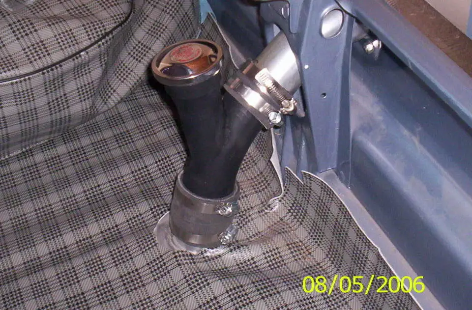

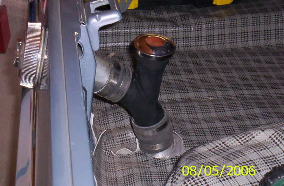

I tried this route and it works great to fill up with. What I did was use an old filler neck, cut an oval hole in the original, and braze the mod on. I used a vented cap and sealed it with JB Weld to prevent fumes in the trunk. Could not find a non vented to fit the filler neck I had. Also, had to modify the rubber hose after making the filler neck a two piece or it would not be possible to install.
Now, the down side is the expansion when it is hot outside, allows the vapor to be trapped in the modified area and not vent out the original cap. This has caused fuel to be vented overboard from the original cap. Guess I need to run a vent tube out of the modified neck area and out of the trunk. I am also thinking of lowering the modified cap to sit right on the original filler neck instead of a couple inches up as it does.
Original cap still functions also.
