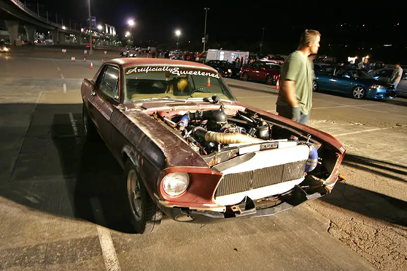

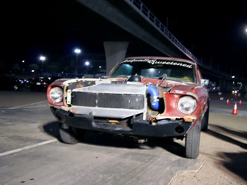

So I totally went out last night and stalked you...
jk, but a friend of mine was at qualcomm last night and unknowingly snapped a few pics of your car.
http://anti-rice.com/phpBB2/viewtopic.php?t=10764
