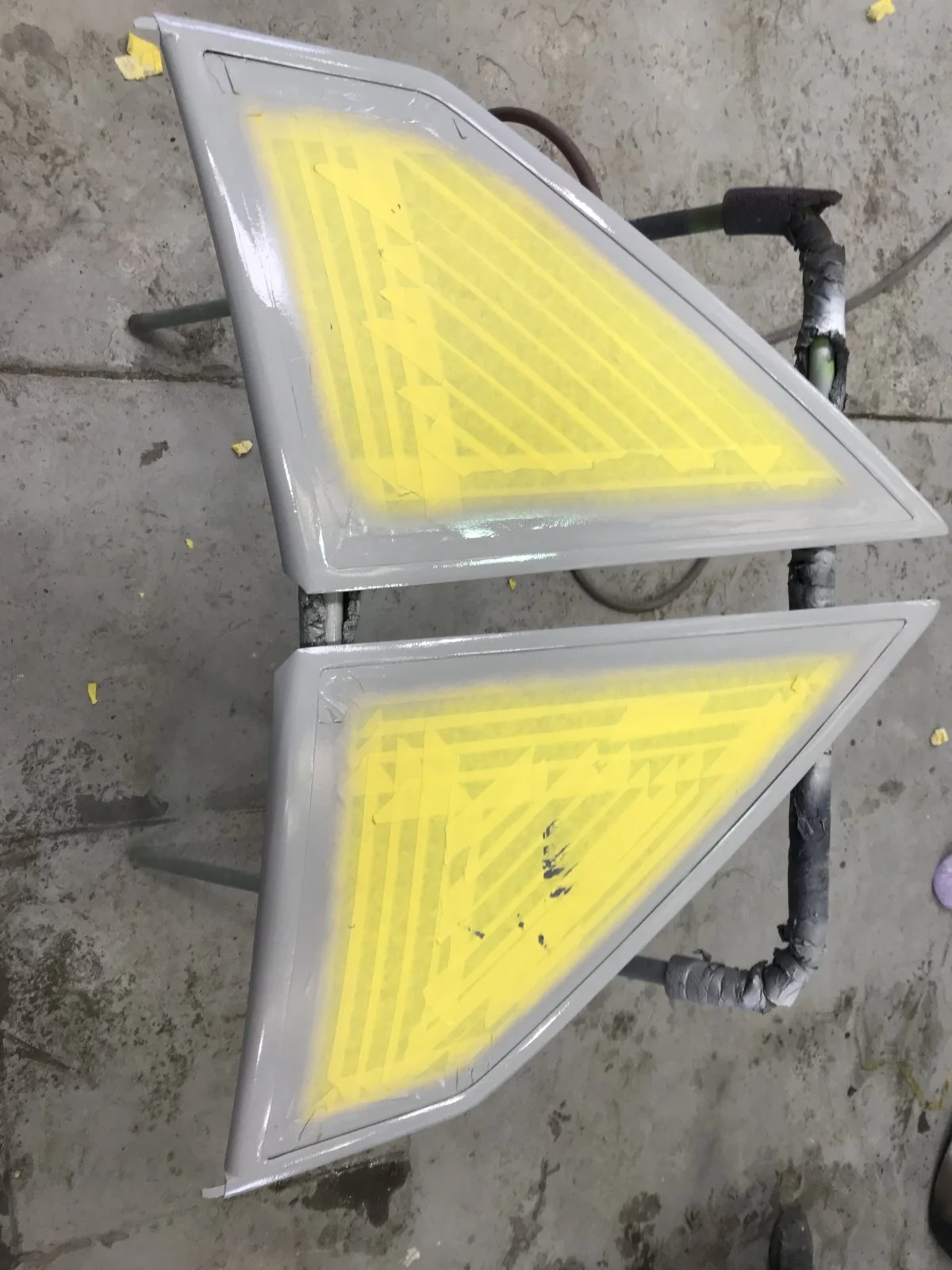

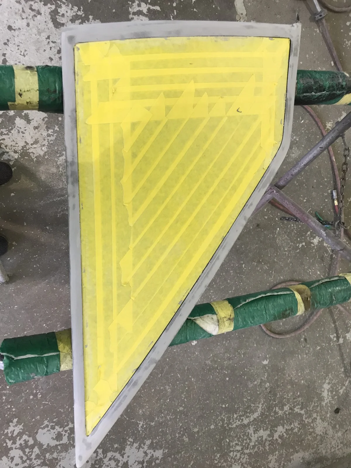

So I stayed late after work and got one of the quarter glasses sanded down. I actually think they will coming out looking pretty good. I thought I would have time to do both, but I’ll get the other one sanded in the next couple days, then a couple coats of primer, little more sanding, then paint.

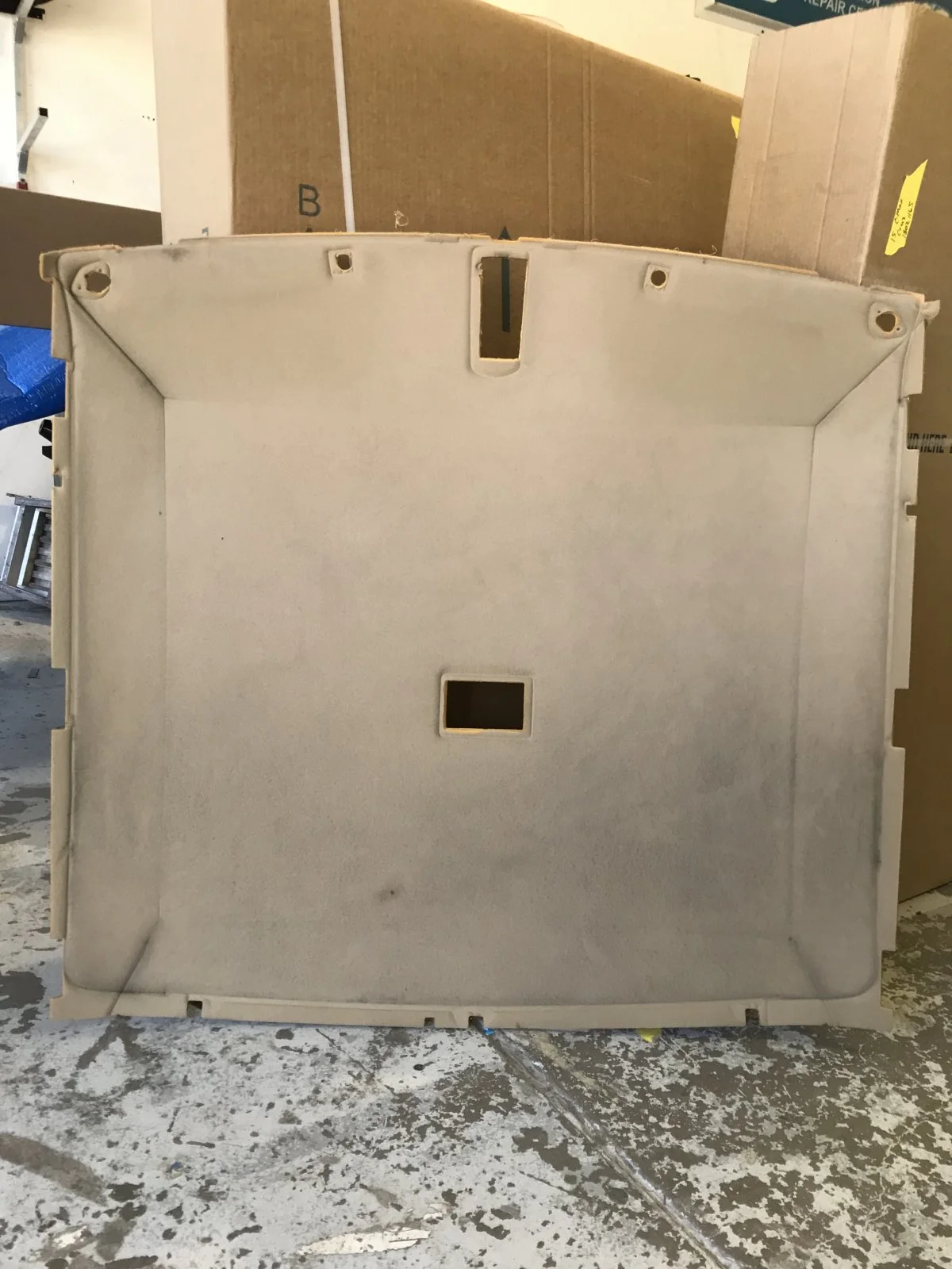

Anyone removed headliners without screwing them up? I can’t remember what material they are made out of. I’m afraid it’s that particleboard type bull:poo: that might break. If anyone has any tips let me know. Is it the same material that’s in the inside of the door trim panels? I’ve already got the quarter trim panels loosened up and I know you have to take the sunvisors and the dome light out. That’s no big deal. All I really need to do is just drop it down So we can get some PDR tools in there
They are fairly easy to remove but the little plastic clips that hold up the sides above the doors tear up the cardboard in that area. You can pop them out with a door panel tool. If the cardboard gets wet it's junk. I think lmr sell a replacement board that is pvc.
Oh, and don't forget to remove the rear view mirror first! Makes things much easier.
Thanks thief. Yeah I won’t be getting this thing wet. I’m just hoping I can get it out without breaking it. I have access to a huge assortment of clips I’m not worried about that.
Reactions: 2Blue2
The clip looks like a T and there is a small cutout in the cardboard that it fits into, I think there are only 2, one on each side but it was so long ago that I did mine. I have a sun roof car :mad: and the cardboard was junk.
Yeah I saw those, black ones right? By where your head would be? There’s only two of them? I guess the sun visors hold up the front?
Yes and the windshield trim too. The lighted visors have wire that runs through the post and can be a pain to un plug. The trim at the windshield is hard to remove also, it has to be pulled straight down, I made two L shaped pieces of metal to slide in the front and back of the trim. Pull straight down, if you slide the tools around a little you should be able to feel where to clips are, take your time and DON'T pry against the windshield.

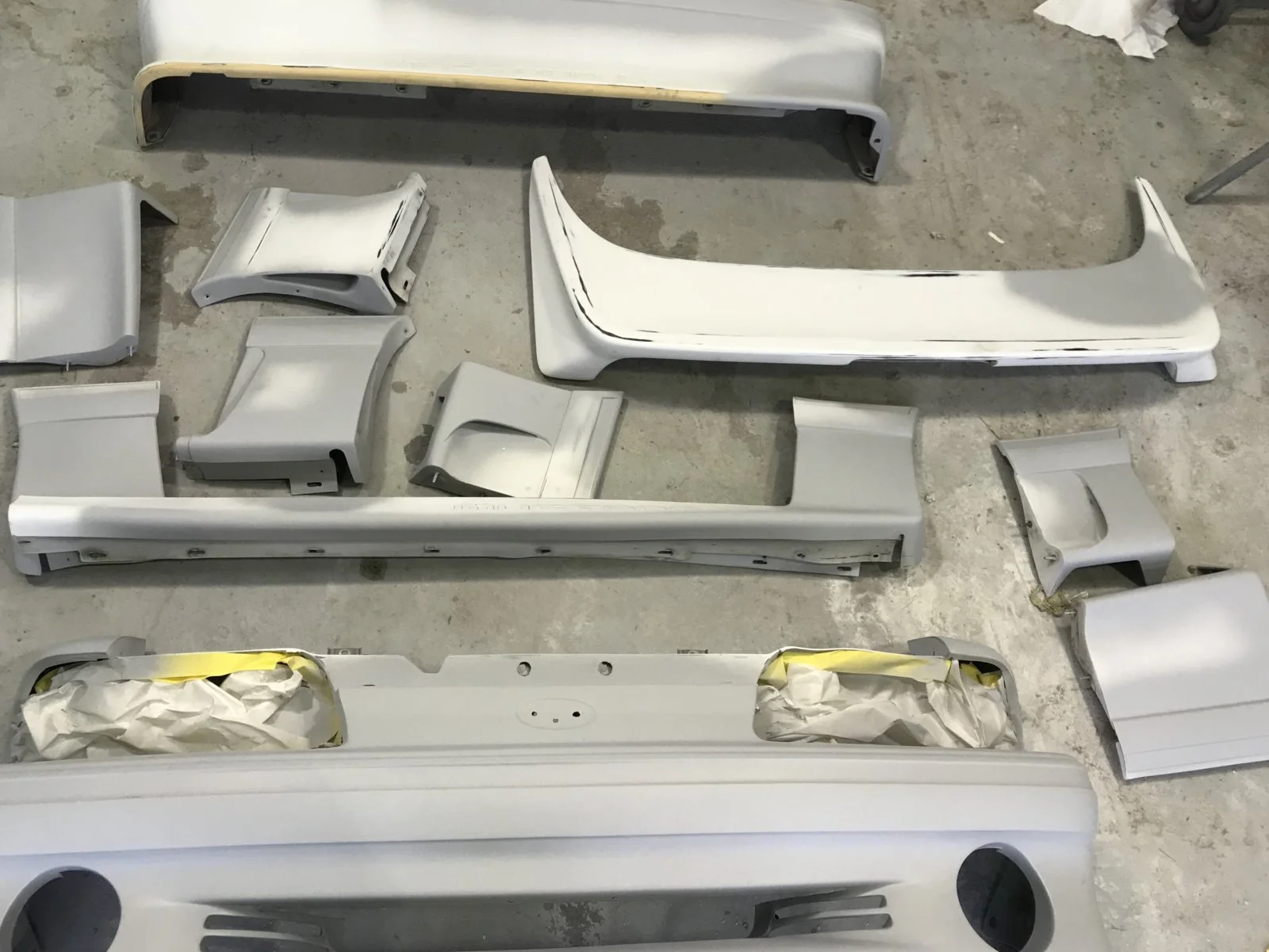

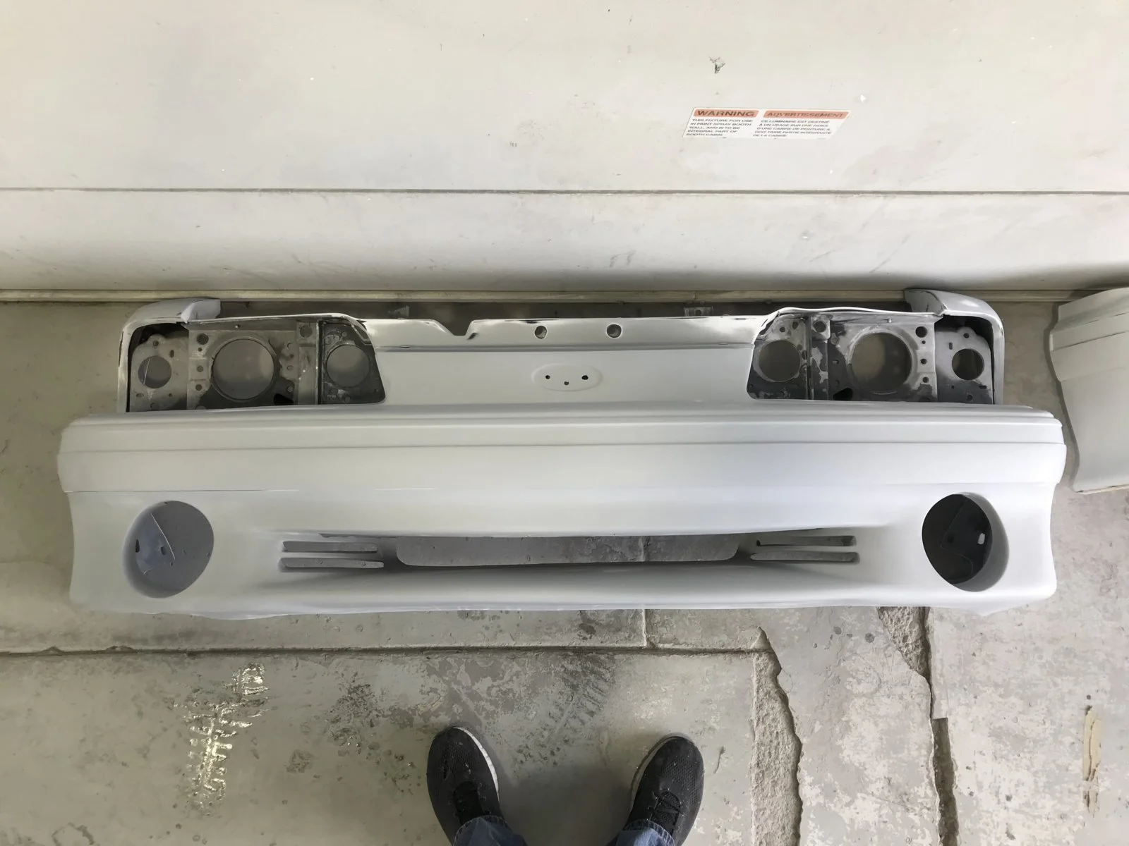

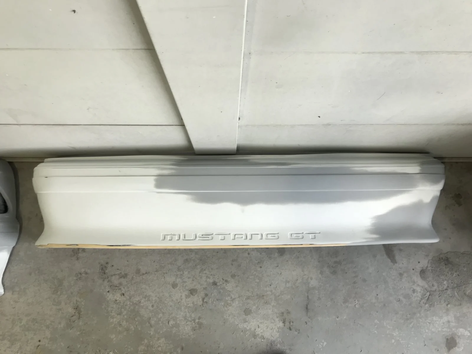

So I came in again this morning to wet sand my plastics. Bumpers, ground effects, wing and rocker moldings. I was hoping to drop that headliner down today but I gotta head home. Came in around 630 this morning. I’ll drop the headliner Monday after work so we can PDR the roof next week. All I can say is wet sanding is some tedious stuff. These are all ready for paint

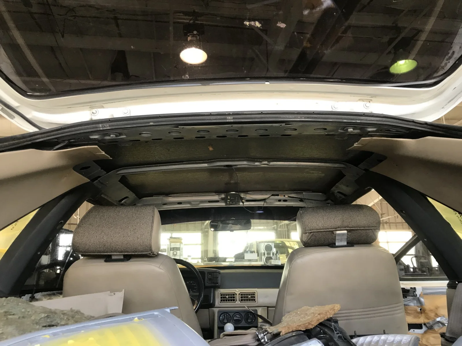

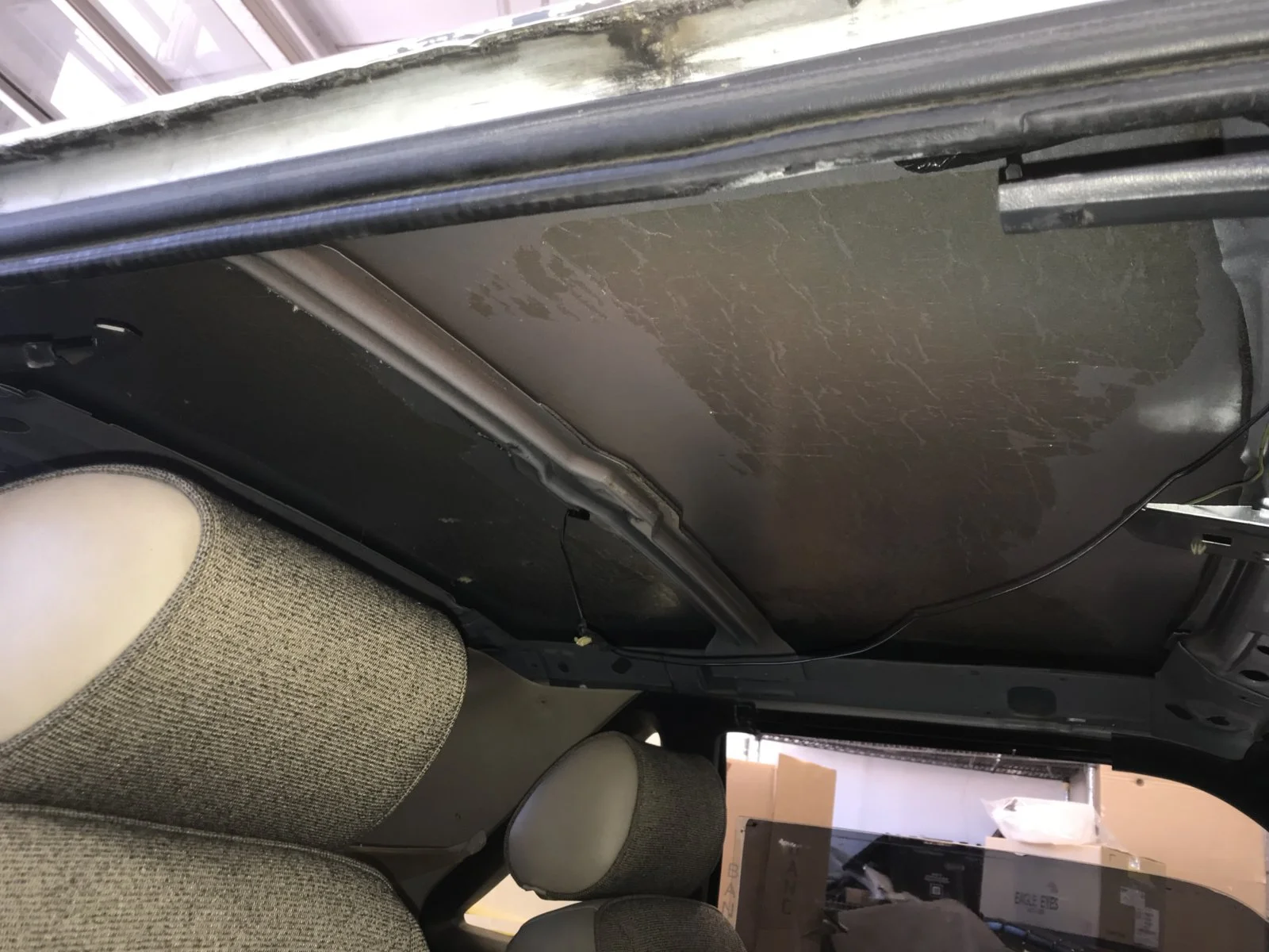

Got the headliner out for PDR work that is going to get done, should be this week. Really wasn’t that bad. The two pieces of insulation underneath each came out in one piece, pretty much. I already had the rear quarter trims loosened up and just had to drop the sun visors and lamps. Not too messy either. My headliner really isn’t that dirty. Looks like :poo: in the pic. Lighting maybe. Or maybe it is just dirty!
