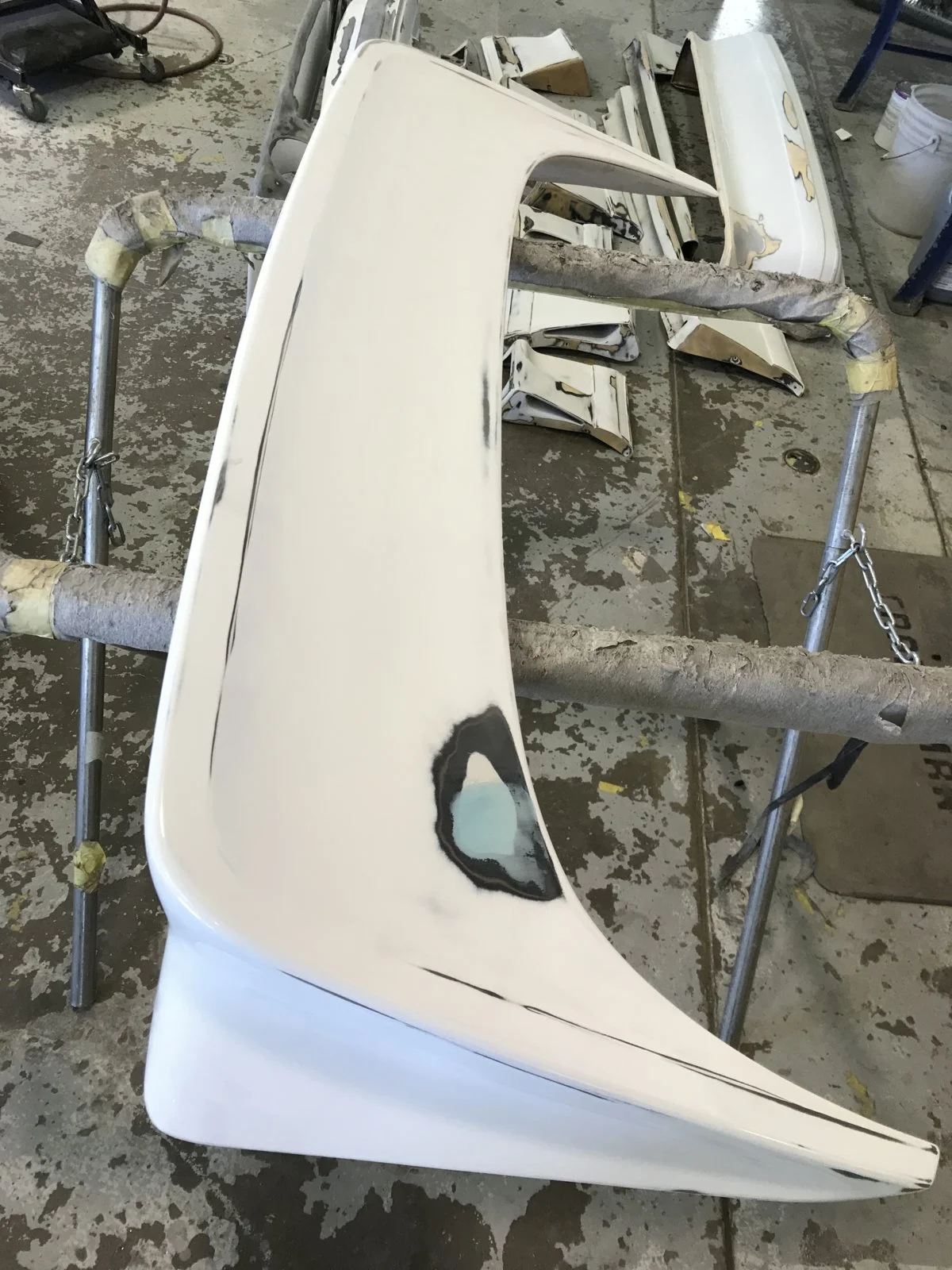

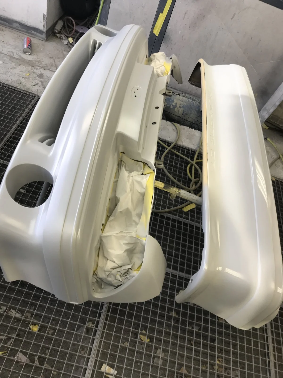

The black on the hood is guide coat. I had a few small waves in the hood that will block out with the amount of primer on the hood.
I’ll let this sit for a week or so before I block it.
