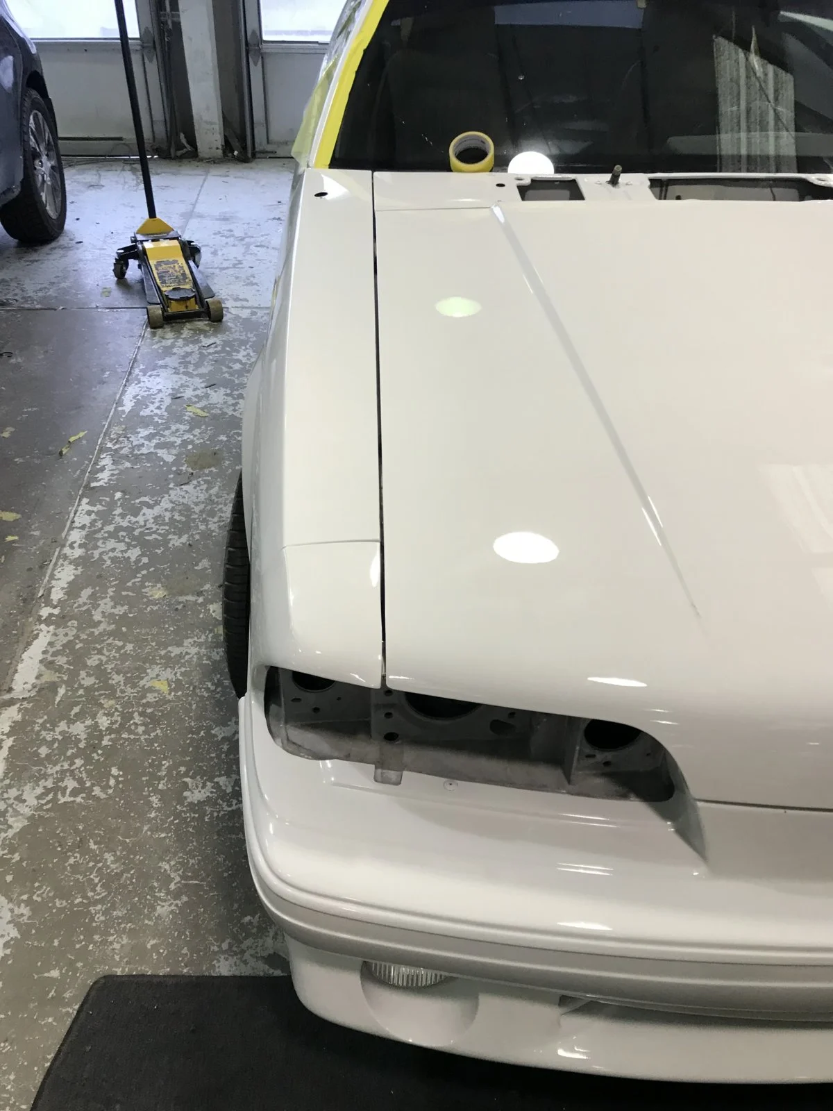

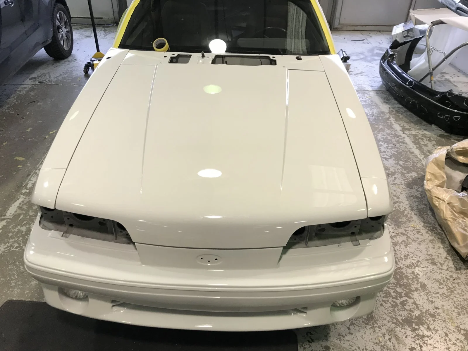

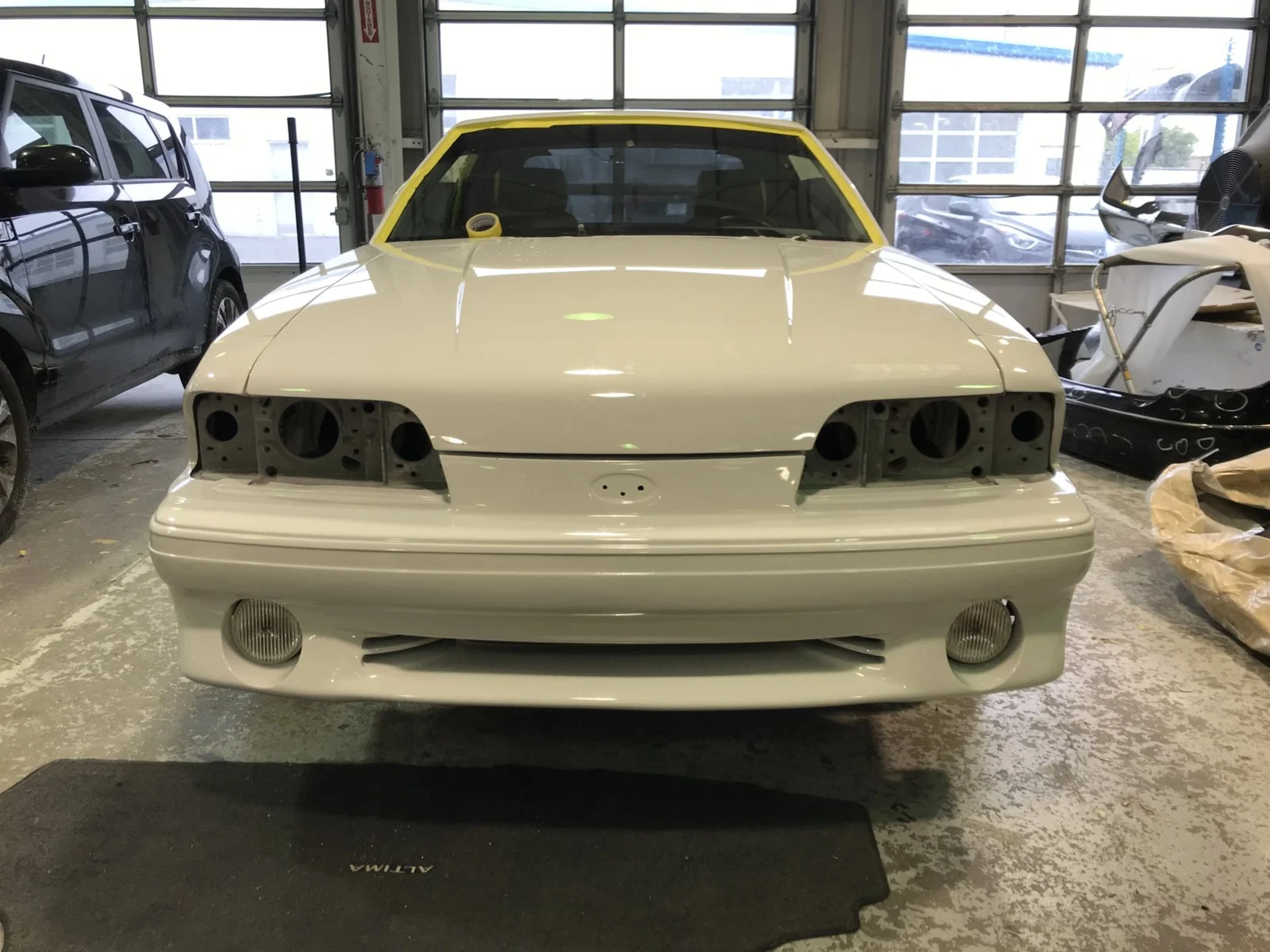

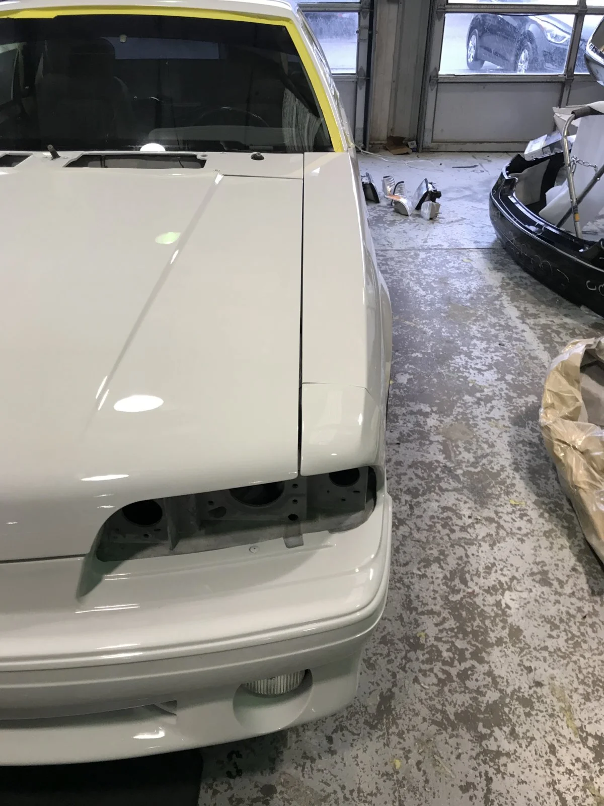

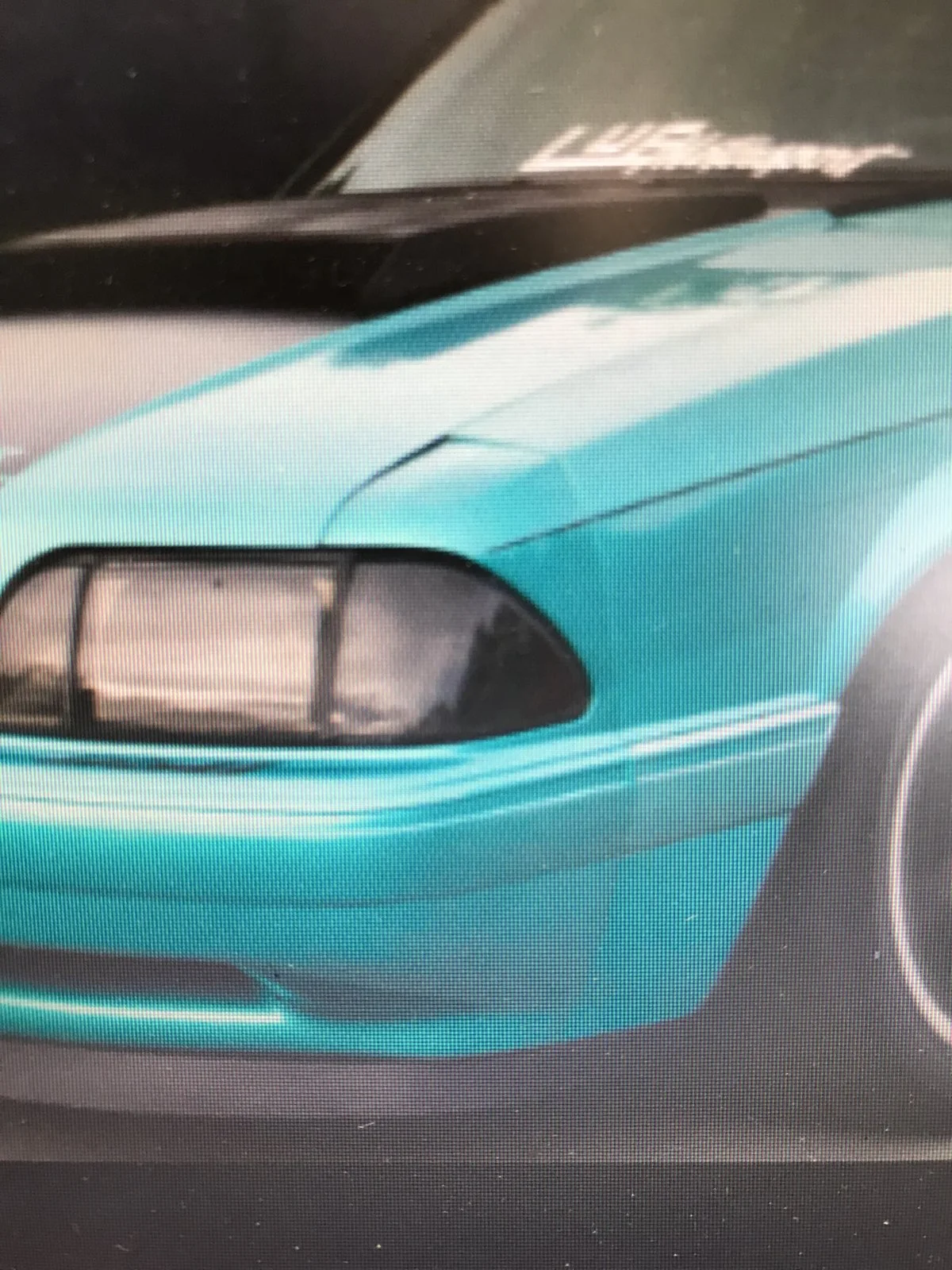

The front of your hood looks like the whole thing needs to go towards the passengers side about 1/4 to a 1/2"".
The bumper is aftermarket?
Aftermarket pieces are really a pot shoot Blake. Sometimes they’re dead on, other times, not so much.
With it riveted to the header panel there really isn’t a bunch you can do.
Let me think on it.

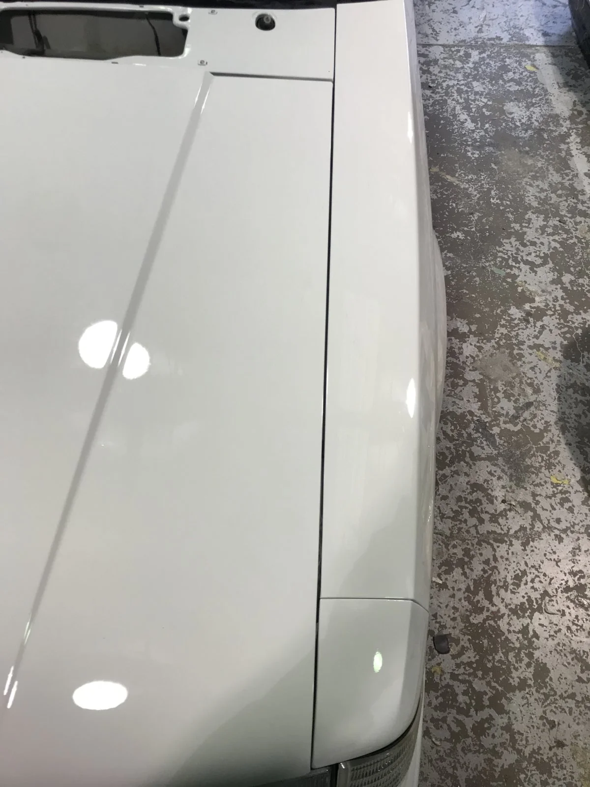

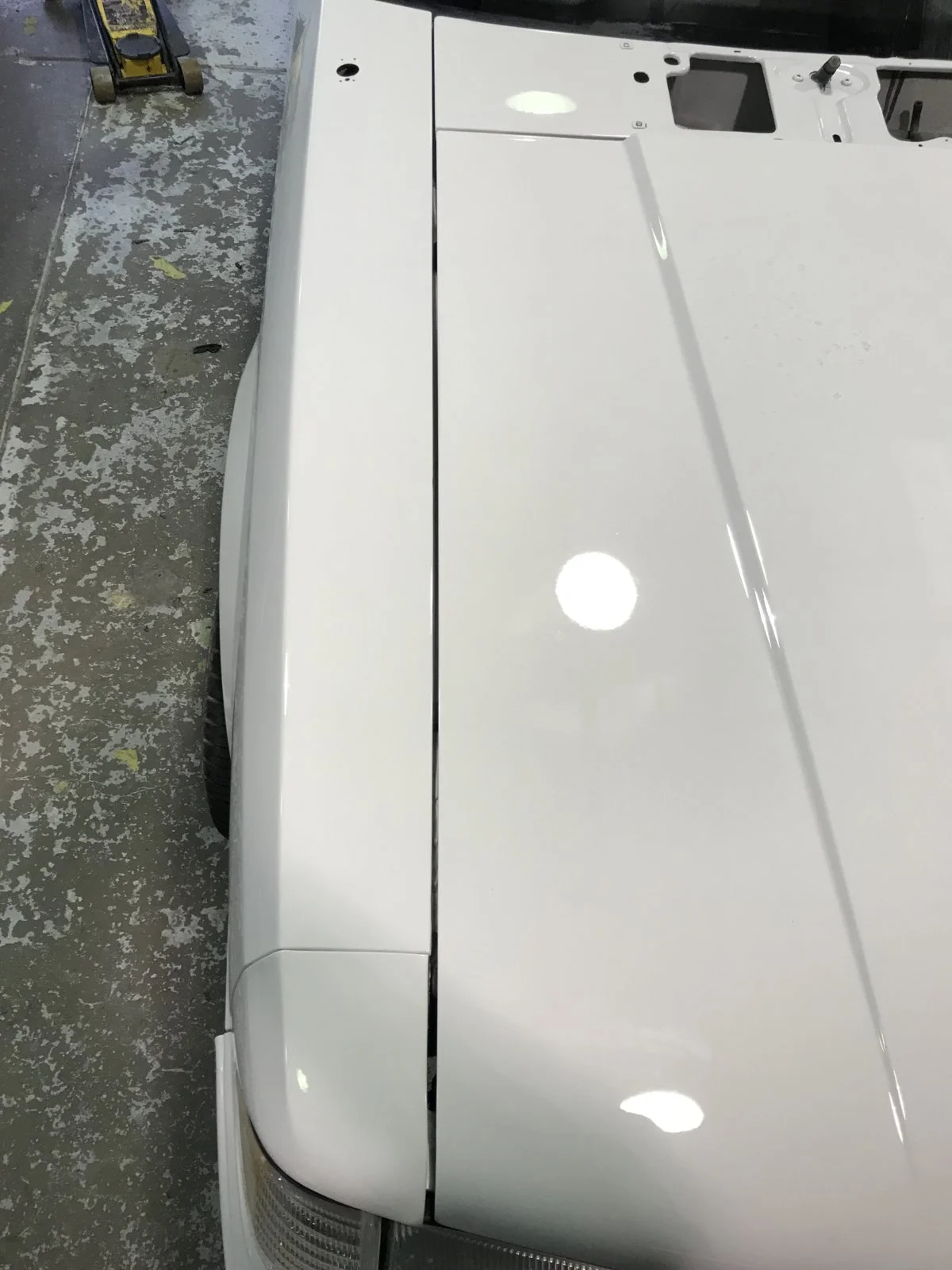

Are the fender extensions are factory?They don't fit very well from the looks of things. That driver side extension needs some adjustment. And it needs to twist. And that pass side one is just wonky.
Are the fenders adjusted properly?
If one is in too tight, (pass side) and the other is adjusted too far outward, that could be contribution to the offset.

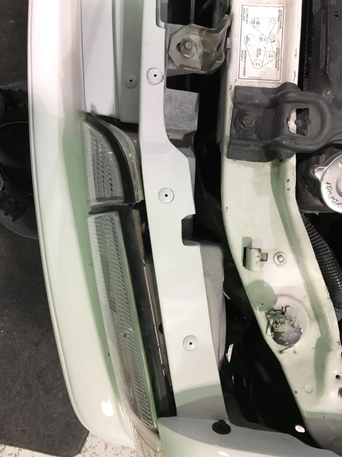

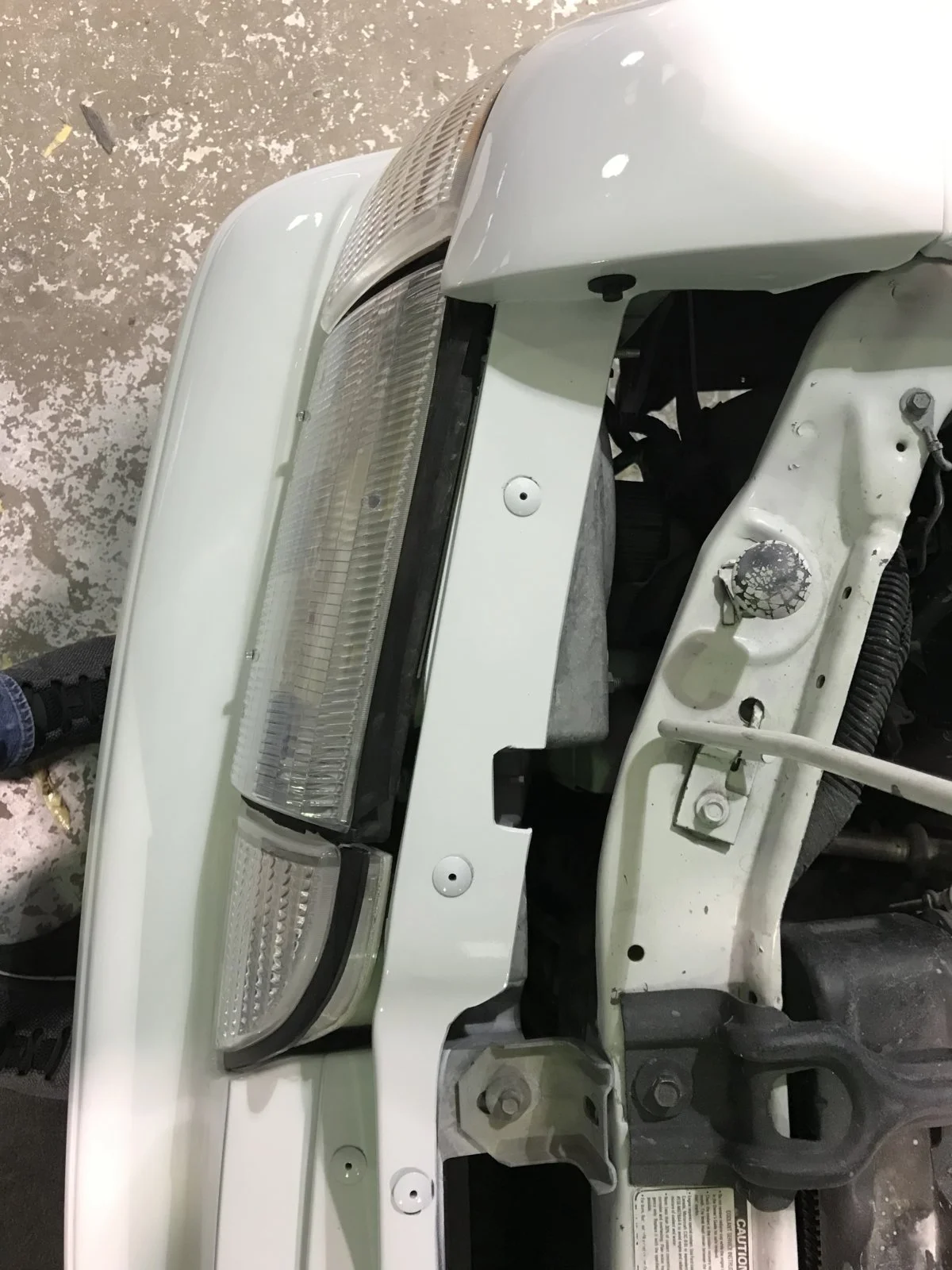

is made. You can see how square my hood, fender and cowl gaps are. It’s just right there in the upper parts of that bumper cover.
The hood and fenders are adjusted properly. When we pulled the rad support and aprons we had used a tram gauge, measured everything out and it was all square and in place. The tops of the bumper cover above the park lights is really hard to adjust, actually, there is no adjustment there at all. Im going to have one of the bodymen look at it this morning and see what he thinks, but I think I’ll have to search for a replacement cover.
On several cars I've been able to shift the metal bracket that pinches the bumper cover to the front of the fender. Loosening the nuts up so the plastic just drags between the helps get it accurate. I've had to open up the holes in the plastic a couple times.
If the rivets are off, usually, the plastic between the corner and first verticle rivet will bow.
