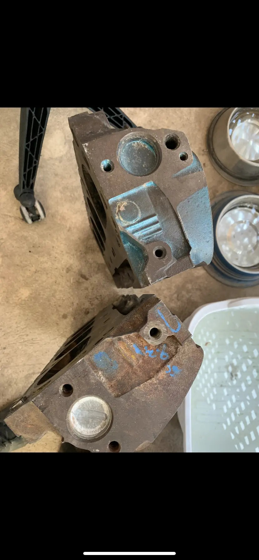

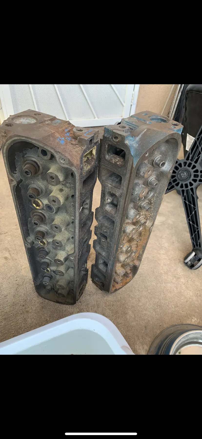

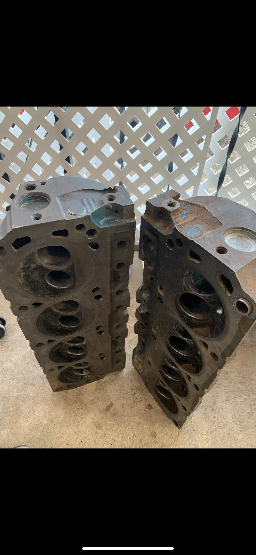

I found these. 3 bar. What do you guys think? They are missing some stuff.

How much were they asking?
I’d pass on those. By the time you go through them, rebuild them, valve job, new springs and such, you probsbly could just spend a little more and get a decent set of AL heads.
$80. Yeah Mike, that’s what I was thinking. How much more would it be for a new set of aluminum heads. Just trying to keep this somewhat inexpensive.
$80 not bad, but you’ll spend a lot going through them. I did sell a set of GT40Ps not too long ago conplete for $40. Even that was tough to get a buyer.
