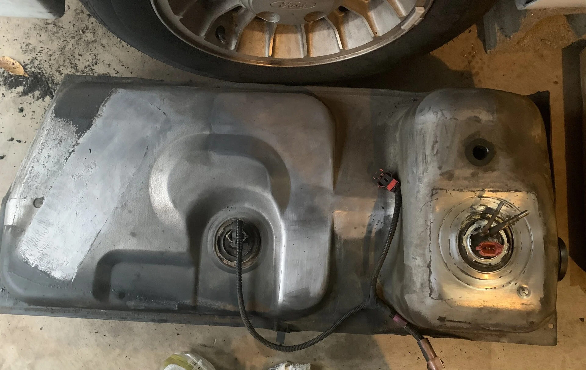

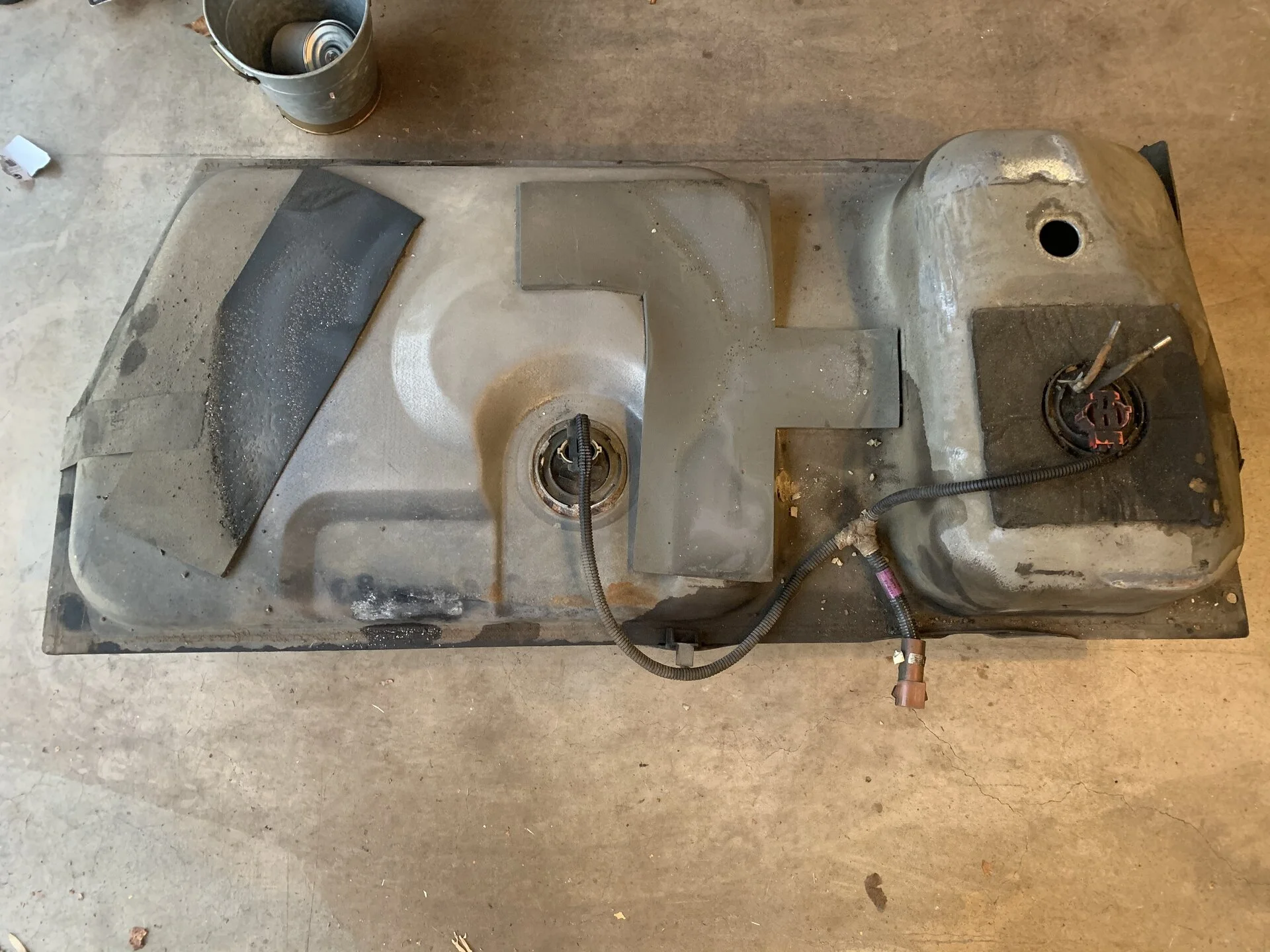

Made a little bit of progress on cleaning the fuel tank and the old pad residue.
Before
Now

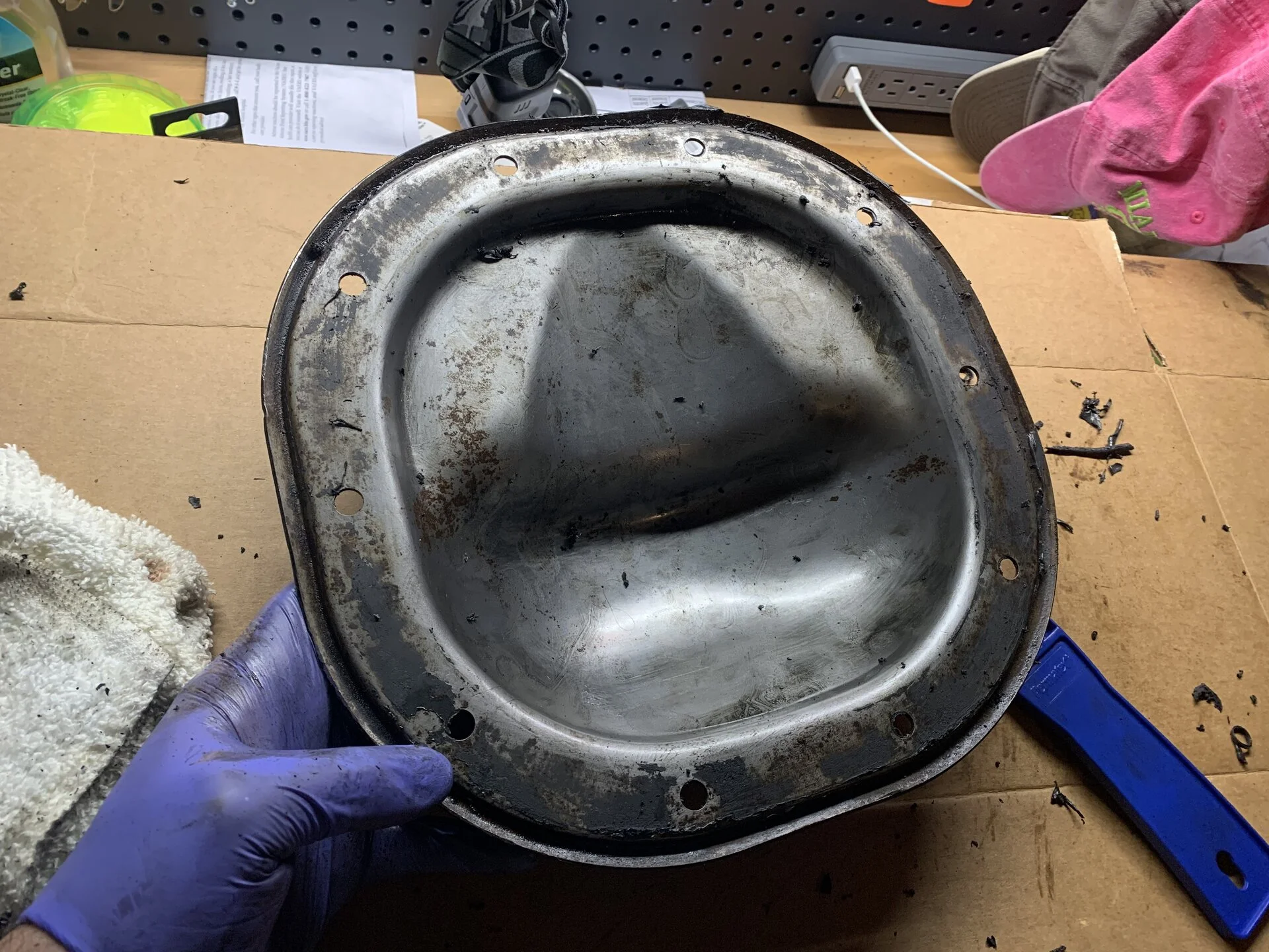

Drained the old diff fluid last night and started working on cleaning the old gasket material off.
Cleaning the material off the diff cover itself was a long process and I eventually had to stop and get some dinner before bed. Hoping to finish and get the diff cover back on and fluid added tonight. Man, it can’t be stated enough how bad the diff fluid stinks.

When I converted to rear disc last winter I seriously considered getting a diff cover with drain / fill plugs,
but decided to spend money elsewhere.
As I was cleaning the diff cover last night, I was thinking the exact same thing...but just because of the short term benefit of not having to scrape off gasket residue, lol.

Having changed my diff fluid after installing such a cover...you folks have no idea what you are missing out on. So much cleaner/easier.

To clean those covers up I use a wire wheel or a nyloc disc on a drill. Cleans it up down to fresh shiny metal quickly.

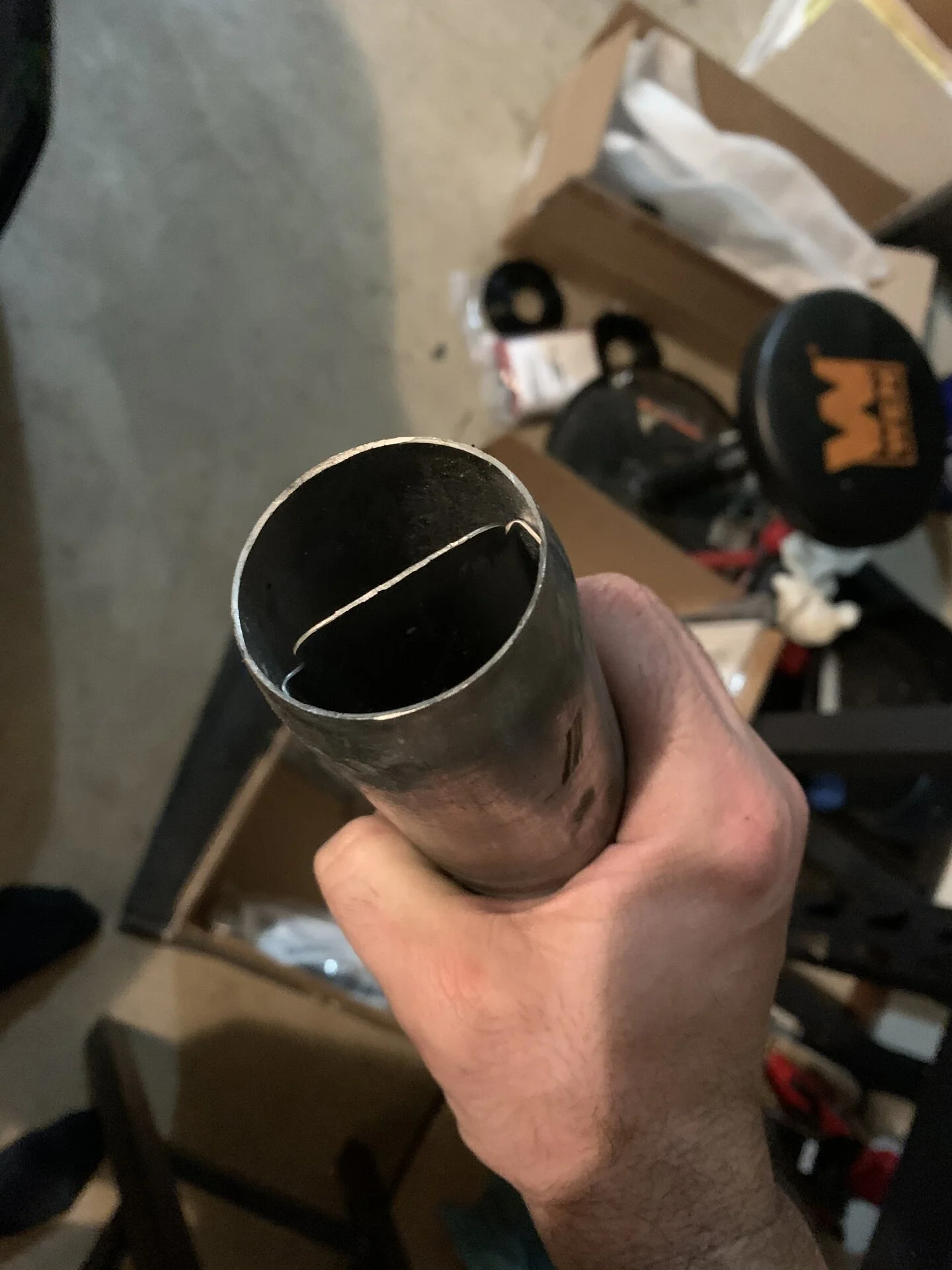

The filler tube has a sort of a baffle, for lack of a better word, in it. Maybe that got bent and is slowing the flow?
Are you talking about this?
The one on the new filler neck looked fine before I installed it but I could try to pull it out again to double check.

DudeStang said:
I felt pretty confident I fully seated the lock ring. No leaking other than the initial leak from putting gas in. The tank had maybe a gallon or two in it and I only put another gallon in. I wanted to get the the car back to the house to see if I could figure out what is wrong.
Yes, that’s the piece I was referring to.
