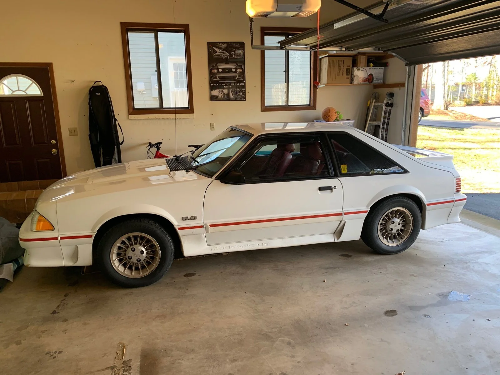

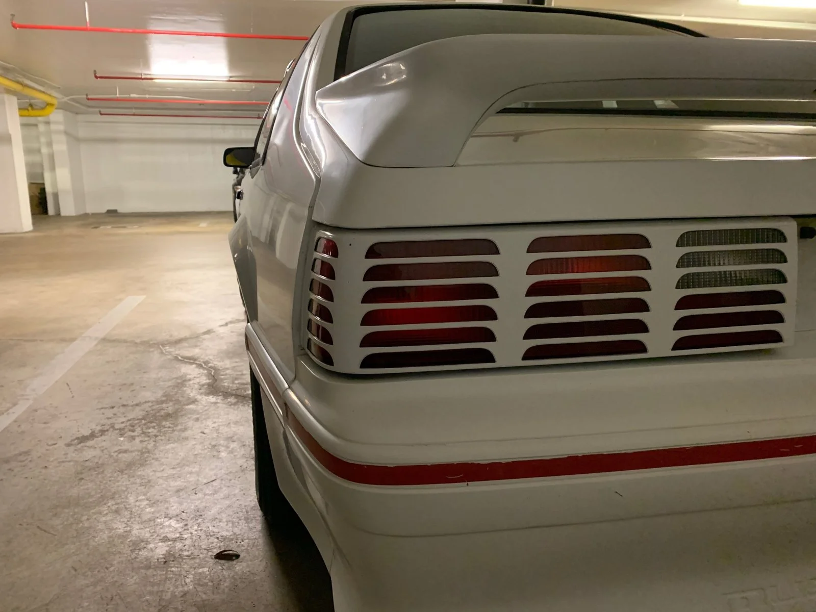

I've wanted a fox body for a long time. The first Mustang I ever rode in was a fox body. The first Mustang I ever drove was a fox body. I’ve been a huge fan of these cars since I was a teenager and always wanted to own one. I also wanted a project car that I could tinker with and build up and mod and learn on.
I spent the past few weeks trying to track down a reasonably priced fox body. I negotiated a sale on a 1988 GT but at the last minute the seller decided he wanted to keep the car. I tried to buy a 1990 LX and again the seller decided he was going to keep the car. I tried to buy a 1992 GT and basically told the seller I would pay asking price and then he stopped responding to my emails.

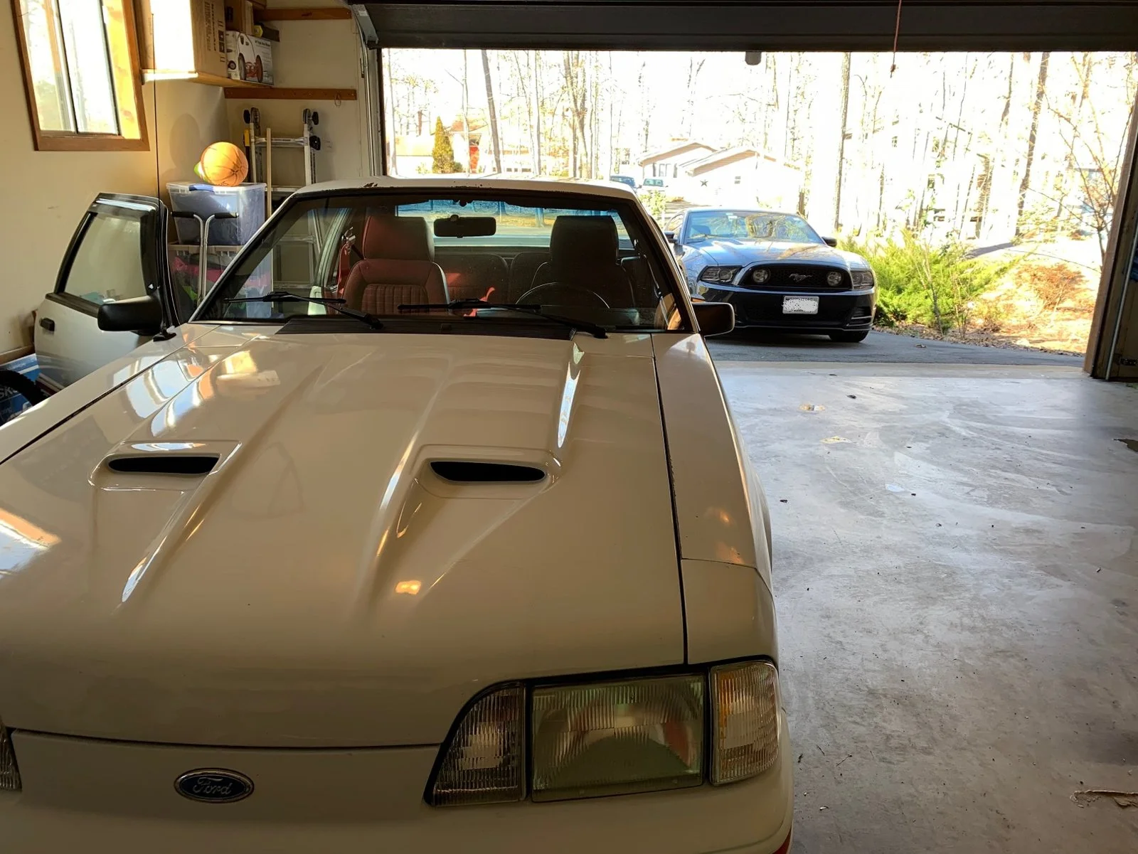

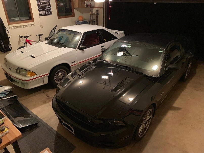

Convinced the universe was conspiring against me, I was about to take a break for a while but came across a couple more options. I checked out this 1988 GT and made an offer a couple of weeks ago. Finally picked the car up last weekend. She definitely needs some work but she runs strong and is a lot of fun to drive. Looks good in the garage next to my 2014 GT.

Driving the 2014 is definitely a different experience than the 88 but I have to say, I've been really impressed with the low end or "off the line" feel of the 88. Maybe its seat of the pants, or the fact that the 88 is a lot lighter, or a combination, but it was pretty surprising. My 2014 is a six speed with factory 3.31s and most of my modifications are in the suspension but it's plenty fun even with stock horsepower. :D

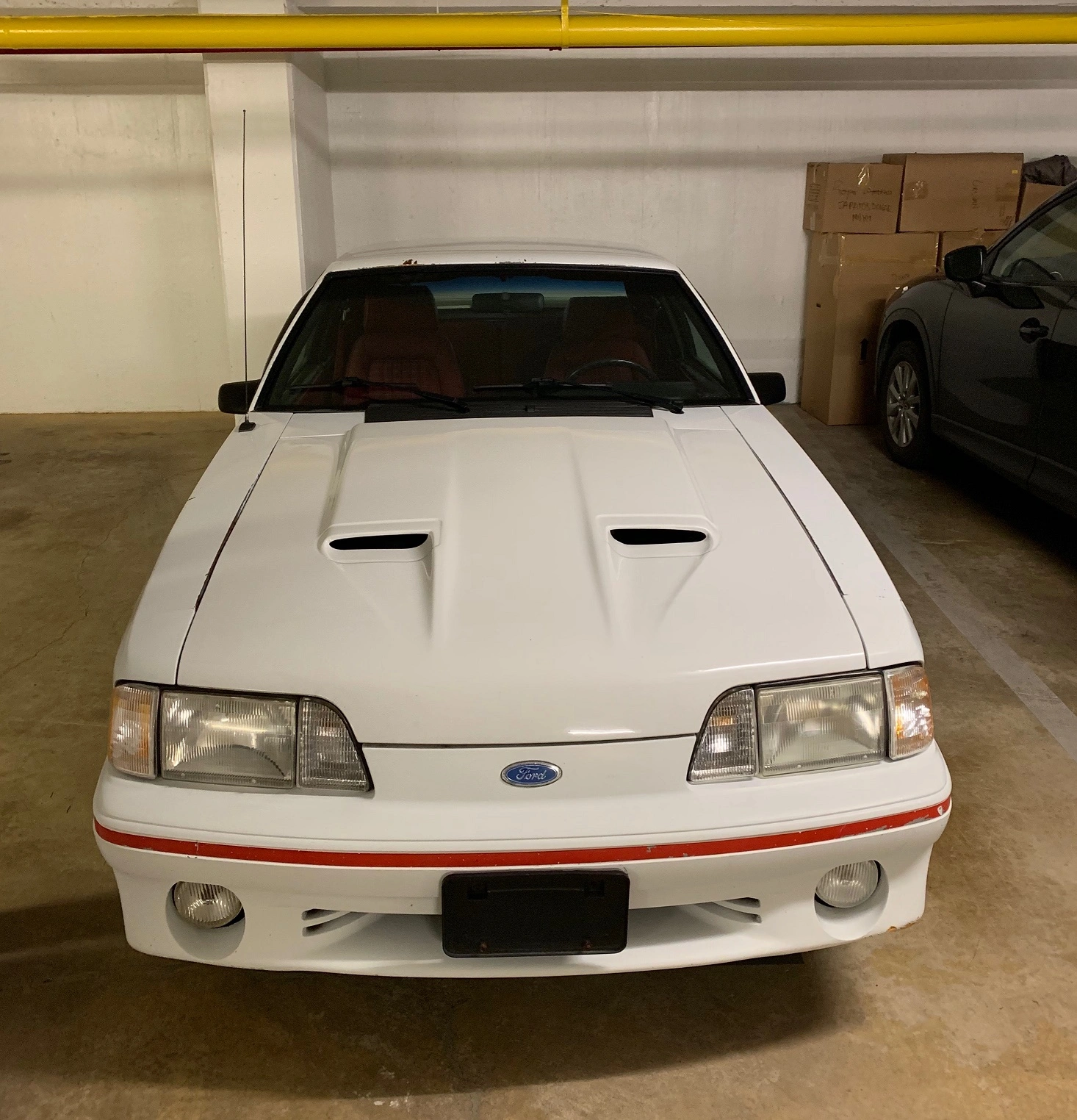

Good car. I wish I had that hood my favorite aftermarket style. Looks like the paint is good . Nobody ever says how much they paid for these good ones.
To be honest, I didn't love the hood at first but its been growing on me.
The paint seems to be OK for the most part but there are some spots I need to get painted over. I'll probably do what I can with a touch up pen at first but eventually the car will need either a full repaint or some sort of professional touch up.
Without getting too specific, I'll just say I got this one for under $6k. The other ones that I tried to buy were in the same price range. There seems to be a surprising amount of decent (but definitely not perfect) fox bodies for $5000-$7000 but they are typically pretty high mileage and need work. For the lower mileage ones that have been garaged and babied or restored, the prices seem to jump to at least $12-13k. Some of those ones, in that range and higher, are unreal. I couldn't believe how good of condition a lot of those cars are. I had to make myself stop looking at them on the car sales apps. :eek:

Let's see under the hood. Is it still speed density?
'88's are a transition year, MAF's were California, only.
Wheels are 15's, stock tire size (225-60x15) will rub the fender skits at full lock.
I still have the original turbine wheels as spares; they are impossible to clean.
Not too many GT's with the red interior, almost all were gray..
'88 seats are fully articulated with lumbar support.
I think they changed the seats in '90 when the air bag was introduced.
Your steering wheels tilts, air bag ones do not.

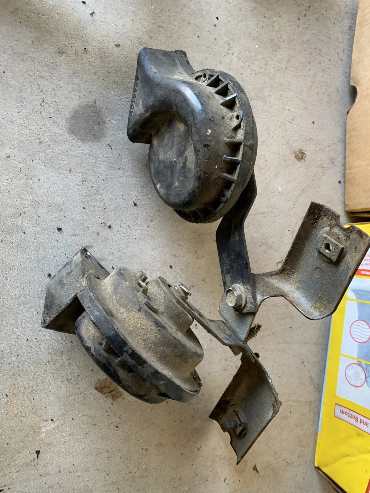

I’ve run into my first issue - the horn doesn’t work. In order to get my Virginia state safety inspection it seems I have to have a functioning horn. I have what appears to be the factory horn in a box of spare parts I got from the previous owner but I’m not sure it’s got everything I need so I will have to do some reading and see what I can find out.
Take a quick look under each front corner of the car to see if there’s a wire hanging. Only one wire goes to each horn. Maybe you’ll be lucky and the wire is there, and it works when connected.
