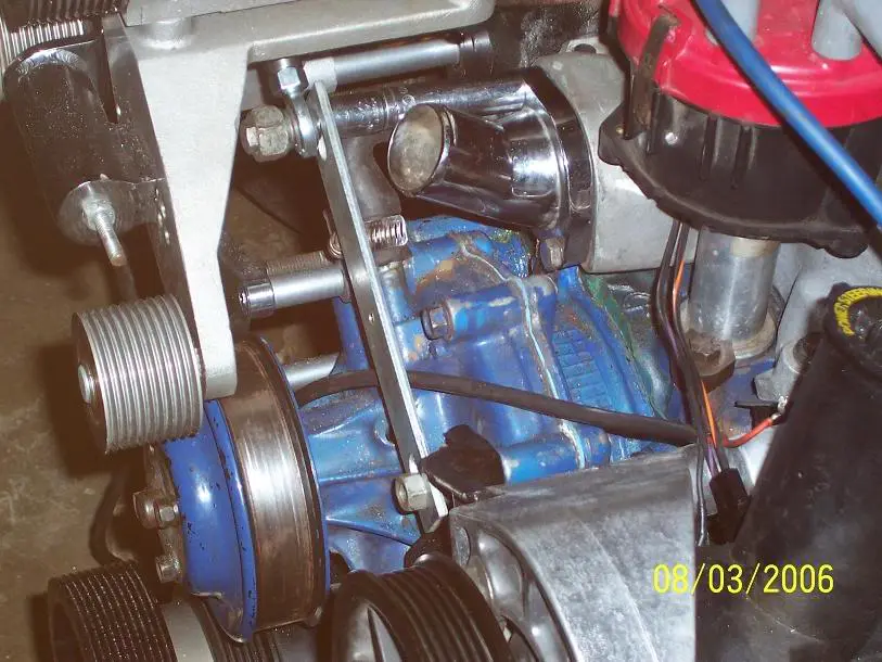

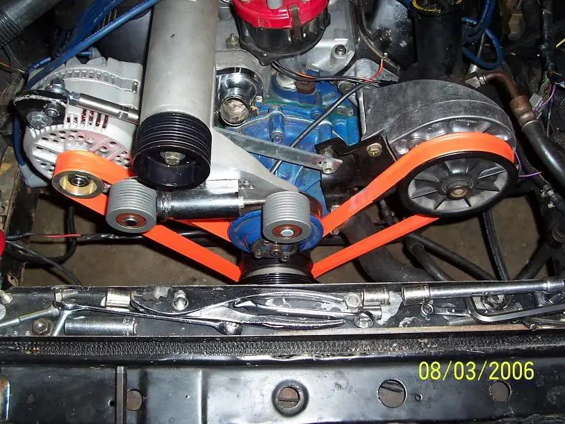

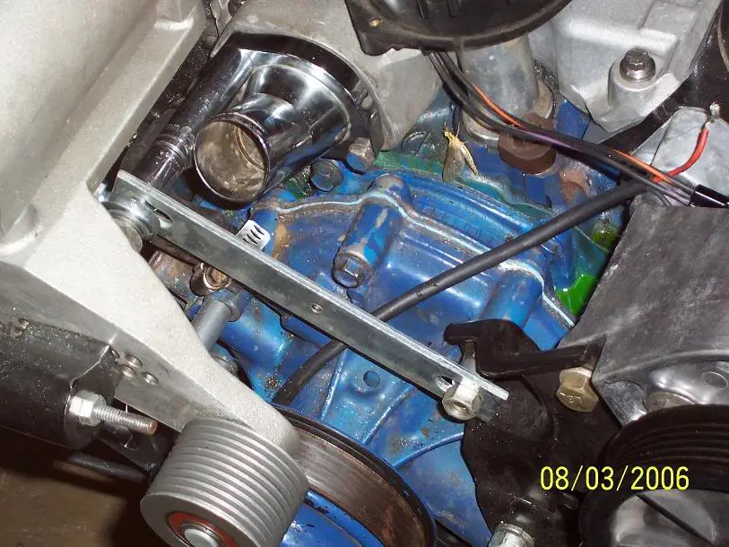

Finally, my blower install
too many problems. i got the alternator braket and it didnt work because the blower shaft is in the way and also my 3G alt is way too big. so i had to make some crazy bracketry and i still dont think its gonna work.

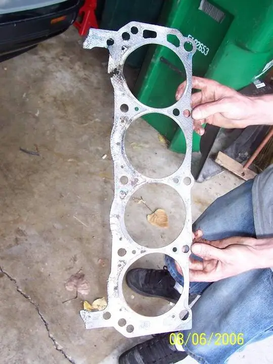

me and my buddy chad took it out for a cruise. we stopped in a parking lot and a few other people i knew showed up, we hung out for a while. i went to take it for another drive and got next to this old dodge i think it said swinger on the side. he gave it all he had and i didnt even bother to get on it. we pull up to the next light and i give it about 1/4 throttle, he doesnt go. then the last light we start going, i gave him the hit and i waited till 2500 then gave it 3/4 throttle and gained 3 cars by 4500 and let off. so sweet!! :hail2:
then later i pulled next to some (black) guys in an old caprice with 22s on it, did the same thing to him :p i love f-ing with people. he told me to pull over cuz he wanted to talk to me. im going to put a carb and some valve covers on his car for $350.

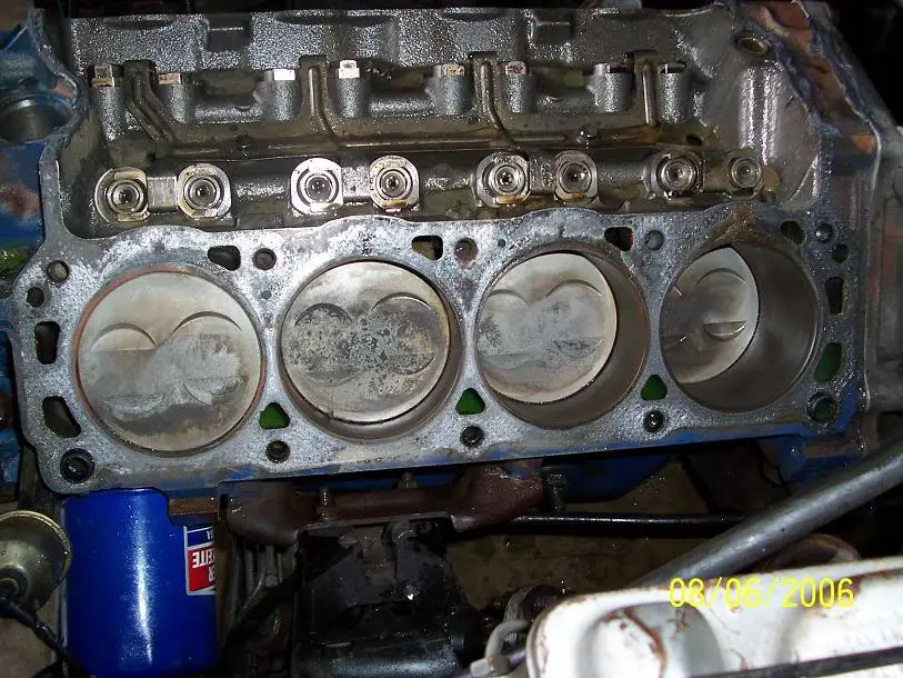

but anyway when we were on our way back to my house (at this point i still hadnt got on it thru all the gears) i opened it up all the way and :eek: high 11s i tell you!! but near the top of third gear BOOMPH!!! anitfreeze all over the place, my windshield is covered, ad i had the t-tops off so i got soaked too. I go to stop and see what happened and the car died. once i got it stopped i found the lower radiator hose blew off, so i think... eh easy fix. after that gets done i turn it back on and its running like total *****. so i go about 1/4 mile to the next gas station to get some water. steam was coming out of the breather and the oil was all milky :( blown headgasket
i poured in 2 gallons and try to start it again with the cap off the radiator so i can see the motor suck it down and i can add more water. well when i cranked it water shot out of the radiator about 2 feet, and it surged with every compression stroke. must have been re-using old head bolts that did it. im gonna get some arp head studs and hopefully have it running again next week.
grey5.0beast said:
where's your fan? Anyway, that sux bro, get it running and if u have to, blow it up at the track and get a sweet vid while your at it... j/k
in front of the radiator. i meant to bring the camera with me and take a vid but i was too anxious to get it on the road.
oh i forgot to to mention i had to get it towed a whole 1.7 miles!! and it cost $100!!
all 8 cylinders were blown out and a couple of the heads bolts were loose :eek: the lifter valley was full of gasket material and all the plugs were covered with it too.
other than that nothing was really damaged.
