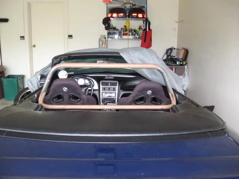

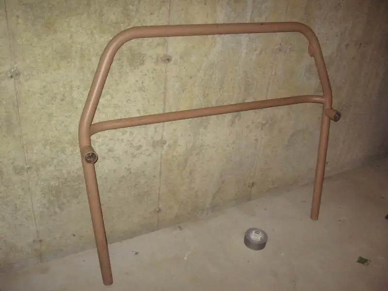

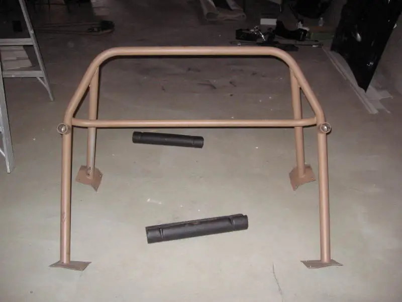

I bought a 6pt MM roll bar from a guy in jersey almost two years ago and I finally started to work on it. The bar is for a coupe and I need to make it fit into my vert, so I need to shorten the main hoop by at least 2". I'm also going to have a tonneau cover over the rear seat so the rear bars are going to need to attach to the main hoop at a lower point. I'm still unsure if I'm going to use the front side bars. The only way I'll use them is if I can make them easily removable. This bar IS NOT going to be NHRA legal. It's main purpose is for show and to pass tech inspection at tracks with loose standards.

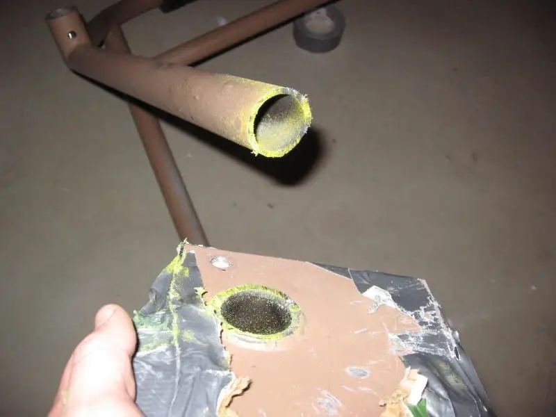

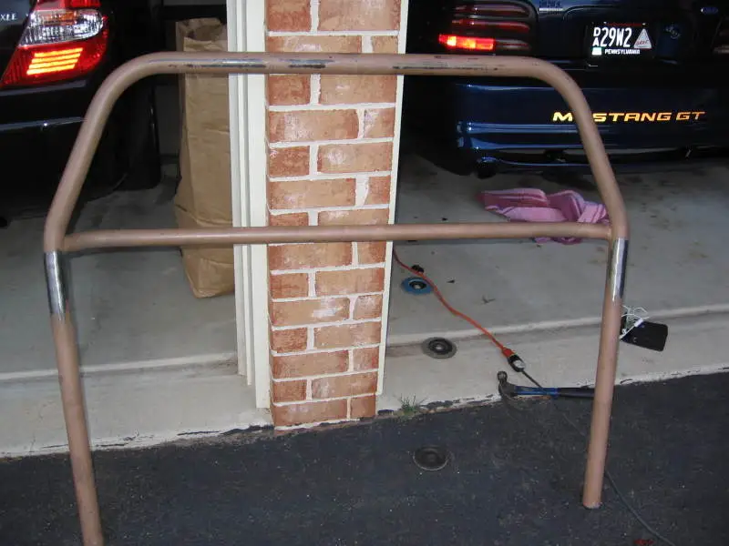

So today I cut plates off of the main hoop....

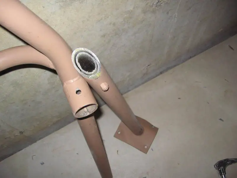

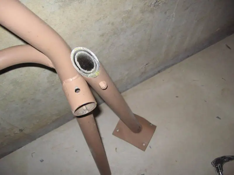

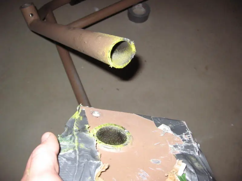

I also cut the rear bars off which were a PITA to get through, here's why...

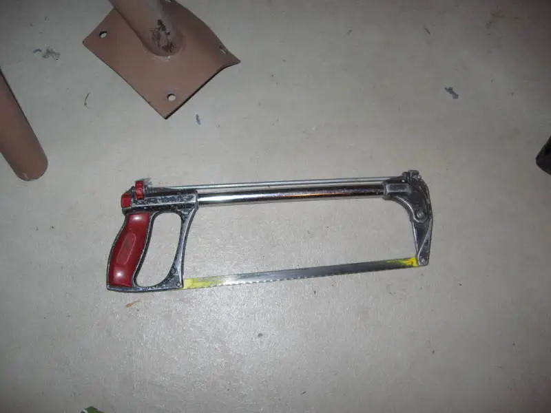

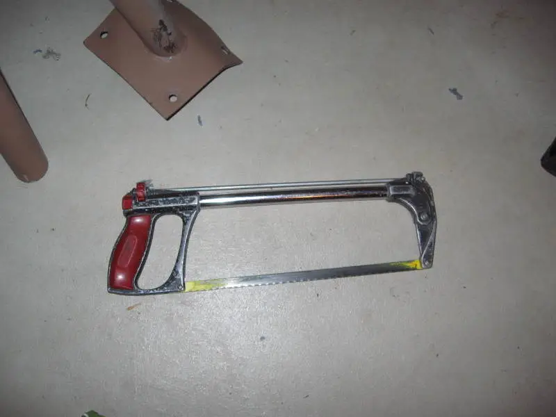

Here's the other reason, I did it all with a hacksaw...

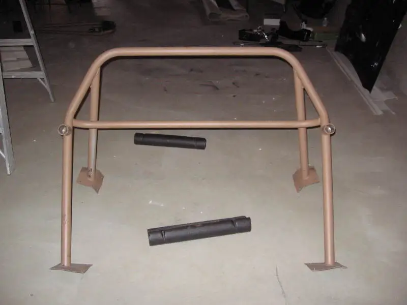

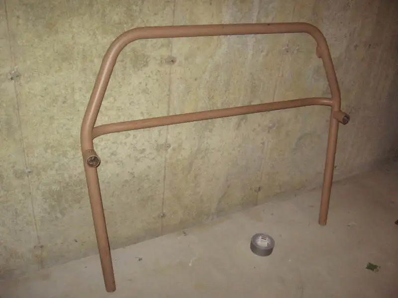

So now I have the main hoop serperated...

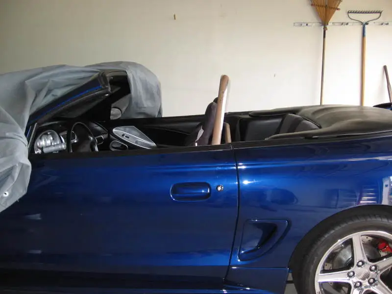

Also, instead of cutting 2" off of the hoop, I'd try and put a very slight bend in it right after the hoop passes the rear seat bottom. Bend it towards the rear of the car and when the roof is up it will match the side window line much better. Mine will be done this way as soon as I get my new seats and get it to the chassis shop.
Yeah I had the main hoop in the car last week and noticed it looked a lot better leaning slightly to rear as opposed to straight up. I think I'll still have to cut an 1" off but I'll definitely lean it back a bit. I'm gonna try to be there as my guy is doing all the work so that it will come out exactly the way I want it.

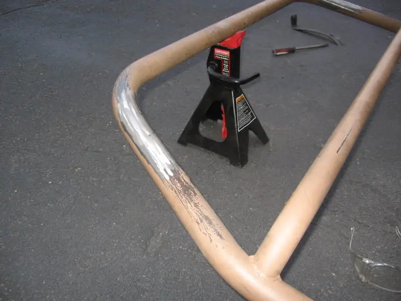

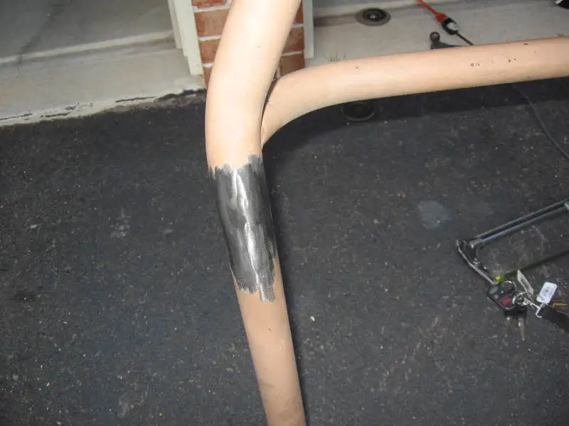

I decided I'm definitely bolting in the roll bar and not welding it in; at least not now. Spent some time yesterday sanding the old welds down and cut 1" off the main hoop. Here's some pics of how the main hoop will be angled.
I drilled the floor boards for the mounting plates and this week I'll bend(beat) them to conform to the floor. Next weekend I'll hopefully have the rear bars bent and have everything welded together. I'm going to the track on the 13th so it will probably get bolted in unpainted for the track and then I'll have it painted the following weekend.
