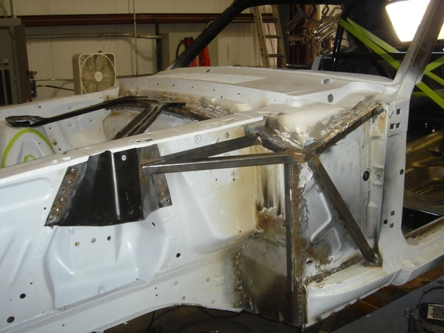

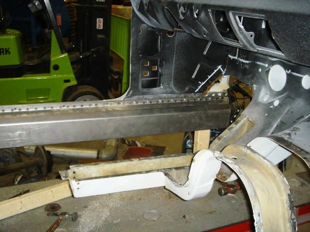

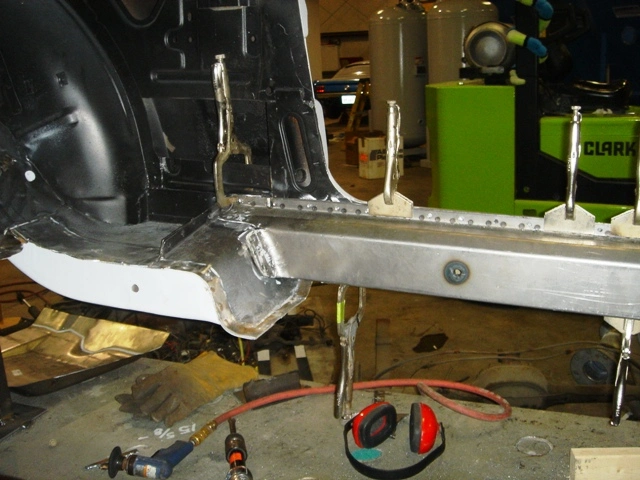

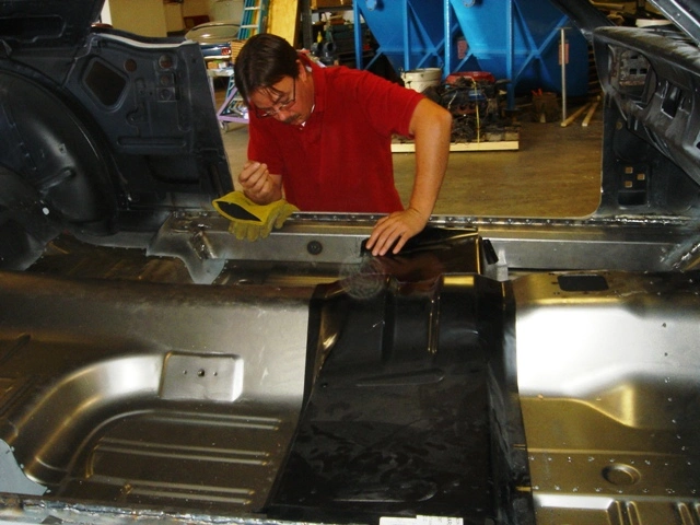

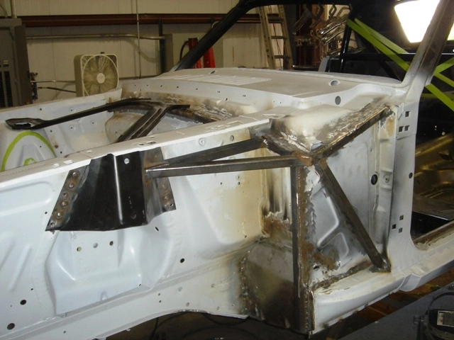

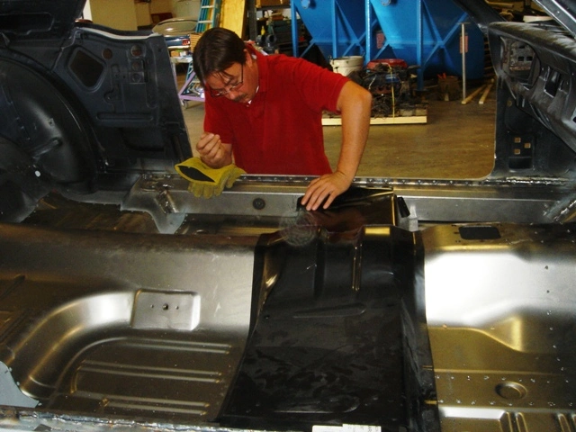

So far we have reduced torsional deflection by 70% and we still have a few items to complete.
Here is a link showing all the mods made to date.
http://sn65.com/Fire%20&%20Ice%20unibody%20reinforcement.htm
Here are some photos showing the rocker, floor pan mods
Here is a photo showing the cowl, firewall, shock tower reinforcements.
We need to add the final shock tower brace and weld the floor to the rockers before we can take our final "test". After that, we can add the cage and see just how much we gain at that point.
Also, we are working on a modified Monty Carlo bar that not only helps maintain the distance between the shock towers, but also helps reduce overall front clip deflection.

Hi SN65.
Is the cowl tubing -one piece going thru the inner fender?
I tried to blow up the image but could not tell.
I will be following this closely, can we get this as a sticky or can someone tell me how to subscribe?
Eyeless_Seven said:
Hi SN65.
Yes, the tube that runs along the cowl/firewall is one tube. We just had to cut 4 small holes. Two in the appron and two in the outer side cowl panel. After cutting the holes we just slipped the tube all the way through. At that point we just clamped it up and welded it in place.

Eyeless_Seven said:
The passenger side tower shows what looks to be a crack to the front of mounting hole for the UCA. Would it not have been easier to replace this before the braces were put in?
Good eyes...
If we were going to use the original suspension / shock tower setup, we would have freplaced it before hand. But, we will be installing a McPherson strut setup and we are going to be removing the inner section of the shock tower to get us a bit more header clearance for the Roush 427. That section with the crack will be gone.
