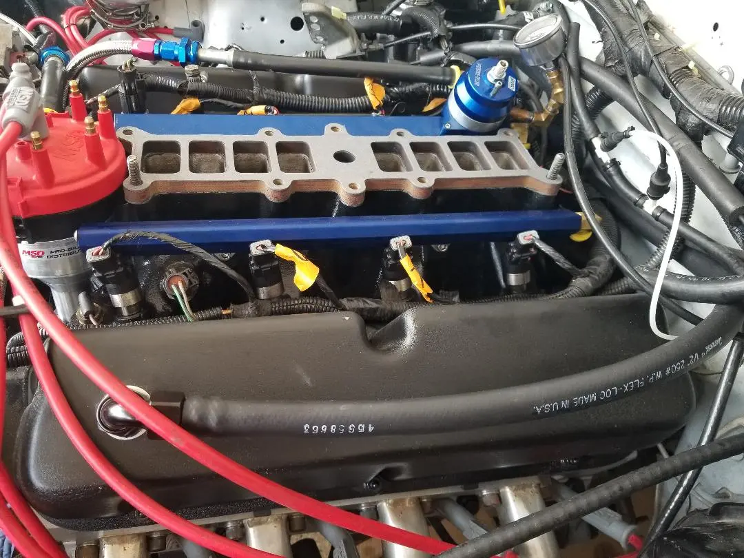

Well here we go again. Extended the fuel rail inlet out, and decided to keep my janky fuel pressure regulator design.
Stood back to admire my hour of work, and decided to throw the upper intake back on.....and ...

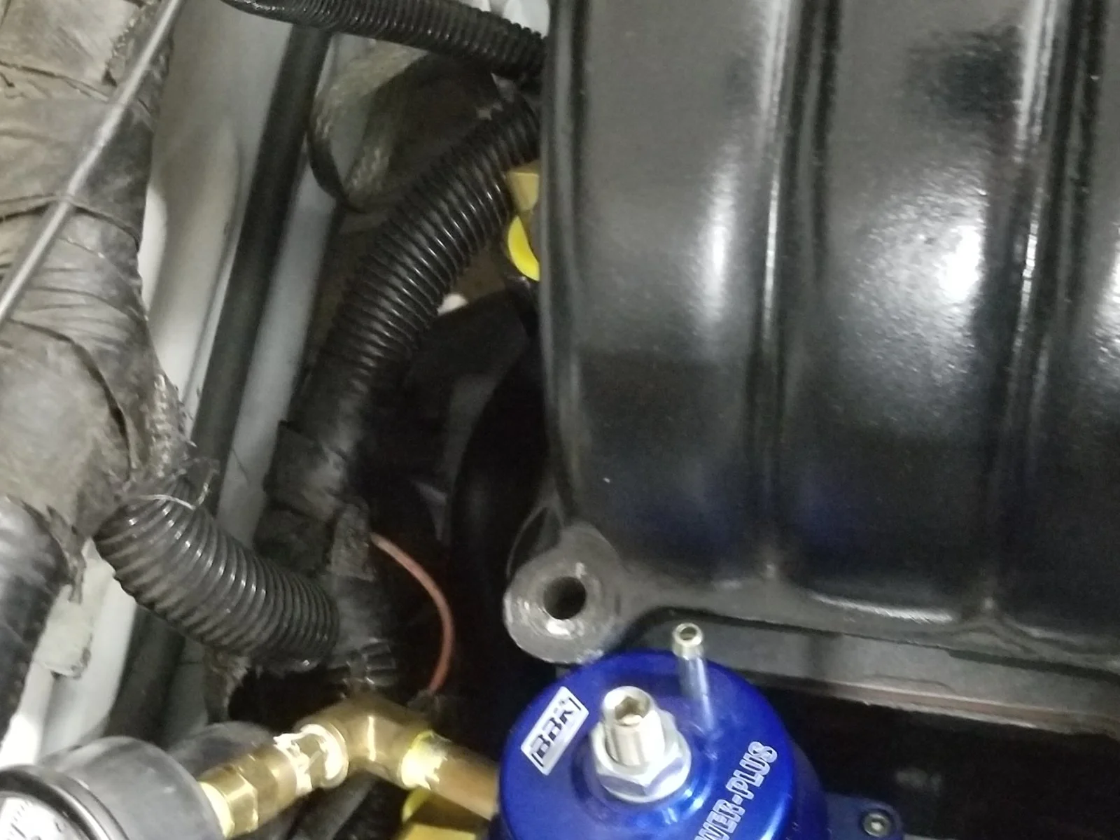

The tab contacts the pretty new fuel pressure regulator when you try to hang the other side on the stud. Anyone else have the same problem before? I really do not want to try taking material out of the intake, but the FPR is about 50% larger than the previous one. I can't say anything bad about BBK's stuff, but I'm regretting the move over.
So, I've got three options at this point.
1. Remove the regulator and remount it after setting the intake (but I'll have to remove it again once I go to pull the upper and re-check the valves)
2. Add the BBK FPR to my collection of unused, but new parts, while reusing my old no-name FPR.
3. Getting rid of the BBK rails/FPR and starting over again with Aeromotive pieces.
Hate to spend the money, but I'm truly debating on numero 3.

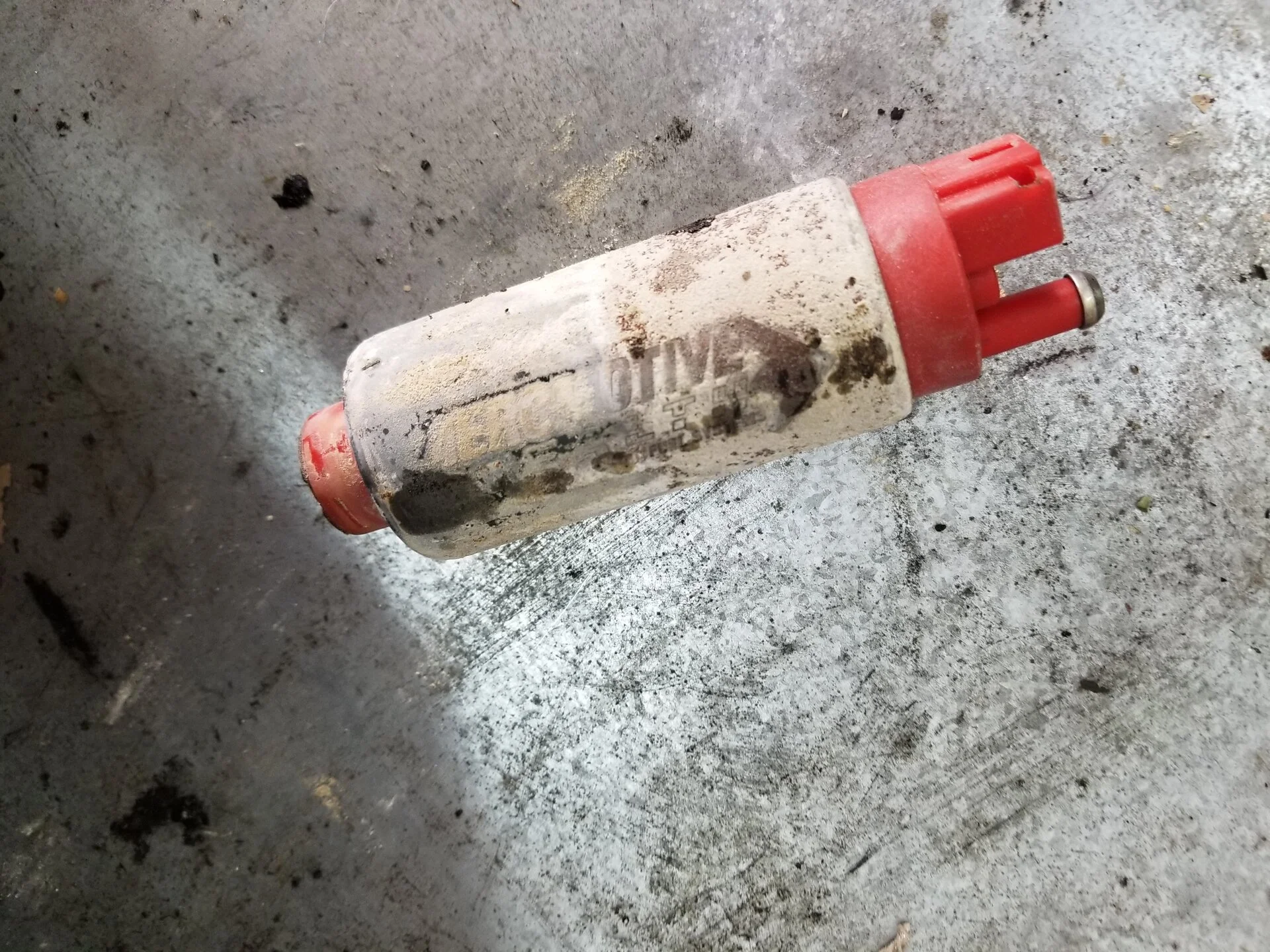

Well, guess I've taken a bit of time off. Got back at it the other day with the help of my Dad. We managed to get everything buttoned up and attempted to fire only to lack the sweet sound of the fuel pump building pressure. Now that pump, though 5 years old, is an aeromotive 340 pump with exactly zero miles on it. So my logical thought is that something in the chain prior to the pump is bad. Got to thank Jricker's checklist here. Managed to get all the way back to the inertia switch before finally admitting defeat to my Dad and resorting to (his initial thought) dropping the tank and checking the pump. Now the tank had been drained for storage, so there shouldn't be any problems right?

Agreed. I spent a day driving around getting a new tank and an Accel pump. Then had the joy to find everything installed worked, but the sealant at the fuel rails. It's been a couple of years, but I know I asked if the stuff was fuel safe. Guess not. We reset all the fittings and lines, went to fire again, and seemed to have no fuel still. A couple hours of testing showed seven dirty 42lb injectors and one which completely refused to do the one thing it was made for...open and close. Decided to give Summit $450 to ship some EV1 42lbs injectors "next day." only to find the term "next" to be negotiable in the time of COVID.

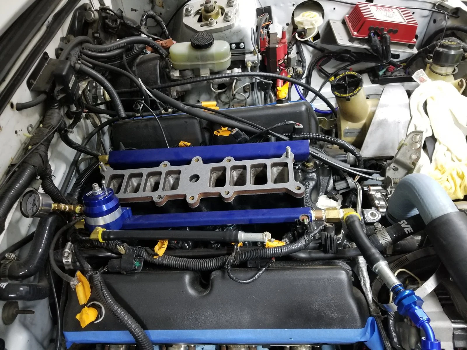

So I've got to give Summit credit, the Holley injectors came on time.
Popped them in after ensuring each fuel rail union had been cleaned and (now) properly sealed with fuel safe goo. Bolted the upper and all components in, set to TDC and number 1 on the distributor, and fired it up after about two rotations. Awesome....right. Shut it off to let it cool and put the 6al-2 back into the mix. Go to fire.....no start. Disconnect 6al-2, and plug directly to the coil....no start...…..WTH. So it's time for input from the masses. I appear to have fuel, spark, and tested the below.
-TFI is sending signal to the coil
-Coil is firing (might be the next choice for blind replacement)
-I have spark at the plugs
-When cranked, I can pull the plugs and confirm they are seeing fuel
-Cleaned and verified every ground connection from the rear mounted battery to the engine (batt- 0 cable - bulkhead - engine - firewall/engine)
-Key on test just gave me the evap (removed)
- Did notice my new MSD dist seemed awfully warm after running (higher temp than the block).
