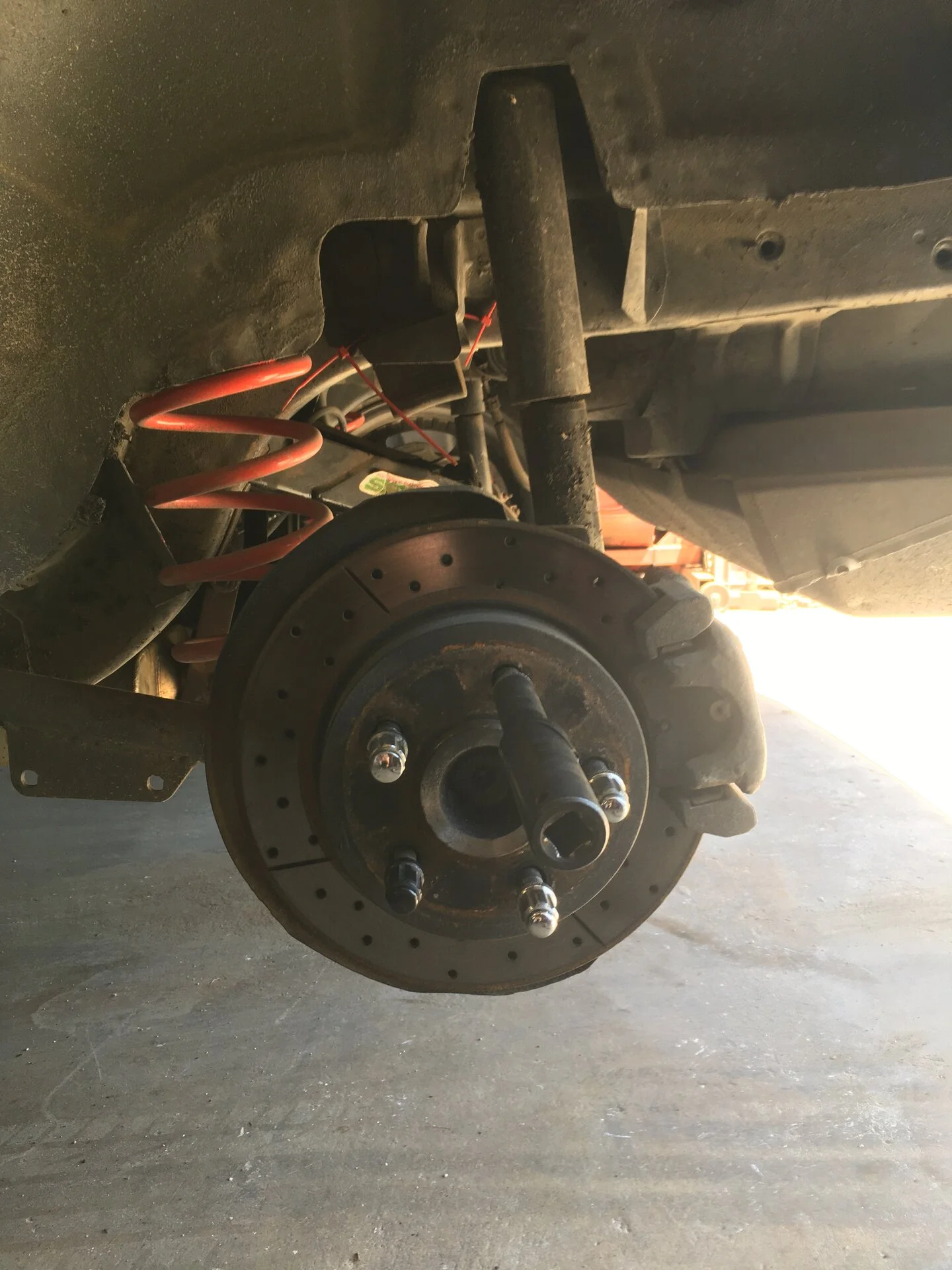

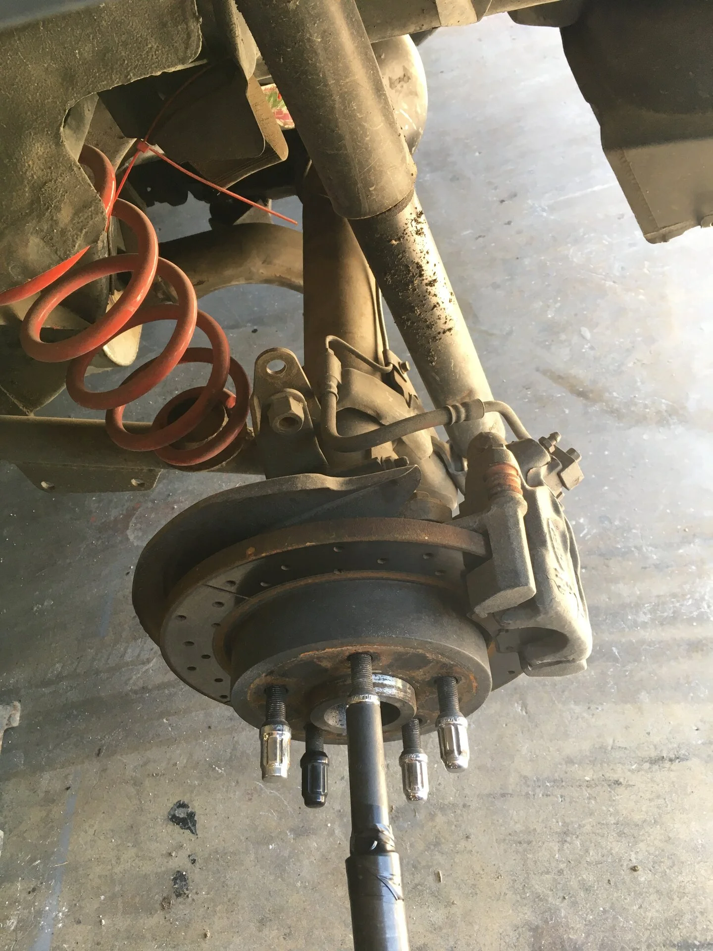

Just got my first car and I need help finding an E brake for it, it has disc brakes drilled and slotted and its 5 lug. What all do I need to finish the car I just bought?
Its sn95 spindles i dont know what elseFirst we need to know more about what parts were used for the swap, is it a sn95 housing or parts swapped to the fox 8.8.

While it is in the air, get one of the front end of the ebrake cable. The point where the 2 cables meet.Take a rear wheel off and get us a pic.
Lol that’s the thing there are no cables hereWhile it is in the air, get one of the front end of the ebrake cable. The point where the 2 cables meet.

Its got the stock handles but just nothing connected literally no cables its just a handleThe ‘86 emergency brake handle pulls a cable that is attached to the cables running to the rear wheels. Obviously you don’t have the cables going to the wheels, and it sounds like you don’t have the brake handle. Do you have the ratchet assembly and front cable? Check Craig’s List or FB Marketplace for someone parting out an ‘86 or earlier for those parts. I’m not familiar with the SN95 rear discs, so someone else will have to respond to what cables and brackets are needed there.
Alright I used that thread and another I think I know what I need thisYou'll have to id the set up you have, go here through this thread, you may find the answer.
Brakes - The Ultimate 4-lug/5-lug Brake Conversion/upgrade Thread

im very upsetIts got the stock handles but just nothing connected literally no cables its just a handle
