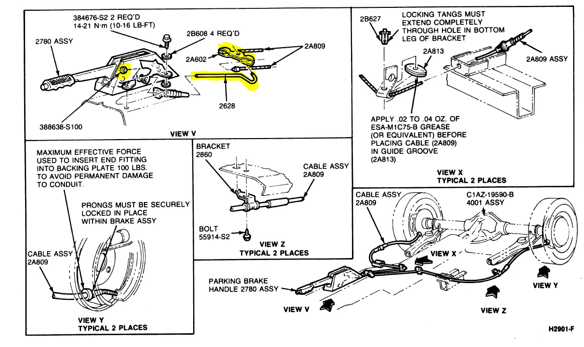

The diagram I posted was out of an ‘86 Ford shop manual.
I think this is probably an intimidating project for someone new (and young) to take on, even though many/most of us have been through it and realize it really isn’t that difficult.

I realize you have a different hookup at the caliper with the 5lug, but here is a baseline of what you should have been starting with on an ‘86.

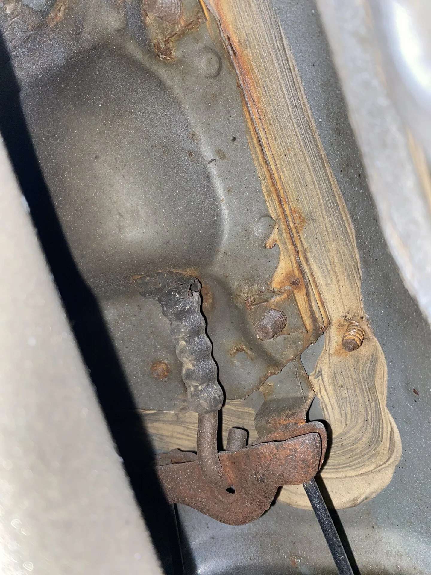

The threaded rod connects to cable underneath, and is your adjustment mechanism:
This is underneath, where the threaded rod on the interior, and the hook underneath connect to the “equalizer” which has the cables connected to it

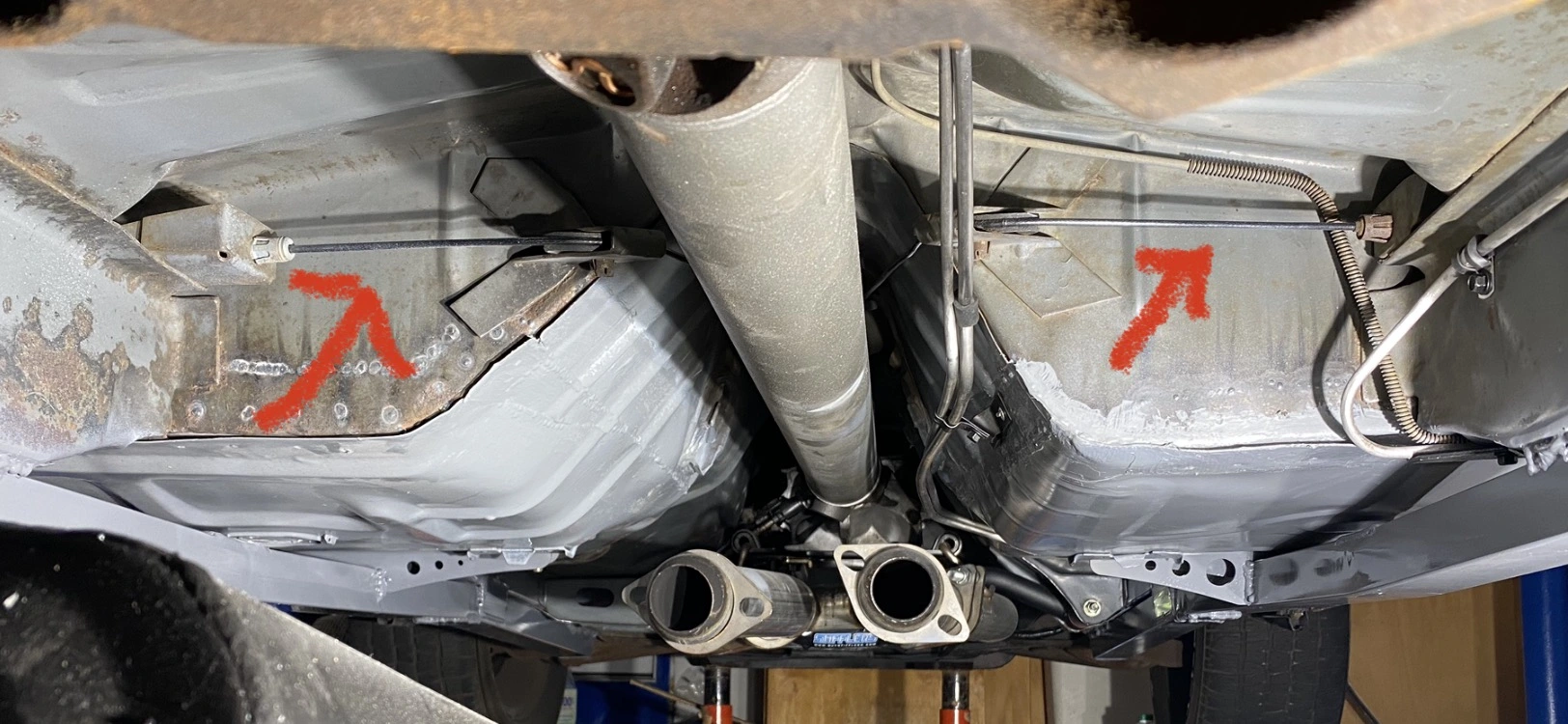

Here are the cables coming from the equalizer to the pulleys and toward the outboard sides of the car. (Open and zoom in for better detail)

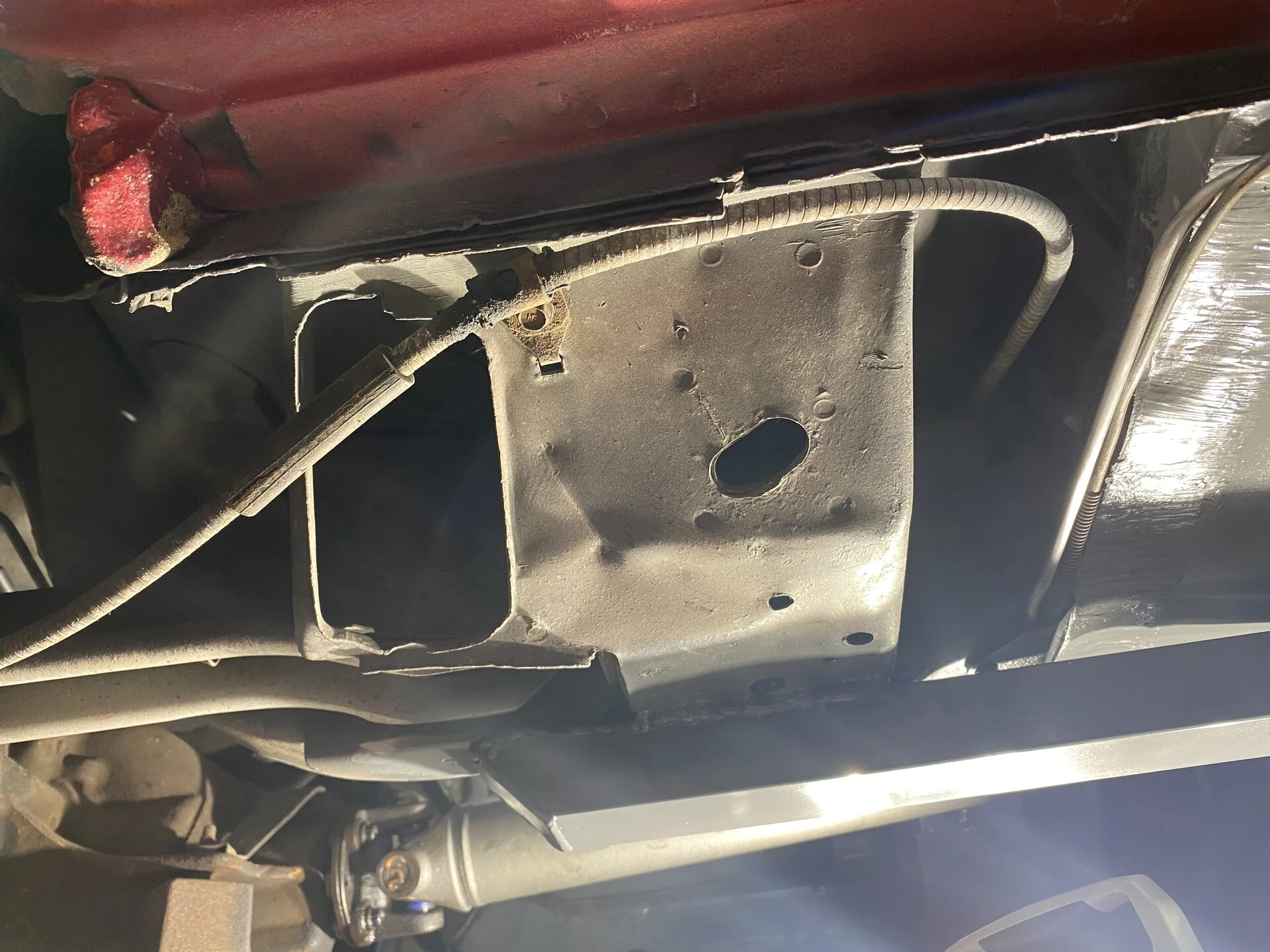

It continues out and circles under the torque box and connects to the brake.
I don’t know if these pics will help you figure out what you have or don’t have, but hopefully it’s a start. I believe with the ‘86 you would just need to change the two cables to ones with proper ends to connect to the disc brakes as opposed to the rollers.
If your other hardware is missing (rod/hook, equalizer, pulleys, etc) it may be more of a parts search for sure.

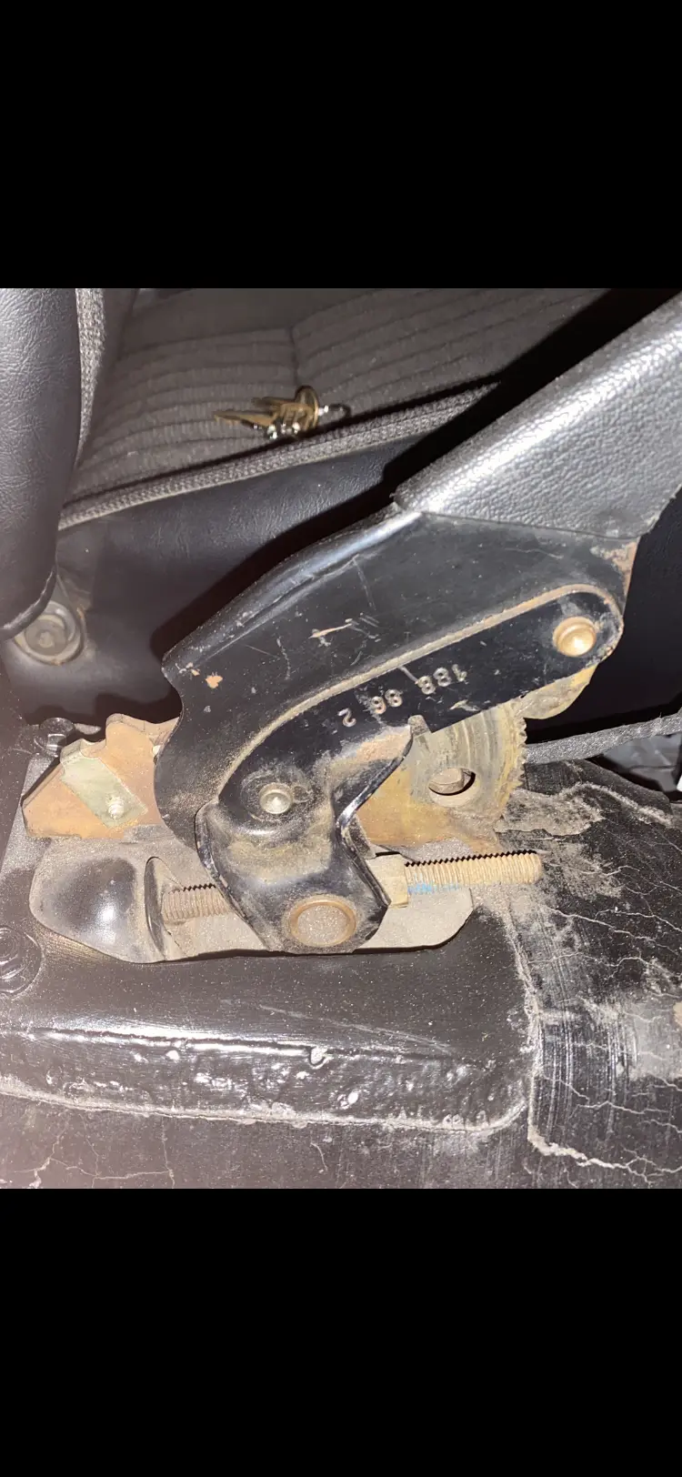

From what I can tell it has absolutely nothing connected to the handle itself. I will double check but pulling up the E brake is very easy like its just bolted on I believe so from what I can tell I need an 86 center cable with an equalizer bar. And then the 2 cables from LMR for the rear. You reckon that will work?
Have you been underneath to see what is there, as far as the threaded rod/ hook and the equalizer? Or are you just assuming they are missing?

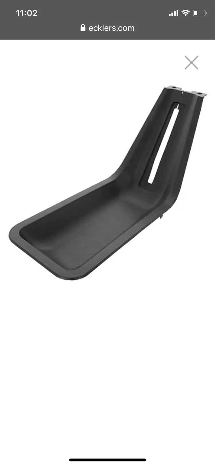

You may also be able to get this part of your console off (two screws and some tabs that snap in) and get a look to see if the rod is connected. Be gentle with the tabs, they like to snap...... if you decide to remove this piece.

pulling that piece off would just give you a quick look at the ratchet mechanism from up top, without removing the entire console..... just to see what you have.

But you said your handle is there...why would you have to fab it? The diagram I sent is for an '86, so anything shown there should work, but Rdub6's pictures are an even better reference. Removing the plastic tray is easy to do, only requiring the removal of two screws to get a look at the base of the handle to see if the rod and mechanism are there.
