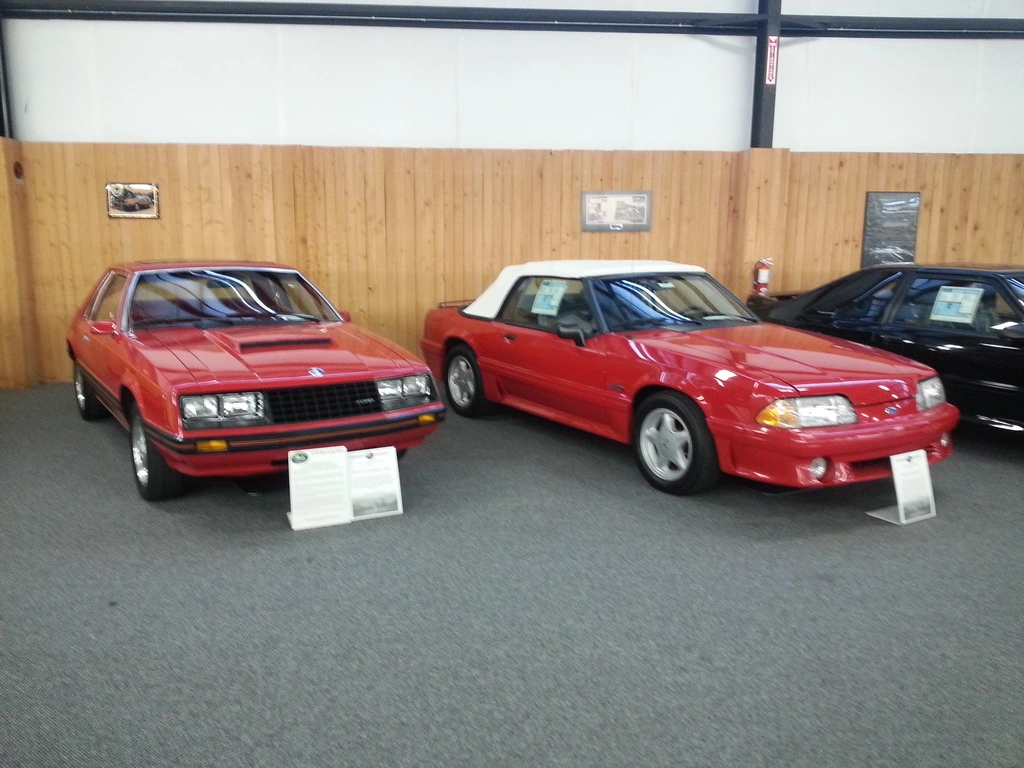

LMR is very fox focused and does a great job. NPD is still the gold standard. They don't play games with pricing and have customer service second to none. I struck up a conversation with Rick, the owner on a classic Mustang site and he offered a tour of his collection. He has over 200 fully restored cars. The crown jewel of my trip was a picture of the first and last fox body to roll off the line. Sadly, it was a casualty of a bad hard drive or I'd share it here.
Found it! It came out a tad blurry.
