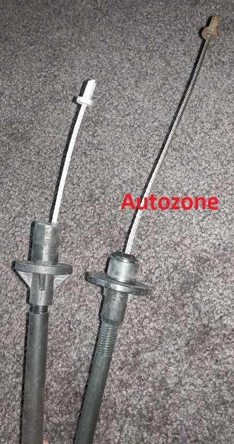

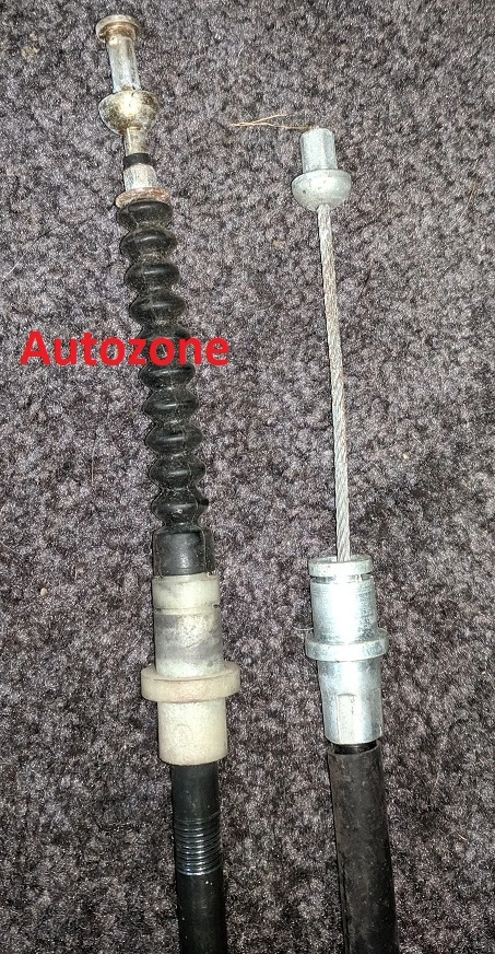

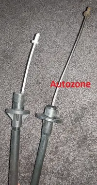

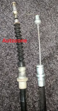

I fully expected to have a problem with them but never did so put them in my other cars and still no issues.. Here's one compared with the mm cable I've had on the shelf for along time. Autozone is the thinner of the two cables of course
