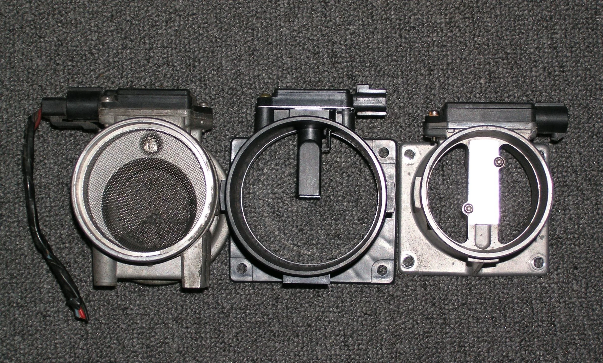

The stock one looks like the one on the left in this picture. Looking down the throat you see it neck down. In addition, the stock ones have bosses on their underside where they bolt to a bracket on the fender well. the 70mm's for upgrade are just suspended in the air tubing and dont bolt to the bracket. Also you can take the numbers off the actual MAF sensor to identify.
thank you....just by your pic...I believe I have the stock MAF...I'm not going outside to pop the hood...lol....what should I do..get a new one?
