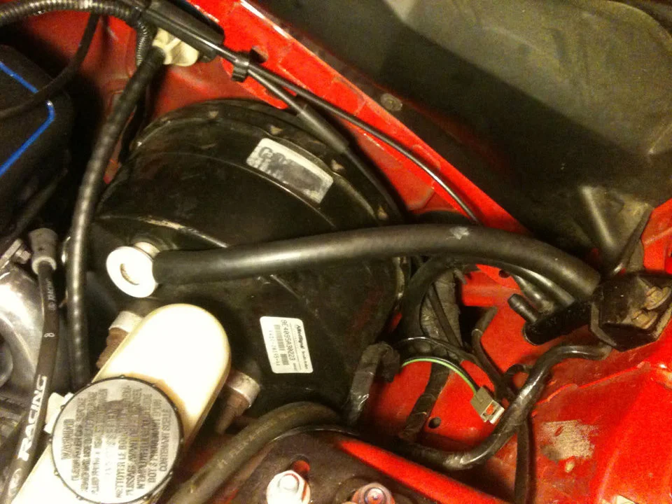

fixed the cooling system after burping it. Stays between 200-210 now. Checked the line going from the booster to the Tree and it is fine, no cuts or cracks. So what are my other options, is a stuck caliper possible or is it pointing more towards the booster? I took the line off while it was running and the hard pedal pressure was the same with it connected or disconnected. This is how it looks let me know if anything seems amiss.
Dude... there's no line running from the intake to the tree (should be that big one on the bottom) so NONE of the stuff on the tree is getting vacuum!
I bet you only get heater air out of the dash too. :D
oh I know what I did. That line is now connected to the valve cover for the PCV.
so now I have no line to go to the tree. So what should I do? Should I get a T fitting for the back of the intake so that I can have a connection for the PCV valve and one for the tree?
No... the line going to the tree should go to the intake and nothing else. The booster takes a pretty good amount of volume. The line to the PCV should go to the tree that's under the intake (upper plenum).

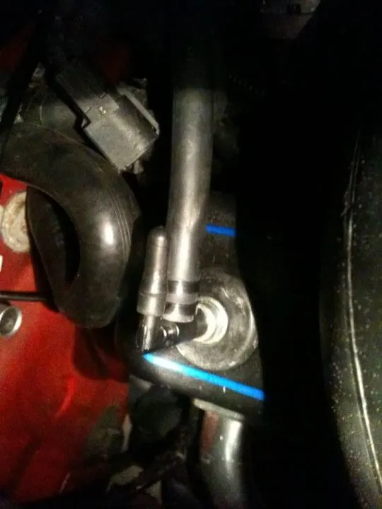

I have 3 ports in the back of my intake for the brass fittings. 1 Big one for the vac line to the tree and 2 smaller one. One of them goes to the FPR and the other one is capped off. If I get another small brass fitting like the FPR connects to and use the upper tree on the PCV valve (smaller one) can I connect that to the open fitting that is not being used and just run a longer line from the intake to tree for the vac (b/c now it is to short b/c it was cut)
If it's coming directly off the intake, then that should work great. Both the PCV and the port running to the tree linking the brake booster, pull the largest air volumes. If they're coming right from the intake then you have the best chance of avoiding weirdness with the vac system.
The reason the pedal is so hard is because the booster isn't getting enough vacuum. Noobz is correct, you seem to be missing a line that makes lots of vacuum for the booster which is exactly why the pedal is hard. I should know because after I got my 347 running I took it down the street after I bled the brakes and the pedal was so hard I couldn't stop. Come to find out that big hose (your picture above) was burned by my long tube headers, my vacuum line was long and I tucked it under to hide.
