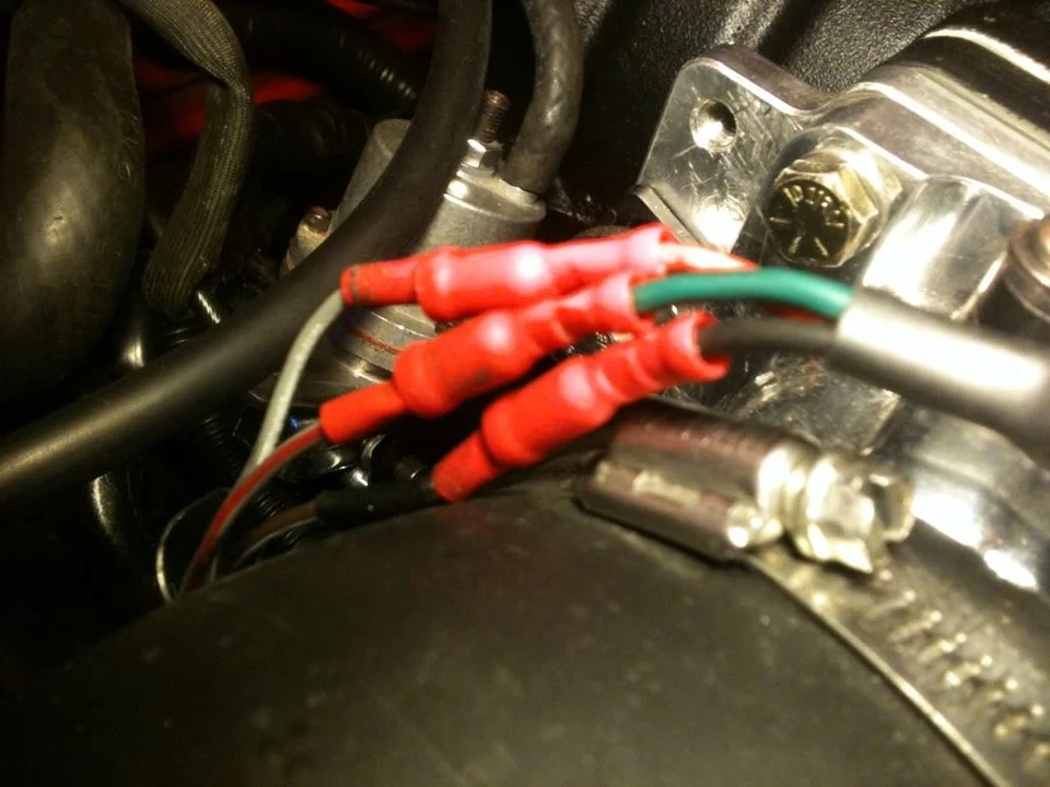

Not sure if it was due to the exhaust leak or no tune on the car yet but it felt very dogish like to the point that my STI would kick the snot out of it lol. I only took it up to 4,000 RPM's but I could tell it was seriously lacking power. When I had the upper intake off the wires for the TPS sensor came disconnected ( the 3 wires ) they are held together with a butt connector b/c of the fox TB swap. I was not sure which was was the correct way to connect them but it seemed to idle fine. Also just noticed that the upper radiator hose has a grove in it from hitting the alt pully, need to find a way to get that upper hose out of the way. I already cut it shorter to move it further away from the pulley but looks like more needs to be done.
Are these wires connected correctly?

Thanks Andy, I took it out this afternoon after swapping a few of the wires but they were still not right. I did it by the way you listed and it idle's like it did when it first started up and has more power then it did before, even though it still feels lack luster but I think its running pig rich and it needs a tune.

Have you looked at a plug to see whats what? you could be lean and might need to add fuel? You recheck the timing after its up to temp? I run my 331 of the stock puter and it runs the balls pretty much. I wouldnt think you'd be that far off.... it shouldnt be running that bad. I'd check the above and see if it responds. You verify the voltage at the TPS to see where it is?

The car runs great with the TPS wires connected correctly. Its still going off the old tune that was burned with the AFR heads and TFSR intake. Only thing that is still the same is the cam. I'll check a plug and see what it looks like. I did not check the voltage on the TPS, a multimeter is one of the few things I dont have.

I wouldn't worry about that portion too much other than to ensure that the wires are correct. TPS votage is referenced on startup and the EEC scales accordingly so long as voltage is anywhere in the reference range.
well I know how it ran/idled before the wires were undone and the differance that it made when they were not connected correctly. It now idles and runs as though it did before they got mixed up.

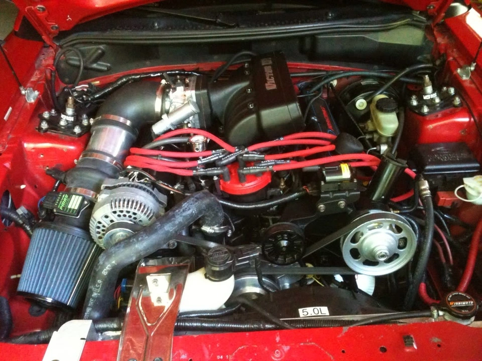

Got the livewires on today after they were on back order forever! Had to have summit call DUI and have them send the stupid things out to me. Anyway the engine mods are complete. Found a few loose spark plugs when doing the wires, prob had a lot to do with why it was kinda lacking some power. Tightened those back up and took it for another drive, everything seemed good (except for the small seeping coolant leak from the thermo housing which I'll have the dyno shop fix, Im doing doing stuff to it for awhile now) and did a nice little lighting up of the tires in first gear :) Been along time since I have been able to do that, the STI is not to good at burn outs lol. Also fixed the brake pad dragging on the caliper issue. No rubbing now and it brakes really well again.
