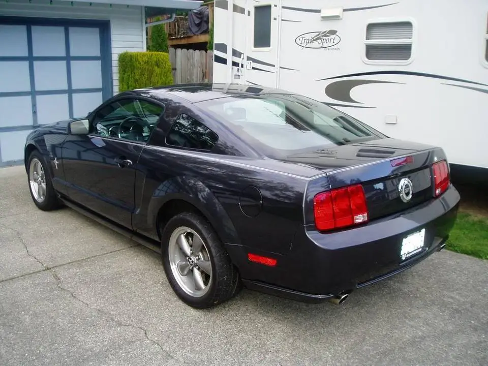

You need traction (don't we all!!!). He was my cheap solution for track days...
I bought a set of four (4) charcoal 17*8 Bullitt wheels (with nearly new tires) from a friend for $250 (he bought some 20" chrome wheels and didn't need his factory wheels/tires off his 06 Mustang any longer).
I kept the factory 17" Pirelli's on the front pair, and mounted a pair of 275/40/17 BFG Drag Radials on the back pair. With 18 psi, these drag radials hook up perfectly - even in my low-12 second ride (07 GT automatic with Vortech supercharger, 4800 rpm stall converter, and 4.10 gears). Here's what my setup looks like on my GT...
With traction and your mods, I don't see any reason why you can't run low 13's. Go to a low elevation track with awesome, cool weather and your GT might even post a 12.90 in the 1/4 mile!
