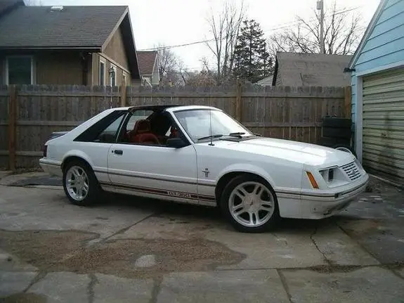

ok, i know what wheel your talking about as far as the ford 4 lug cobra r and they do make these now.
Ford Racing Performance Parts - [Part Details]
if you take a look closer these are made in a 17x8 wheel not the normal 17x9s that are the 5 lugs. heres a pic of my 84 with 96 gt wheels which are also 17x8s. you should be able to run these with a 245/45/17 on the front and with the rear quad shocks flipped be able to put a 275/40/17 on the rear. alot of people will argue the 275s on a 8" wheel but i have done this on numerous cars ive had and had no problems. sorry the quick anwser is yes,they will work.
you can run as wide as a 10.5 wide on the rear if you wanted(with out the quad shocks) the fronts will be good with the 17x8s. the front end you have now is the same as the 87-93 4 cyl fronts. the 5.0s from those years have the 11" rotors as opposed to the 10" that you have. youll be fine with 17x8s on the fronts and 17x9s on the rears.
