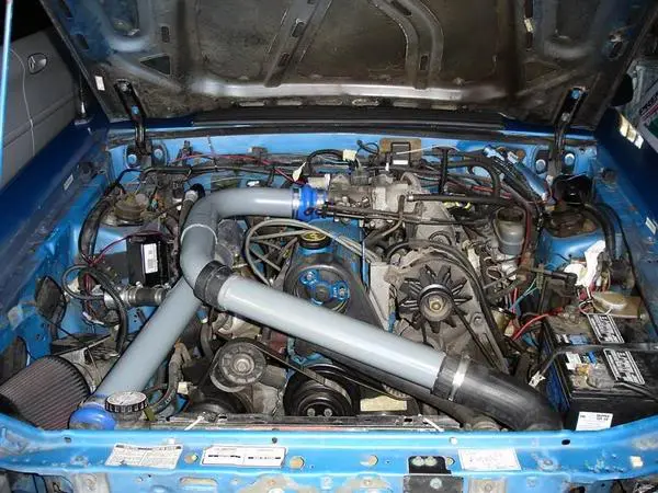

My Volvo IC is basically held in by the radiator, there isn't much in the way of mounting flanges on it if i remember right. but You see how i did the piping in the Picture. I have run about 17psi for about 4 years now and so far i haven't had any trouble with the plastic tanks on the volvo.

Man that looks good. great job on the install. what pipe did you use and size? also where did you get your couplers and what sizes were they u used and i see a rubber 90 hose going out intercooler by radiator on driver side. any part numbers or part look ups would be great. also what radiator did you end up using? did you see any performance gain in the swap over the standard throttle body intercooler? looks awsome though hope you can help me out getting mine to look like that

The couplers i got from Turbohoses.com The pipes themselves are 2.5" mandrel Bent steel pipe. The rubber hoses i would have to look back in my notes. I think i do have part numbers somewhere. As for the radiator, I used a single core 89 ranger radiator, but I wouldn't advise it, in the hottest days of summer it runs a little warmer then i would like. I will see if i can locate some part numbers for you.
