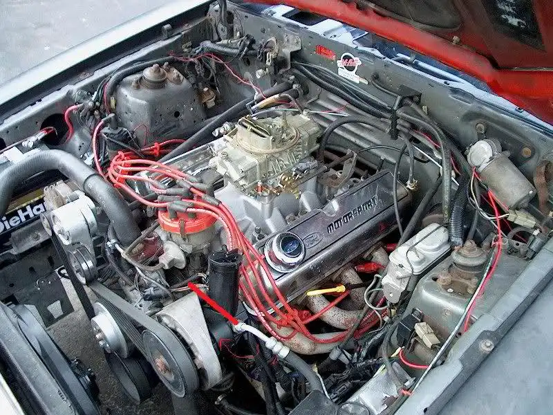

Autozone stock replacement line. :shrug:
I'm not sure i understand the question. Are you having problems with the brackets or the line?
THX

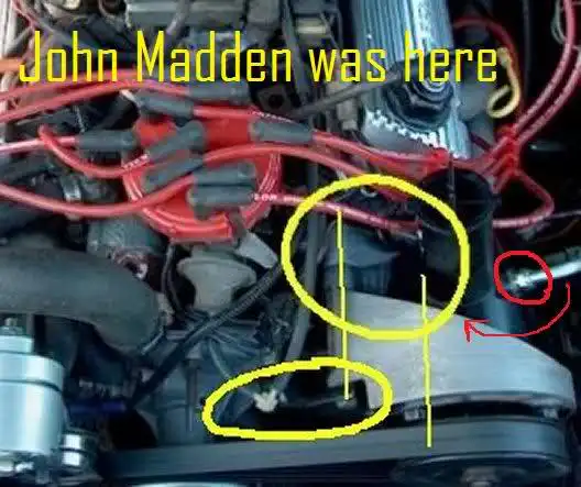

Thanks for the pic. Yours is pointed down, mine is pointed upward when the pump is rotated as in your pic.
My line is directed between the fill neck and the housing on the power steering pump. It's pointed straight up, I can't rotate it to the left or it hits the housing, to the right, it hits the fill neck. I can't bolt it up as is because the line is doubled back against the pulley and not long enough.

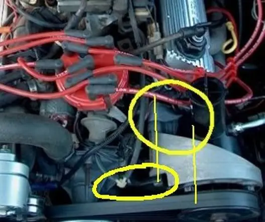

Are you cool with how the brackets bolt on? I got a pic of that too (sorta):
Look at that thick part between the head and pump as a reference on how to position the aluminum piece. Once you have that on right the metal piece only goes on one way. The straight lines represent the bolts.
yep
Yep, the brackets are pretty straight forward. Those are great pics though.

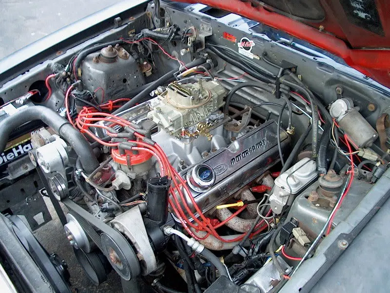

i just slightly loosened and rotated mine when i did the relocate, no problems in almost a year, and it never leaked a drop when i did it, so i think you should be fine
edit: don't know if this helps, but here is a pic showing how mine sits....
