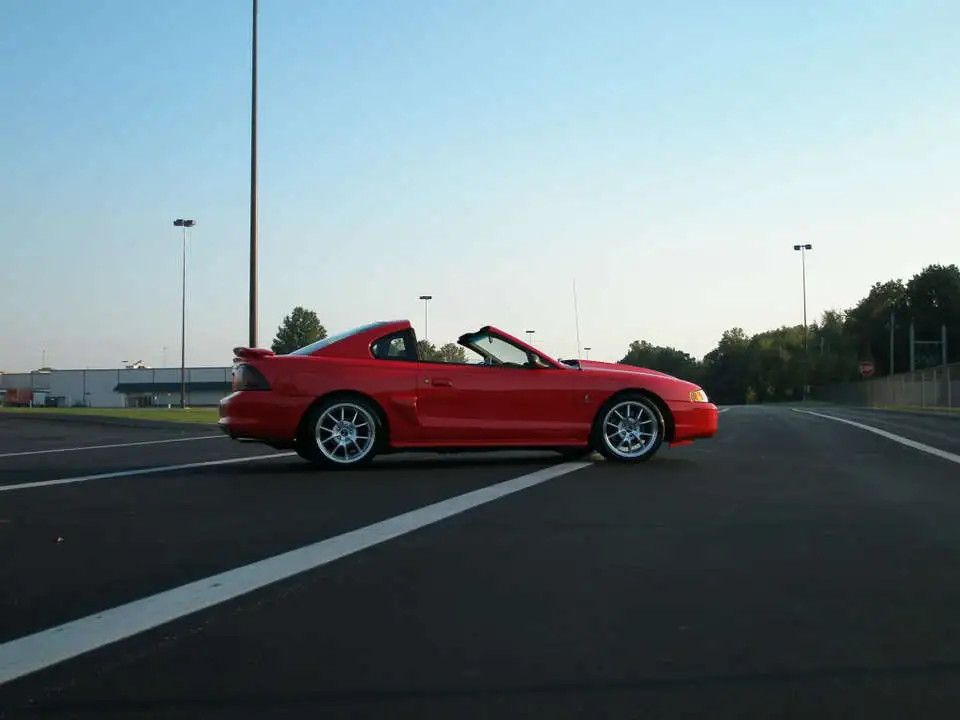

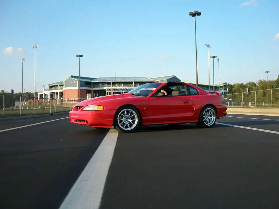

For all the people wondering about targa tops....
Actually I did a long time ago...these are old; pre X2 stance/tint, but you get the jist:
This has been a LOOONG time coming ;)
