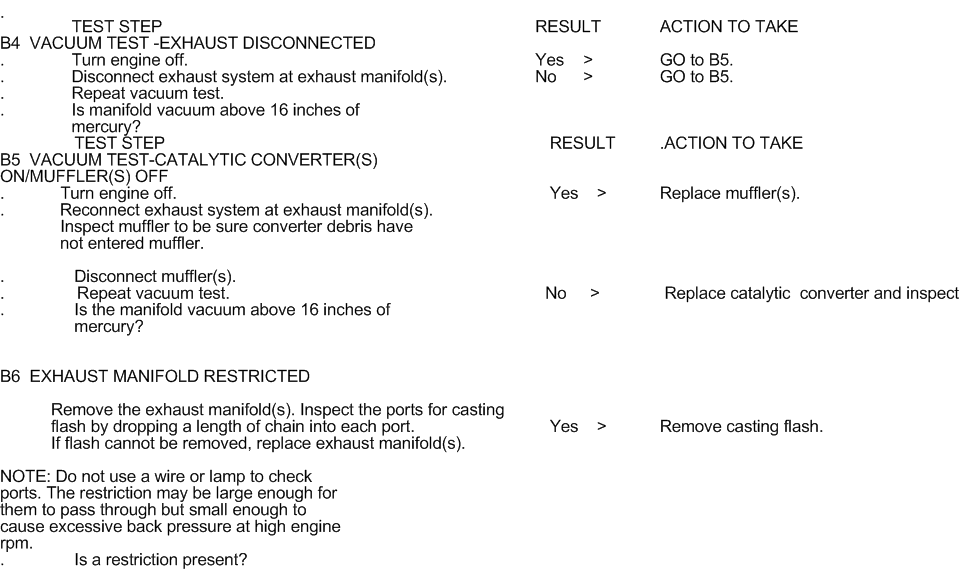

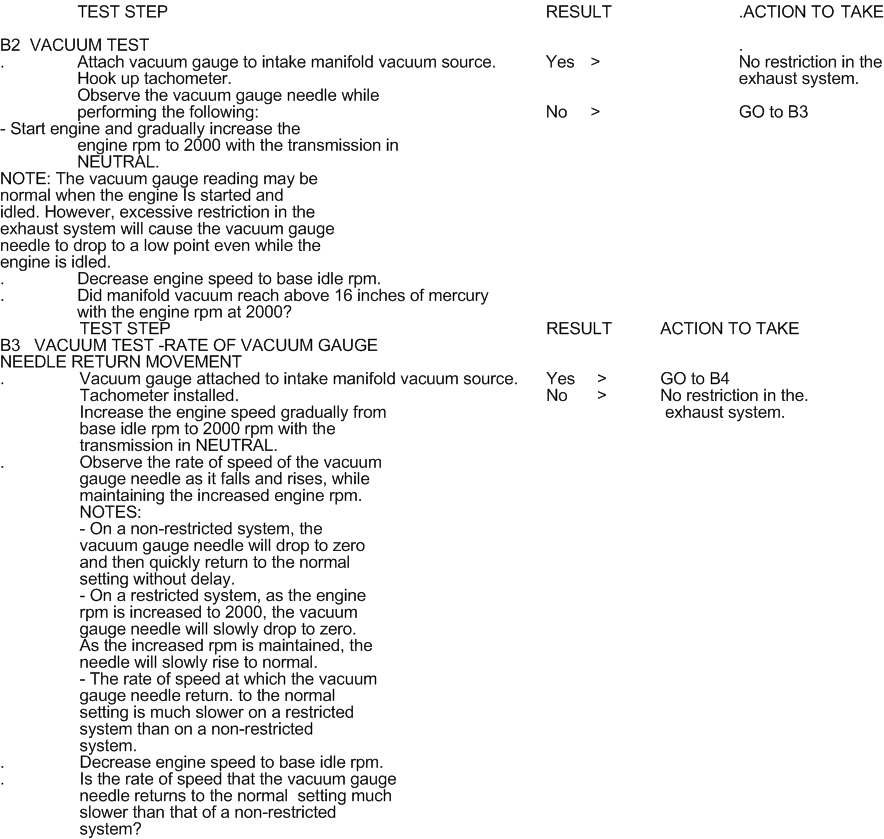

How to tell if the cats are clogged - the best thing is to buy a Chilton's Mustang 1989-1992 repair manual and read the complete proceedure. It's on page 4-22 & 4-23 in the Emission Controls section in the manual I have.
Attach the vacuum gauge to the vacuum tree on the diriver' side firewall. There are some spare connectios to make it easy to do.
