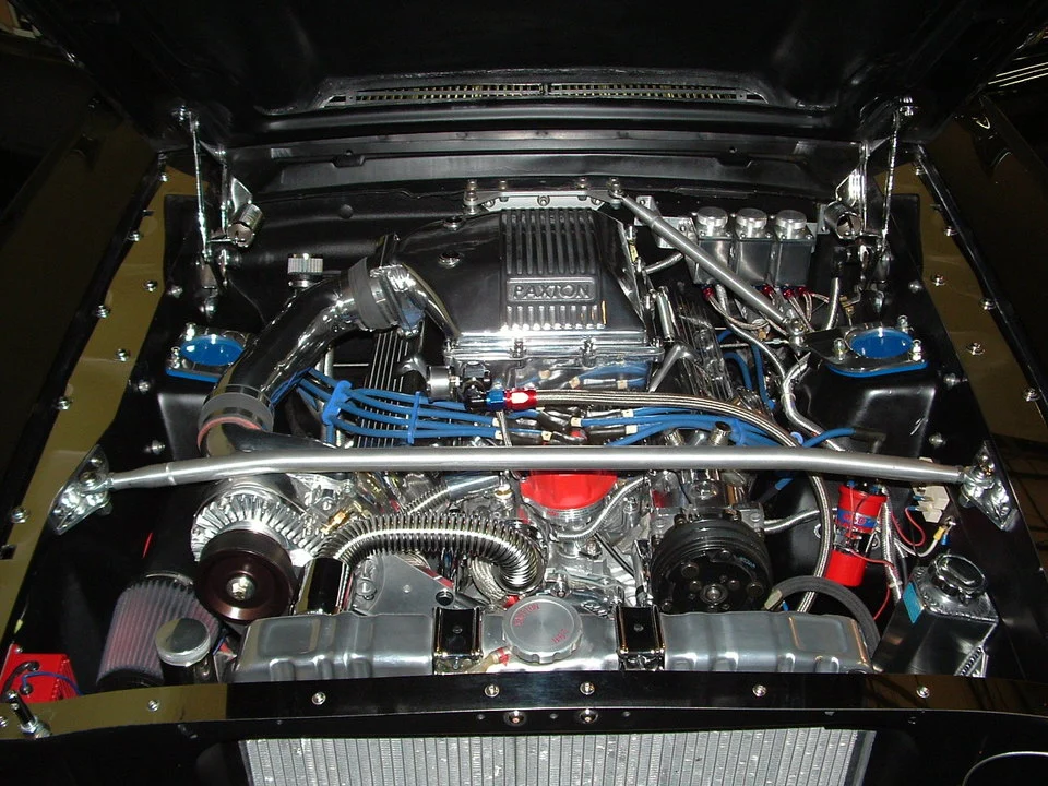

I'm running a Howe Racing radiator (2 core aluminum) with my 351W. I'm using a 165 thermostat. Even with the cooler thermostat, I was seeing the following temps:
Highway: 170
Around Town: 190-210
Stop and Go: 210-225
Stop and Go with A/C: Fortget about it!!
I knew based on the above that it was all a matter of airflow through the radiator to wash the heat. I bolted on a 1/2 (3") shroud from Summit. It's flexible so you can kind of put it wherever you want. This took about 30 minutes.
Result: I can't get the water hotter than 190 at idle without air. With air, it tops out at about 205 even sitting in traffic.
What a difference! 6 blade fan, oversized aluminum radiator and shroud will solve anyone's cooling problems!
