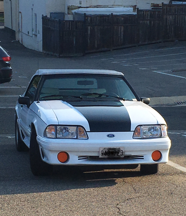

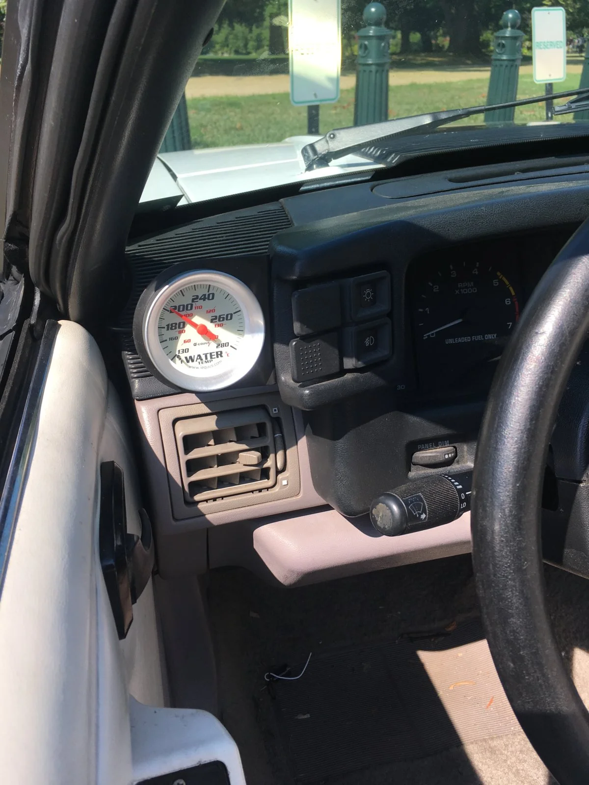

91 GT vert - auto - 327 gears , clean engine with stock fan shroud and stock lower radiator air deflector, new heavy duty fan clutch , new 192 thermostat ( not drilled ) new rad cap , 50/50 blend coolant , stock overflow tank , newer stock size radiator , older water pump - using a mechanical water temp gauge hooked into temp sender intake manifold port . During Ambient air temps around 97 degrees w/ 50% humidity . Car runs about 200-210 in stop and go traffic . Runs 220-225 on highway cruising . Held 185 degrees for 30 minutes today thru traffic - today’s temps are 75 degrees - should be 80 degrees this evening on highway trip home ( will know later how those car temps are ) I heard the cars computer prefers minimum 195 to run best ? Question I have is it unusual and unsafe to be at 225 when outside air is mid 90s with higher humidity ? How come highway cruise is higher temps then city ? Thanks for input

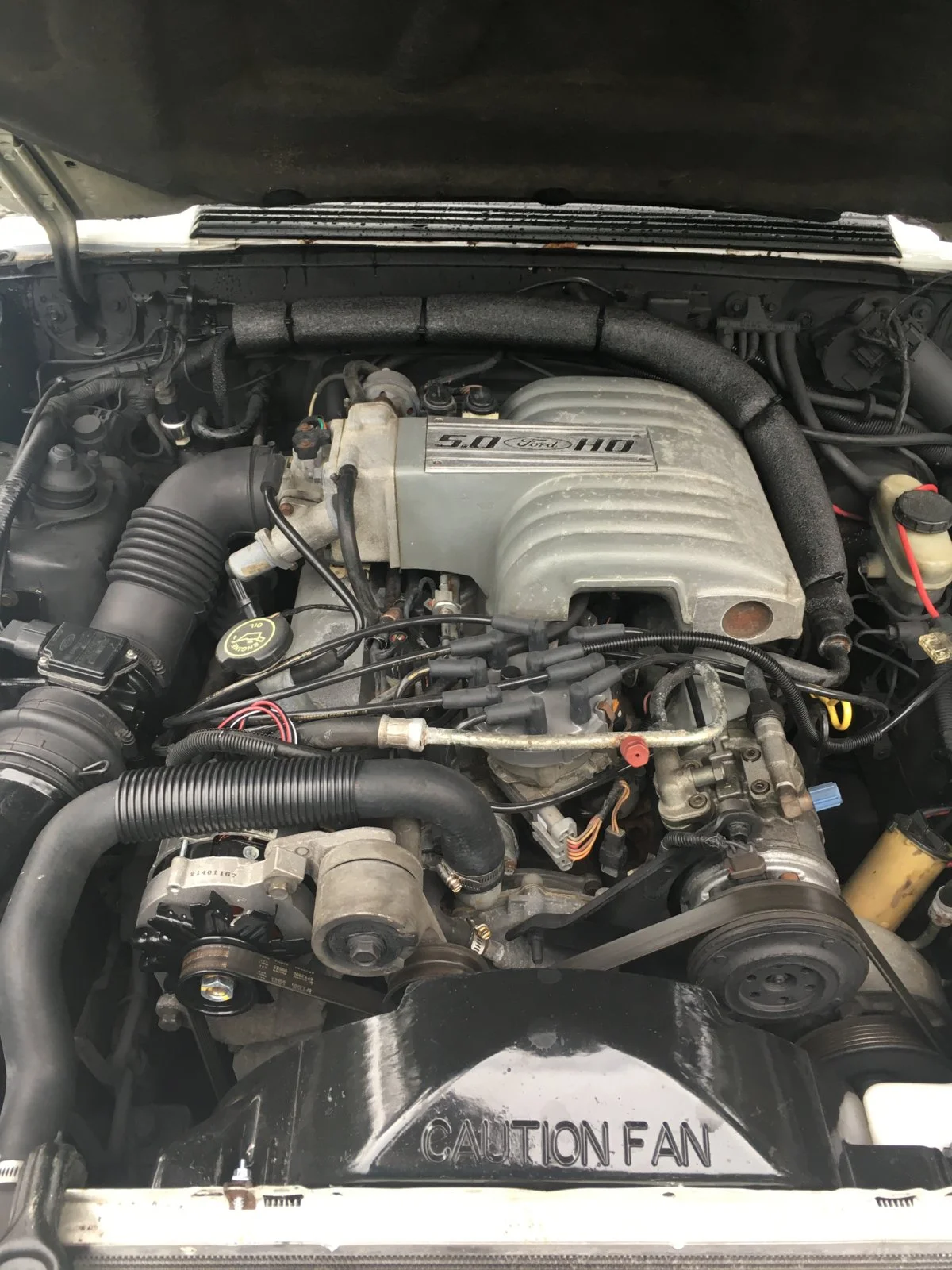

I did the burp procedure and added some foam weather stripping to close a gap around edge of fan shroud where it contacts the radiator - there was a 1/2 “ open because my fan shroud mounting - I figure this will force the fan to draw more air through radiator instead of through gap around it
I have changed coolant , but not force flushed - when I burped it last night and level dropped when thermostat opened , the flow appeared strong . Cruised in to work steady 182-188 degrees , 30 min drive in traffic . Ambient 70 degrees - keep in mind , I got stock iron heads and 192 thermostat .
