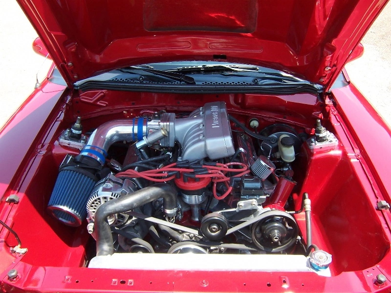

Mike's car is freakin sweet. How did you hide all the wires so well?

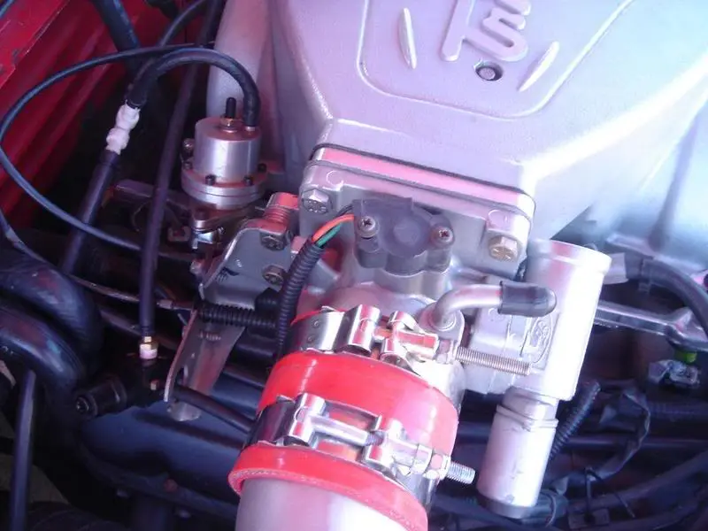

I think he's talking about using washers on just the throttle bracket bolts. I wish I would have thought of that when I did mine, it's a pretty tight fit. The part on the bottom of the tb that opens the throttle was hitting the fuel rails on mine, so I needed two spacers anyways.
I occasionally have to run wire at work so I've learned a thing or two about hiding wires. ;) I do still have a bit of a mess by the firewall, but it's not too bad. Oink ran his wires inside the car and cut a hole in the transmission tunnel so they would come out directly behind the engine. :hail2: That's a bit more work than I was willing to do with mine...
When I had a Victor Jr. intake on my 347 I had enough clearance to go without a spacer at all. I'm not sure what intake you have but maybe it would be easier to just get a plenum spacer like mine had. :shrug: Dunno if you have the hood clearance though (I didn't, but I slammed the hood and made it fit!! :nice: )
