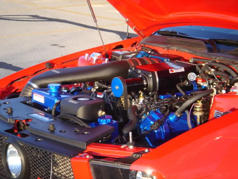

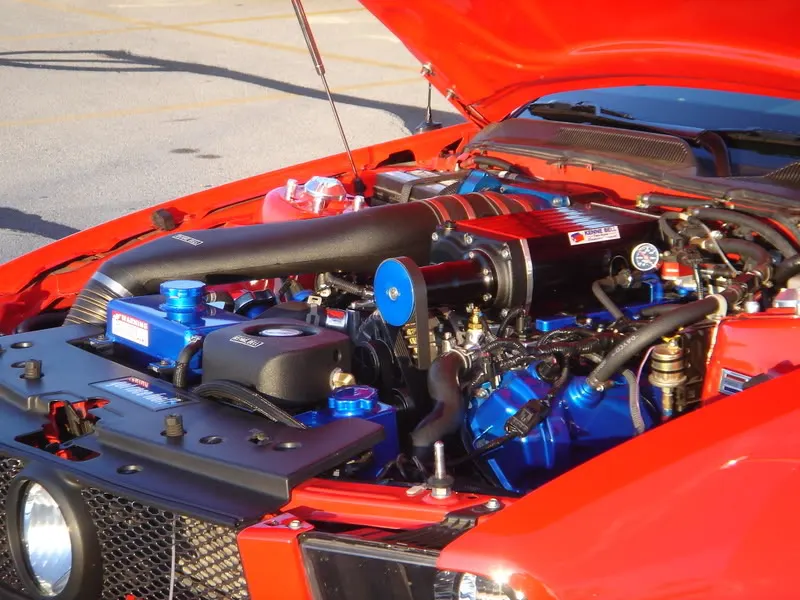

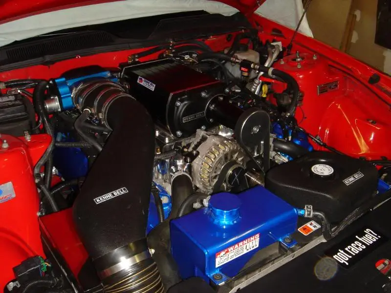

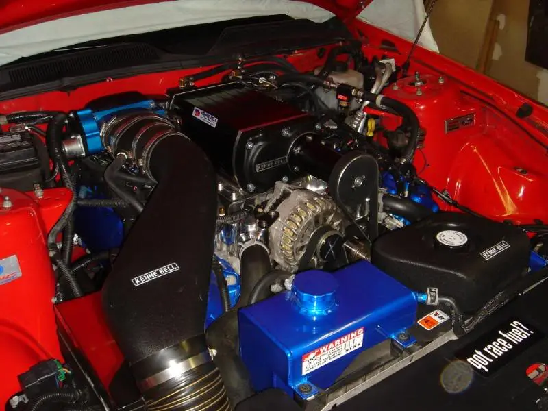

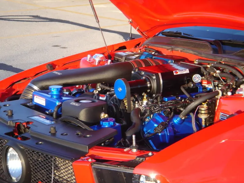

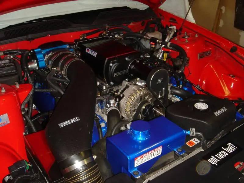

I loved the nostalgic look and sound of the Whipple. Below is vid of mine on the dyno. The whoop (rather than whine) is very cool (IMHO) but gets expensive - you want to hear it all the time. :nice:
